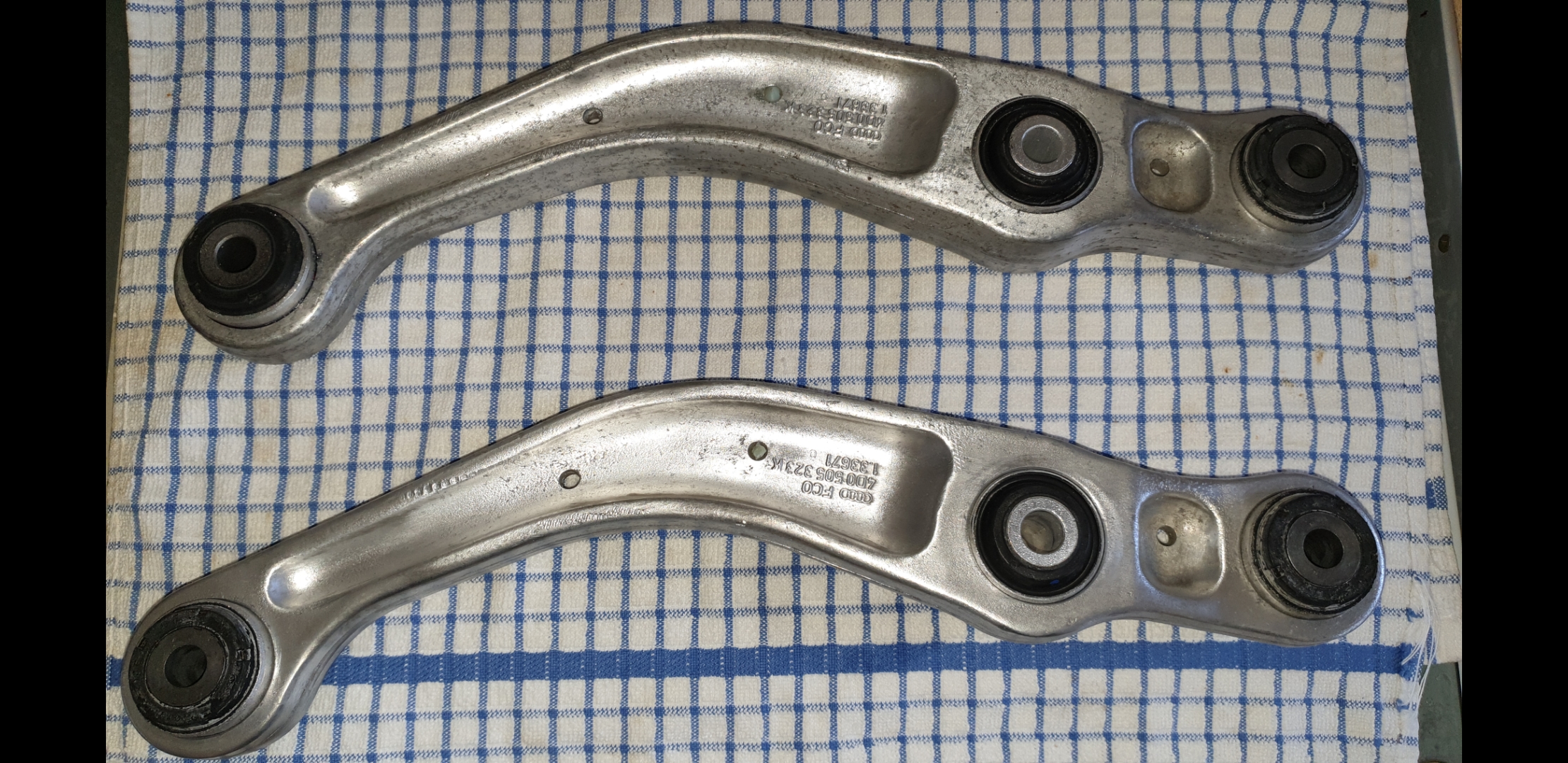

Sorted
Got rid of the press, used a combination of the vice and the vag tool. All went together easily with no drama at all.
I don't think my press is pushing squarely. It's only a cheap thing.
