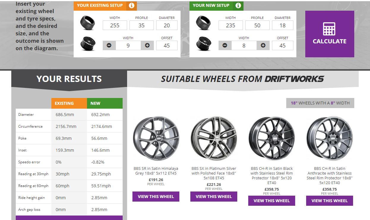

Old 5th October 2019, 03:42 PM
Very little, I had to guess wheel width and offset but that would not make any difference to speedo reading https://www.willtheyfit.com/
Originally Posted by Mossyboy1978 View Post
Will this change make a difference to the speedo calibration?
About 2%, but given most speedos exaggerate speed anyway, it's unlikely to be a problem.
Basically at 70mph on your speedo you'll in theory be doing 71.5.
