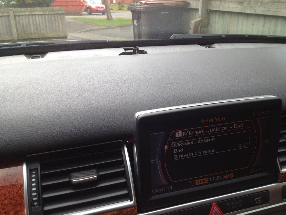

The Center dash speaker lives under here. There is one for Bose too.

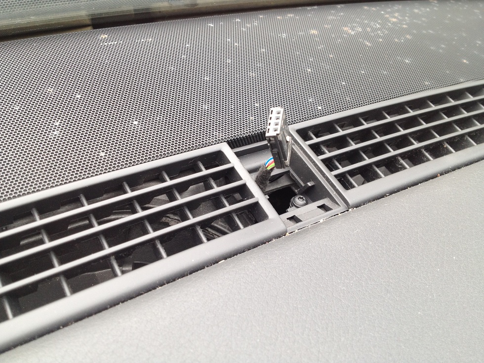

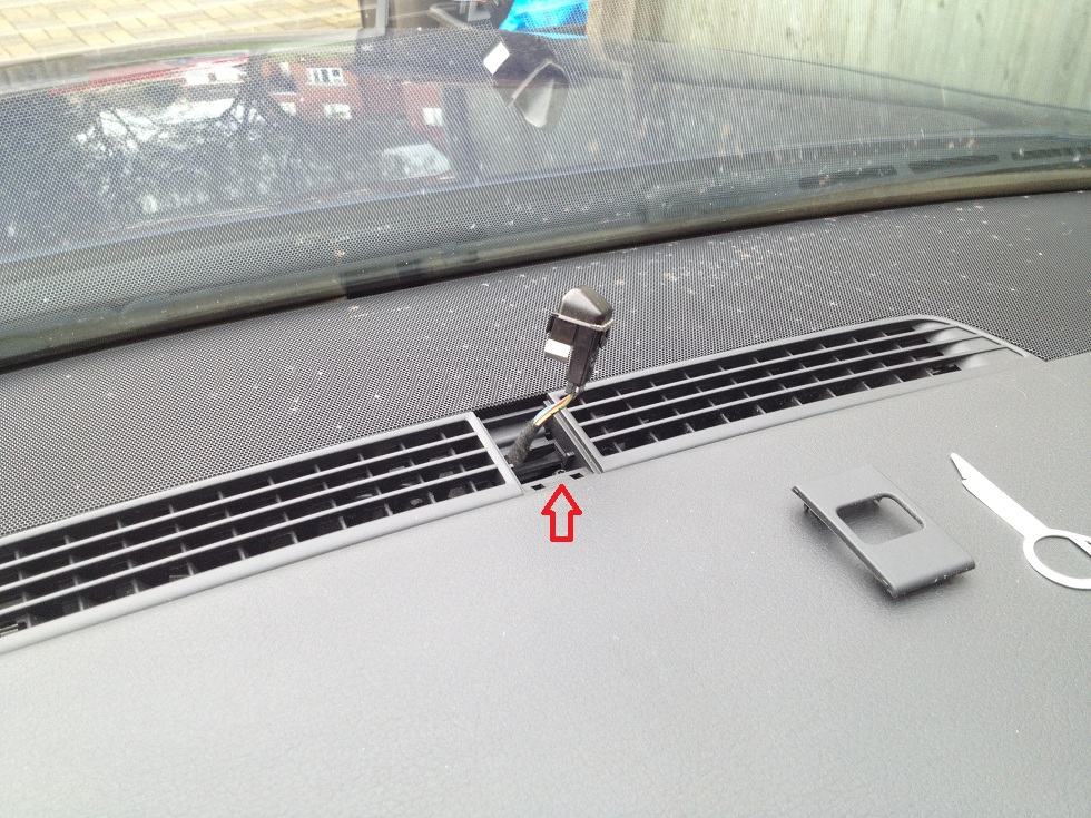

First job is to pop off this cover that holds the phototransistors for the Climate control. A radio removal key was the perfect thickness just to slip in and pop it out

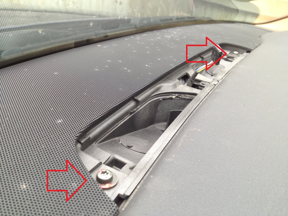

The photosensor pulls out easily, and you can see there is now a small torx screw that must be removed - T10 size - and there is a big void just behind it. Drop it, and its lost forever I guess. Worst still, it might rattle down there so be careful.
Once removed, the black ventilation grill can easily be prised up. The dash is nice and soft and wont mark easily so you can lever against it.
Two more Torx - These hold the whole mesh in place. Remove them both

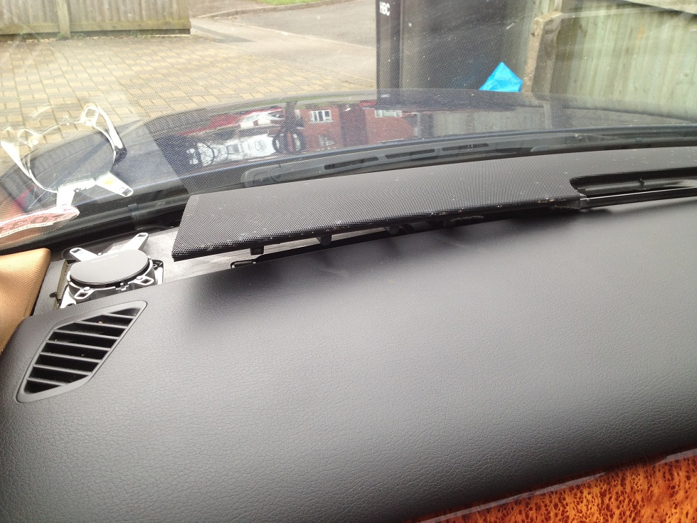

Then, we remove the two B&O tweeter covers. They just pop off with gentle prising. You can see here that to replace these tweeters is litterally just a case of popping off the plastic cover, and 2 torx. Couldnt be easier. I dont need to remove them though, so remove both covers only:

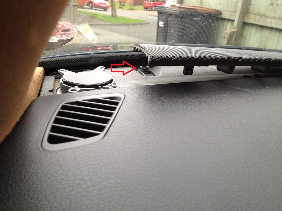

Now, we can lever out out the mesh. Its not quite as fragile as it looks, its on a sturdy plastic frame, but still we go steady. Lever it up vertically at the front nearest to you:
and then it will slide backwards towards you. You can see the clip (arrowed) that holds it down. There are 4 of them evenly spaced across the dasboard.

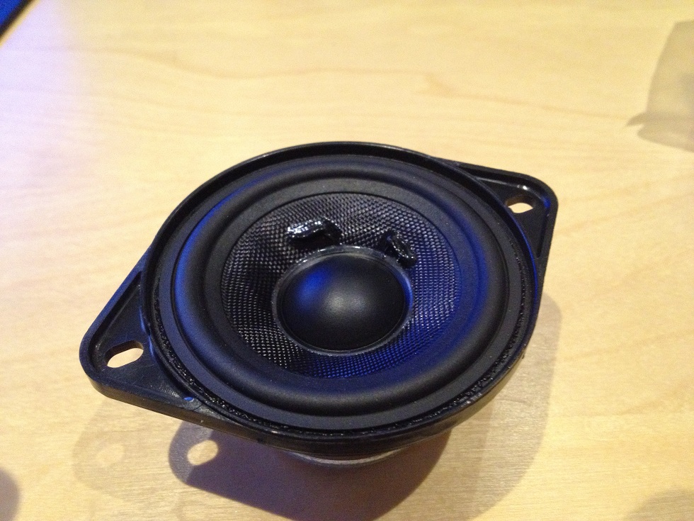

And here is old, next to new. I firstly disconnect the center speaker altogether, which immediately stopped the fluffy horrible noise I'd been suffering. There was no visible damage to it, but by removing it I certainly fixed my issue. With the new one in, it sounds 100% again
