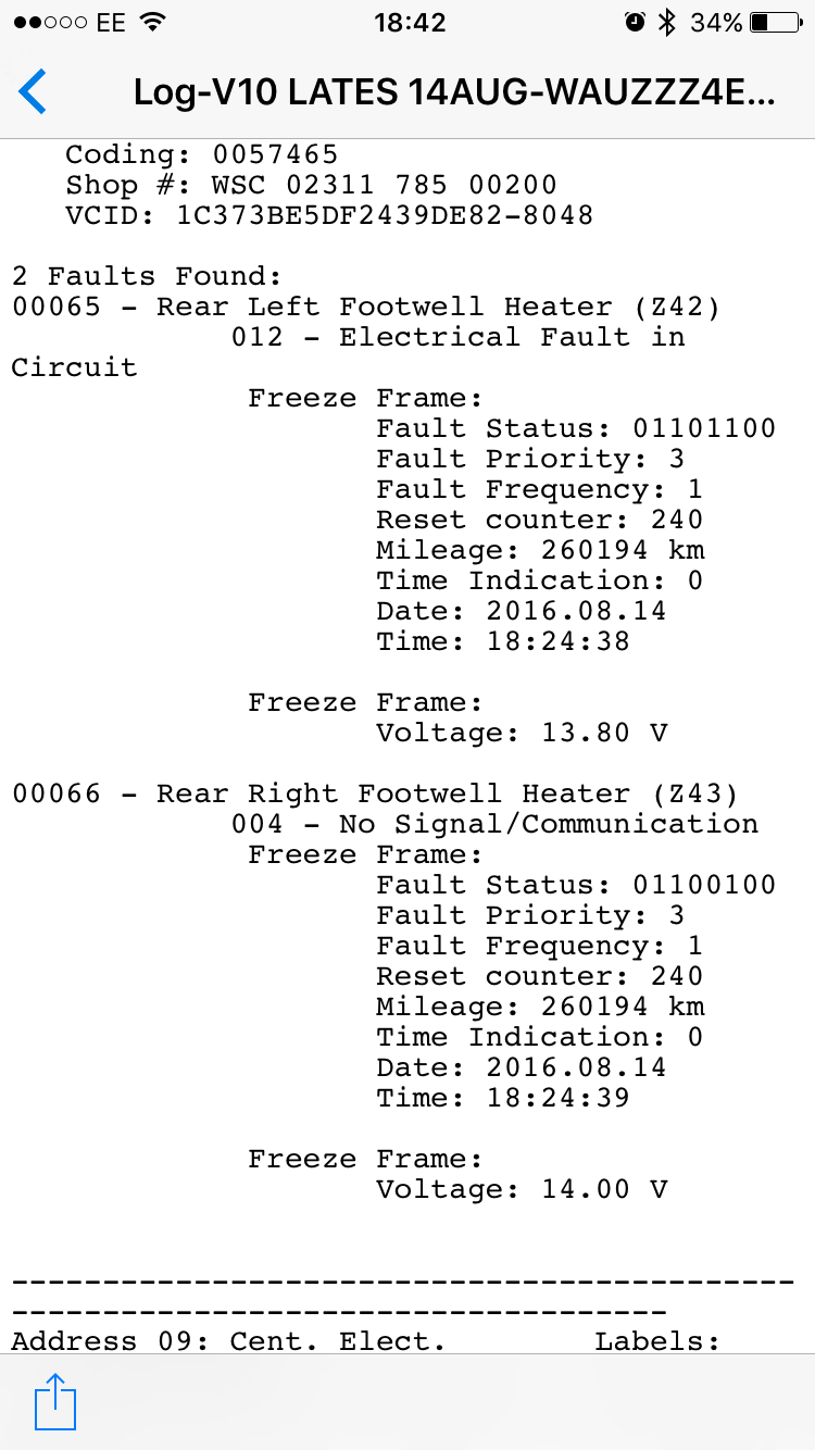

Old 20th December 2016, 05:39 PM
I've got two sets of these
One on the car and one in the garage.
First screenshot is a set which is on the car at the minute.
Second screenshot is of the replacement pair I have on the shelf, but only right heater has an error so the left one could ok ?? Ignore the blower fault, that's not my car's.
Why both don't have the same error?? One is 012 while the other is 004.
