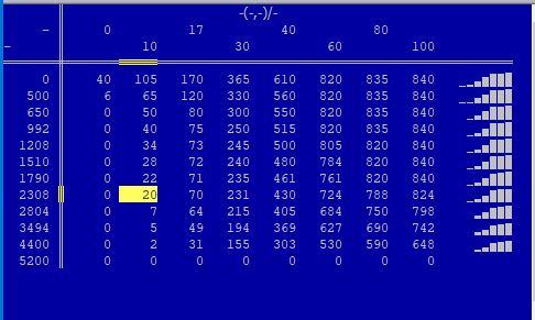

The first thing I would like to address is where it all starts with the driver input at the pedal. So basically the ECU needs to translate the accelerator pedal position (learned position) into the torque value in case of EDC16/EDC17 or injection qty in mg in case of older EDC15. I will talk about 4.2TDI which has EDC16CP34 so it will be Nm.
There is a map or to be more precise several maps that translate pedal input to requested Nm, it could be several maps for normal, limp mode, reverse and so on. There can also be several blocks of the all the maps in the same ECU for different codings. For example my 2.5 TDI has 2 blocks depending on coding 1 for manual and 1 for auto but A8 only 1 block.

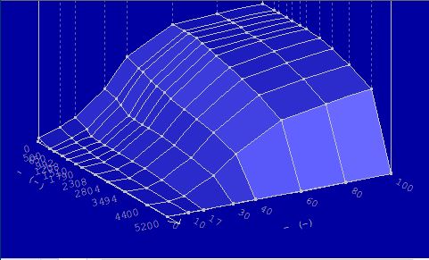

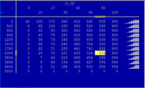

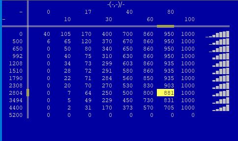

So if we have a look at main drivers wish map it has 2 axes of engine rpm and pedal position and and output of Nm. This is the stock map for my soft version in text and 3D. On the text version you have % of learned throttle going horizontally and rpm going vertically and the grid as the requested Nm depending of rpm and throttle position. This is only what the driver requests, not the actual torque that engine will be delivering as that will be limited by a number of other maps and factors. You can also see that it goes to 0 Nm at 5200rpm with the torque reducing rapidly from 4400 to 5200rpm. If you feel a bit adventurous and want to take the risks you could change that like I did on A6 and have nearly full torque up to 5300rpm and the a drastic cut from 5300 to 5500 rpm. The A6 does the rev limiter bounce like the petrols do and not the gradual fade out you normally get on diesels, but this will be affected by a number of other maps as well.
We can see that original map is already going up to 840 Nm so you do not really need to modify it if you do not want to go over 840Nm and you do not want to modify throttle response.
Now if we have a look at the modified files you will see that tuningfilewarehouse £15 file for my soft version 382247 goes up to 900Nm
and Swiftec version for soft version 392905 goes to 1000Nm
Like I said this is what the driver requests, not the actual torque engine will make as that will be limited by a lot of other maps and factors but if you don't ask you don't get.

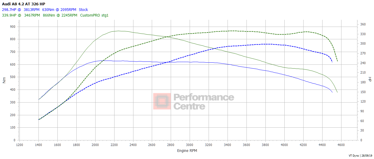

Intresting stuff, I might be downloading WinOLS and taking a look. I had my A8 4.2tdi D3 remapped on stock hardware and was down on power on the dyno 300hp 630nm took it to the Perfomance Centre in Sunderland, they upped it to 340hp 866nm, which if I honest looking back was disappointing however they thought it was to do with carbon build up but I wasn't sure. looking at a lot of dyno video for the A8 4.2tdi BVN the car seems like 340-360 peak is about right for stock hardware with everything intact. Since then I removed the dpfs and egrs and removed the silencers, changed the glow plugs and fitted a new clean top manifold and oil service and BMC air filters and it feels faster to when it was only remapped I think, I'm doing the swirl flaps next when I get some time off. The max peak hp I've seen dyno proven without modifying the turbos is around 385hp dyno proven, theres some claim 430+ on the D3 without uprgading turbos but I dont think thats possible, if you upgrade the turbos yeah, those figures probably only possible on the d4 as they have upgraded compressor wheels and upped rail pressure as standard along with different intercoolers and gearbox. Hope the tuning goes well and will be interesting watching your progress
That's a lot of torque for not that much of power, not something you would expect. Stock engine has 650Nm 1800-2500 rpm and 326 HP at 3750 rpm which would be 620Nm at 3750 rpm. If your peak HP were at the same point as your max torque it would be max power at 2790 rpm. Or if your maxpower was at 3750rpm then it woulfd be 650Nm at 3750. So something was cutting torque a lot as rpm went up, could be restriction in intake or exhaust, exhaust gas temperatures getting too high or not enough fuel delivery - blocked fuel filter or weak fuel pump. Did you have picture/ printout from dyno? Or maybe they did what's called 'economy map' where you get a lot of torque only at low rpm to encourage upshifting ang keeping highest possible gear. For example 700nm at 4k rpm is 393HP. Maybe they went too high with torque, EGT got too high and ECU cut fuel to reduce EGT before it got to max power. Did they do any logs while on dyno - EGT's or DPF pressure differential, fuel pressure, lambda? You are a bit too far, otherwise I would have been interested to read the file from your car and see what they have done.

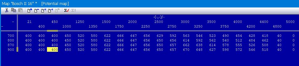

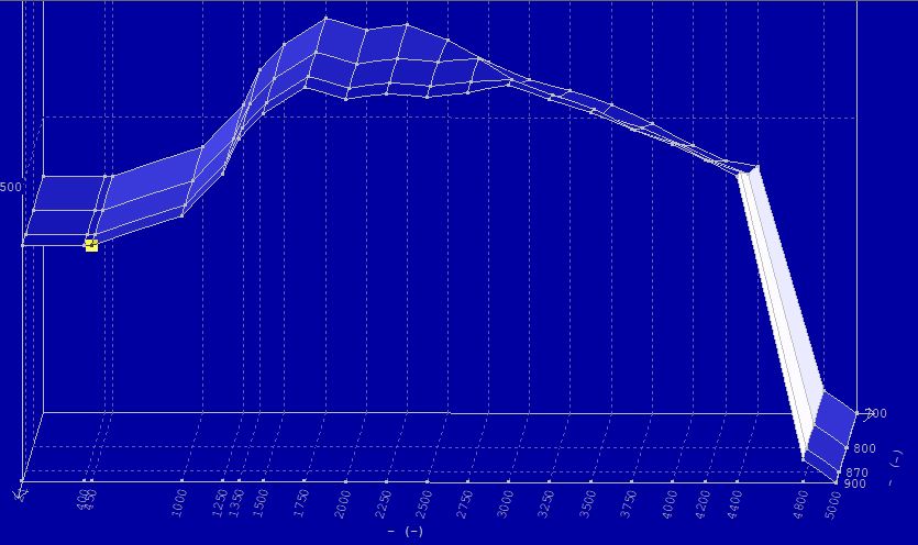

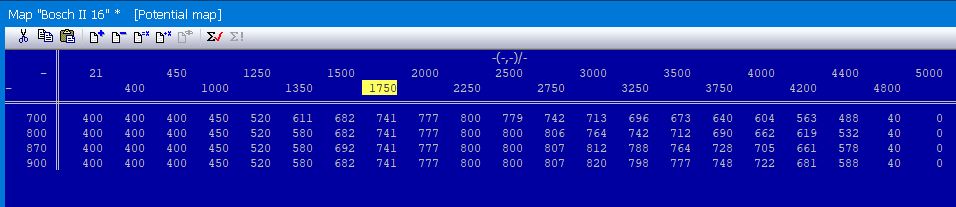

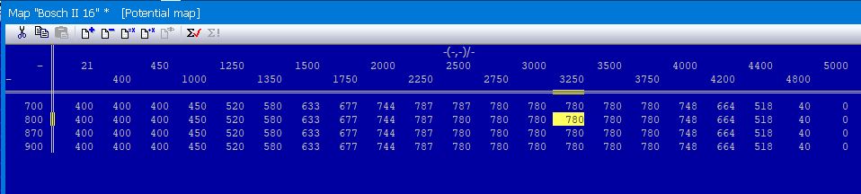

The horizontal axis is rpm and vertical is atmospheric pressure, output is torque limit in Nm. You do not normally need to worry about the pressure unless you live in mountains, then it uses the lower value lines at high altitude to protect turbos. All we are interested in is 900mbar line which is use up to about 3000ft/1000m altitude.
This is stock map going up to 670Nm
This is tuningfilewarehouse map going to787Nm
And this is Swiftec map going to 820Nm

I've attached the dyno graph, it has always made me wonder how the torque went to 866nm peak but hp was only 340hp peak, surely this would have increase proportionatly who knows. I did at the time of the remap had a completely stock exhaust so could of been a safe EGT tune, since then the exhausts are completely empty bar the precats off the turbos, which I can imagine are difficult to get off.
