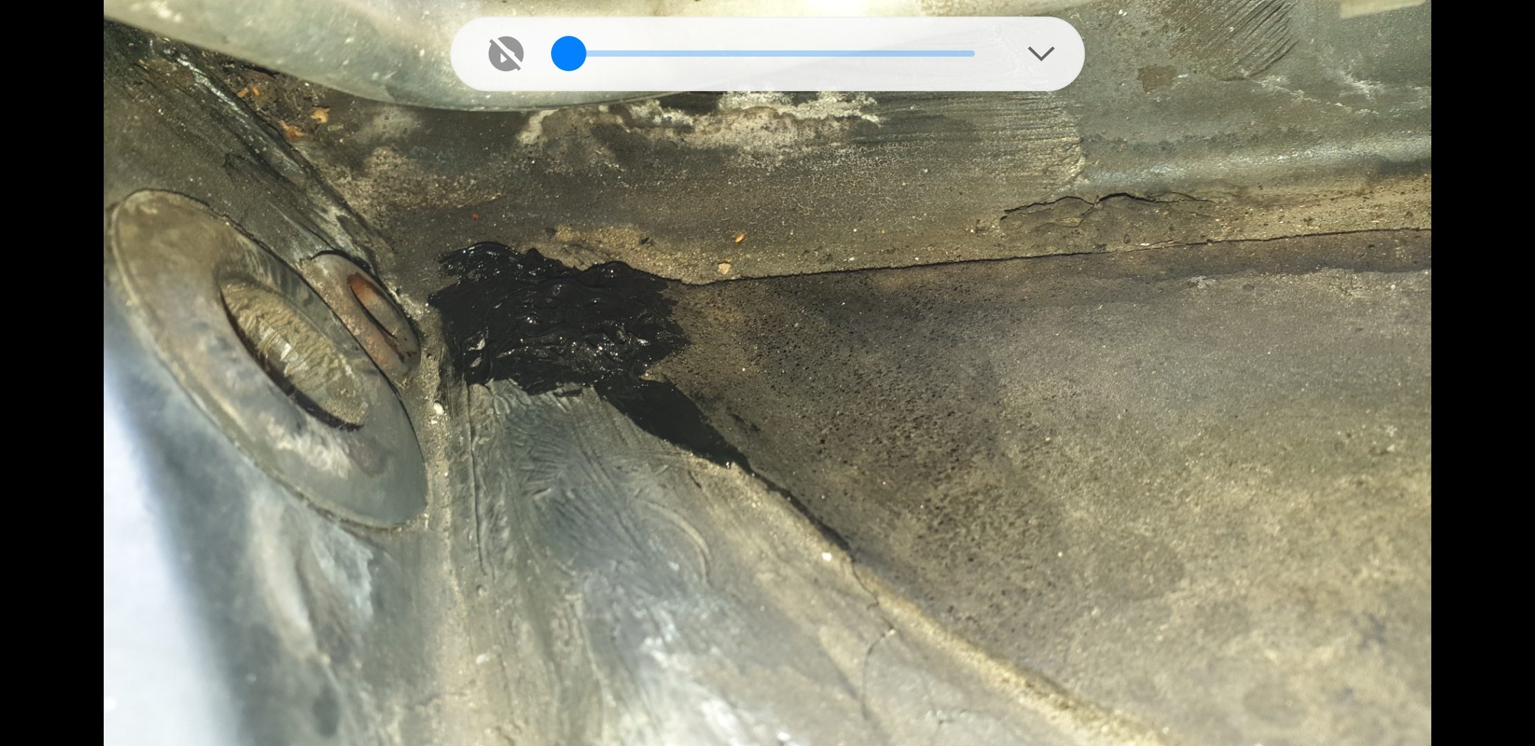

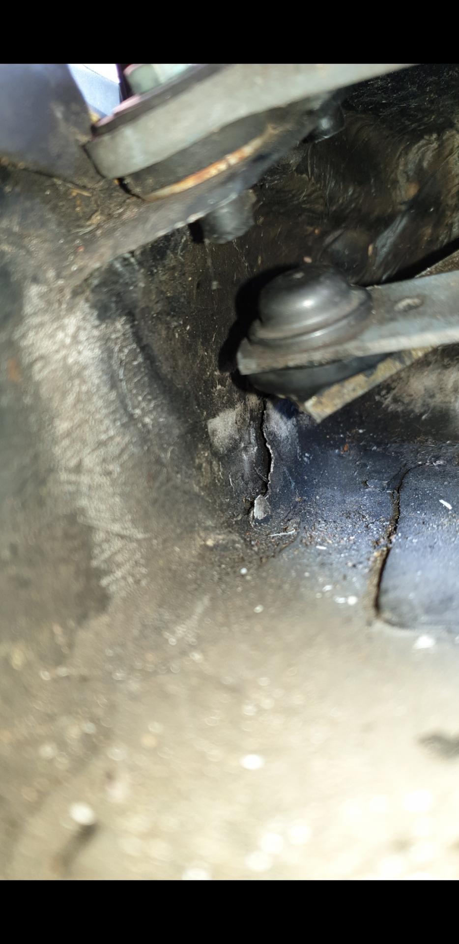

Check out the images bellow. I did find this up at the corner of the os wing. Olmost like the botang issue but on the other side of the car. Pour water on the windscreen and the wiper blade directs it all into this area and yes, you guessed it, straight into the drivers footwell. This hole goes directly into the cabin. So, a stationary wiper blade directs 50% of all the water that falls onto the windscreen into this area. You couldn't make this s__t up.
I guess the golden egg question here is, has anyone seen anything like this before or is my car special?
My guess would be a poor repair at some point in its past but I'll reserve judgement until the forum gurus take a look.
This by the way doesn't explain the water in the passenger foot well. That little chestnut still needs to be discovered.
Cheers Frank

Frank, I get plenty of water pooling in that area but it doesn't go into the cabin....
As for how it's supposed to look I'll leave that to experts like MJ.
Edit: Decided to have a look at mine and lubricate the suspect bonnet pins and catches at the same time. Photo coming shortly.....
