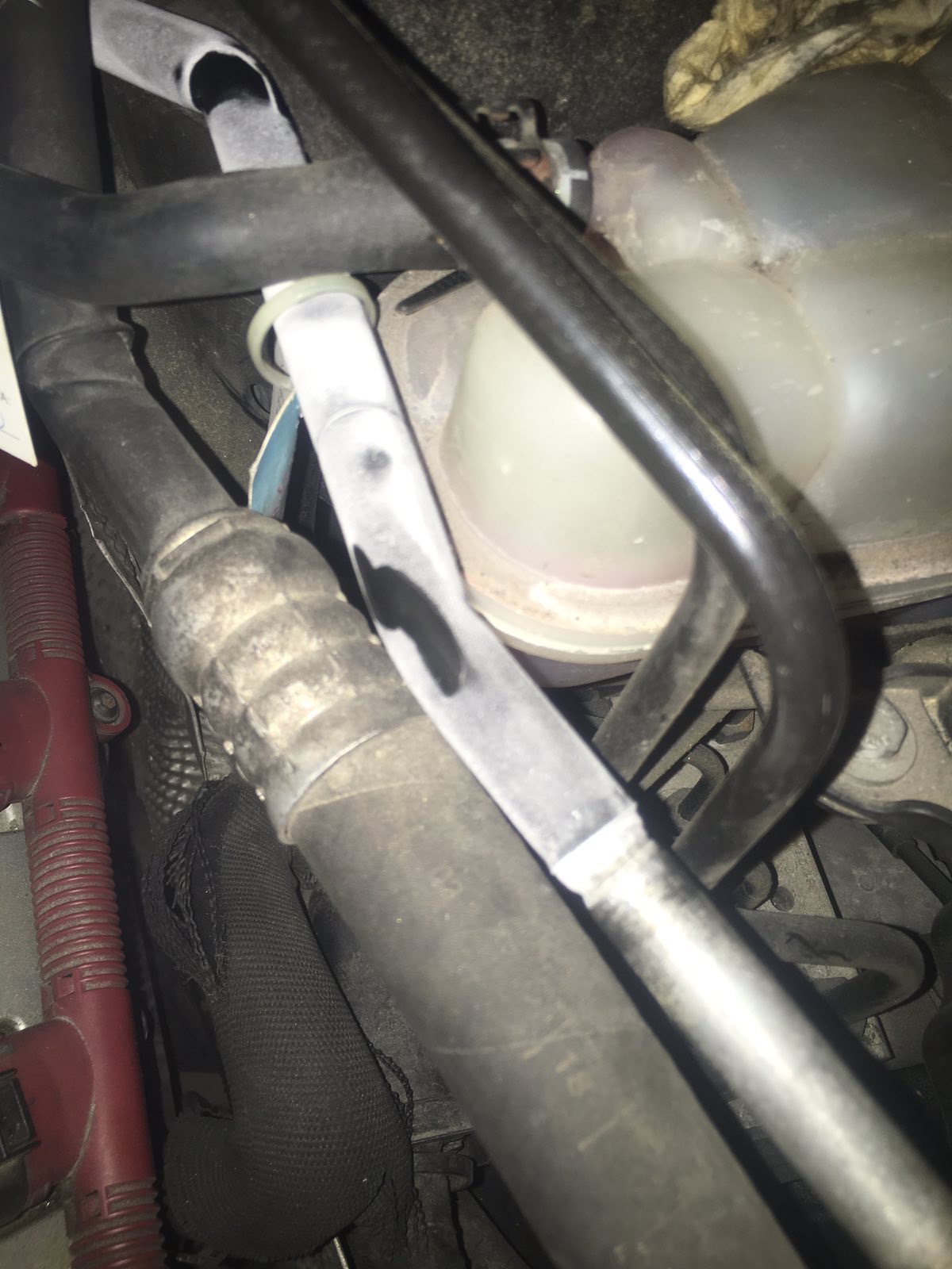

The compressor is nissens brand new unit and it is the correct one.
No errors whatsoever for anything related with the high pressure system.
Only rear footwell heating elements and some flaps.
Compressor works as the high pressure hose gets iced up.
