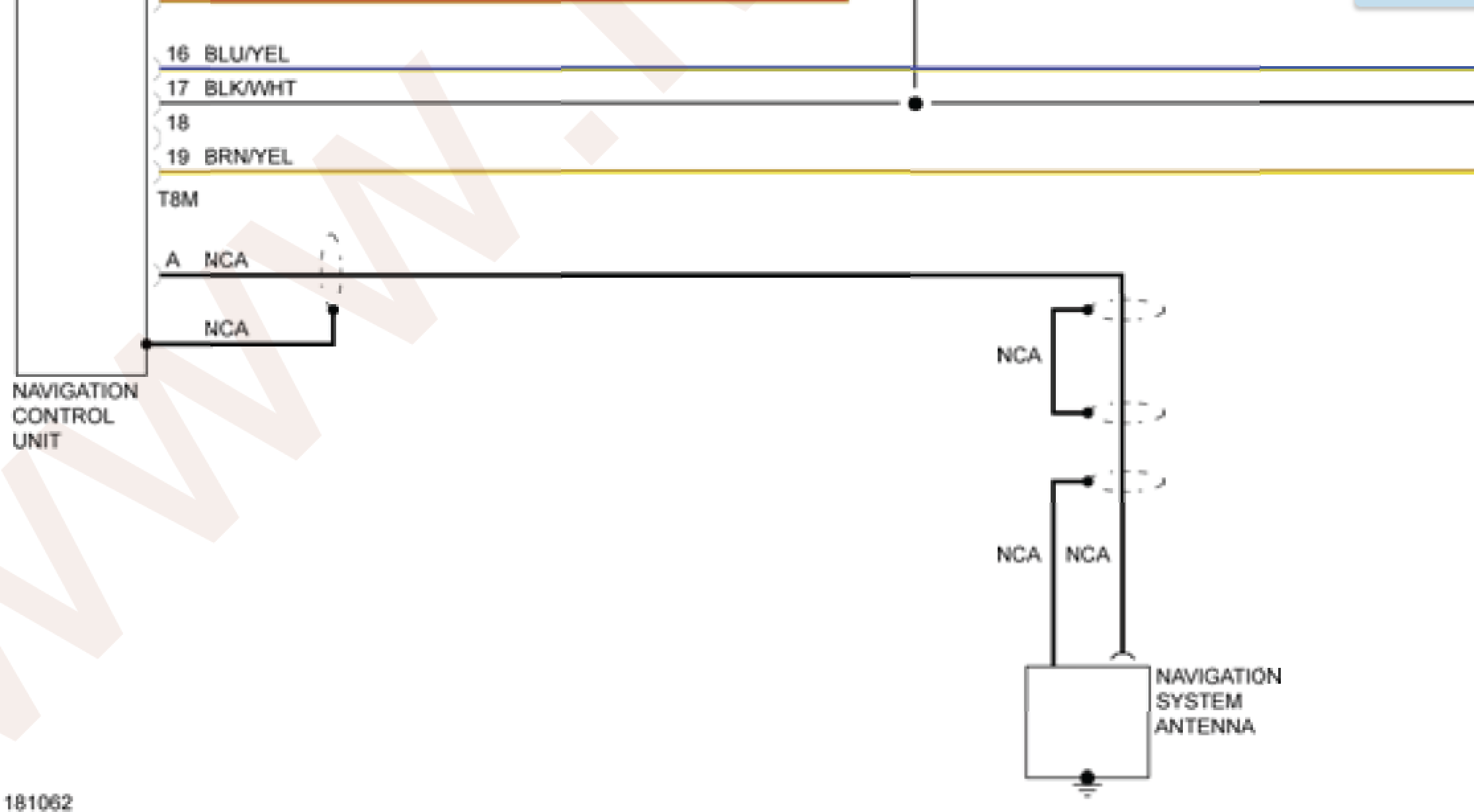

Antenna? Ok they aren't that long... only about 14" long actually. Def part of the orginal wiring.

Old 13th August 2020, 10:52 AM
The error messages you posted were all about the antenna, hence my comments. Your diagram does show the coax cable to the aerial, which this obviously isn't.
Could be power supply cables, do you have the separate older "text" Nav unit in the boot then, rather than the graphic RNS version? Someone here may know about that, I don't.

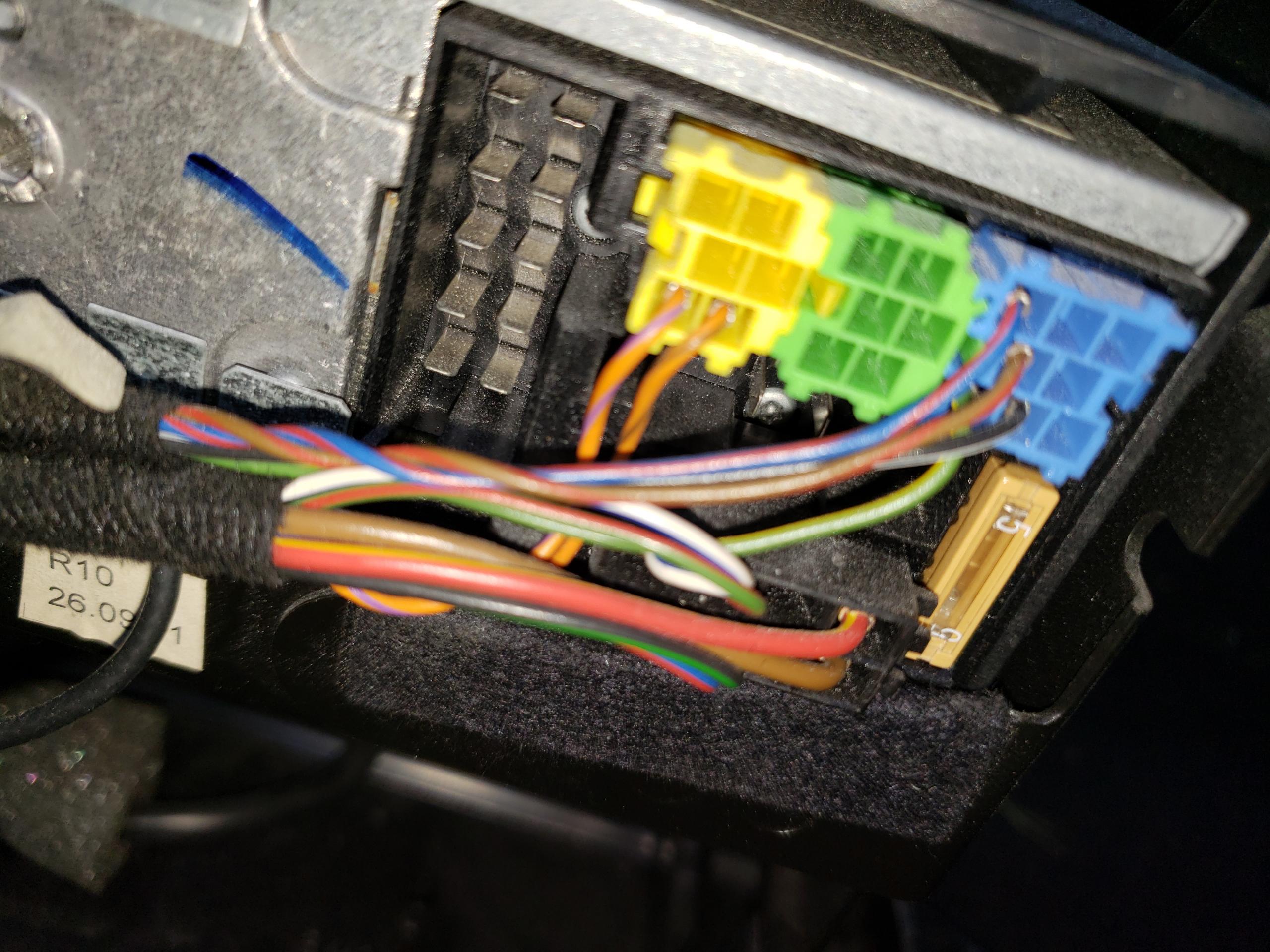

Yes, text only version. That red/yel brn pair of wires showing in the pics are where they're supposed to be, the loose ones are obviously for something else. Looking at schematic again now.

Old 14th August 2020, 07:44 AM
Those two wires are for one of the boot lights which is in the plastic panel at the back edge of the boot.
Pic borrowed from our sponsors:
The light is on the right of the panel in the picture, obviously on the left when looking in the boot.

Ohhhh. Thank you, MikkiJayne.
