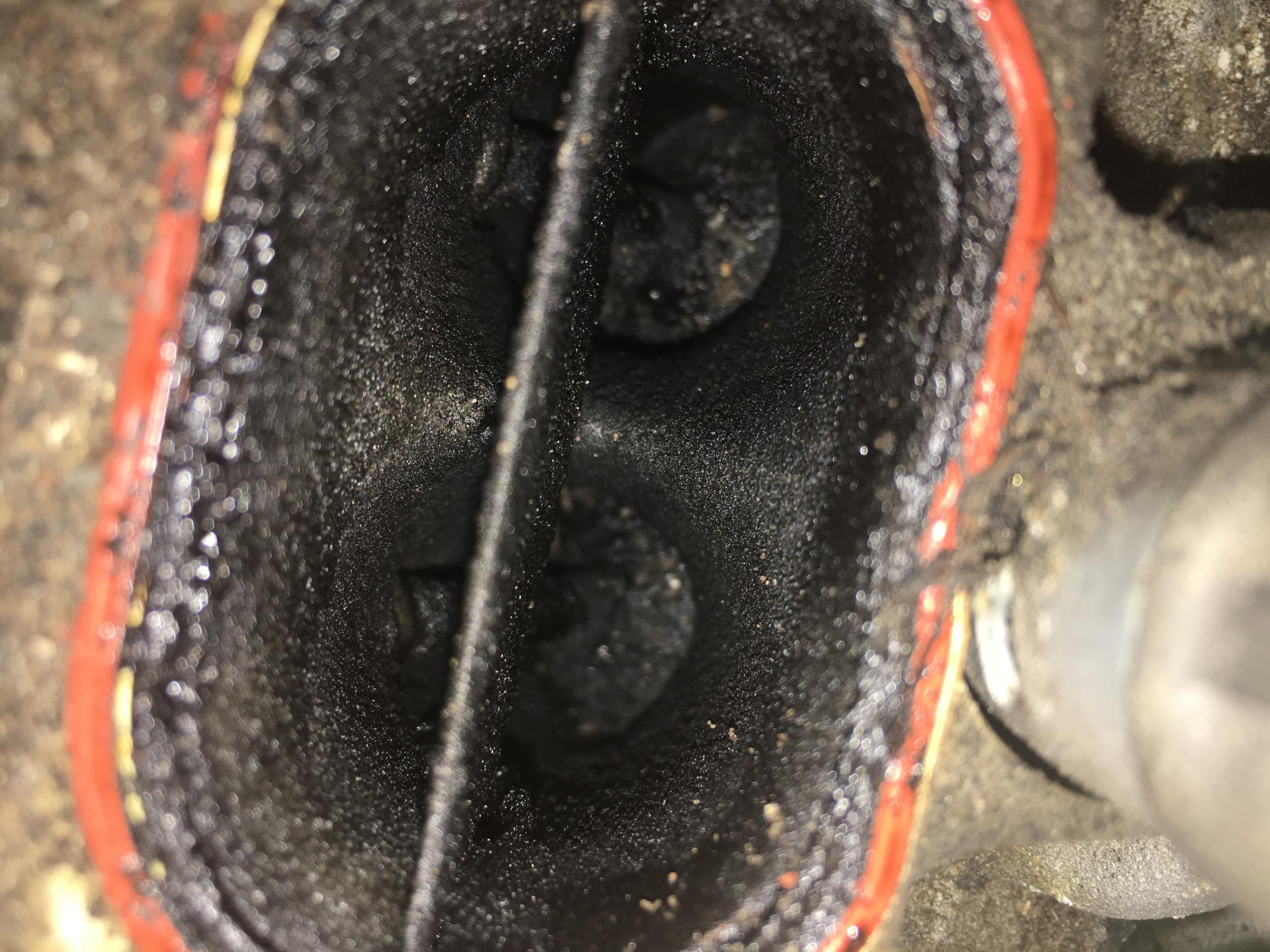

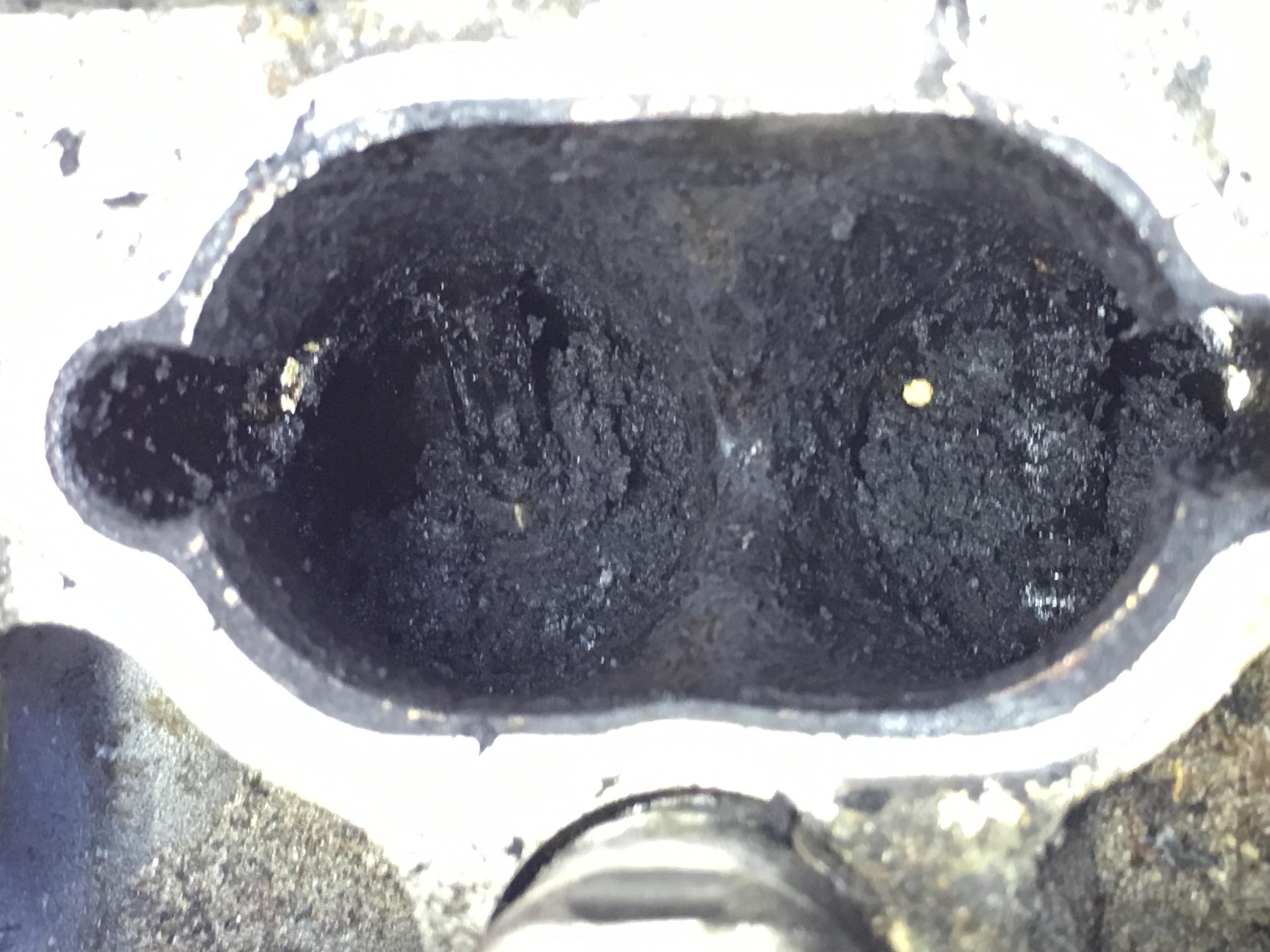

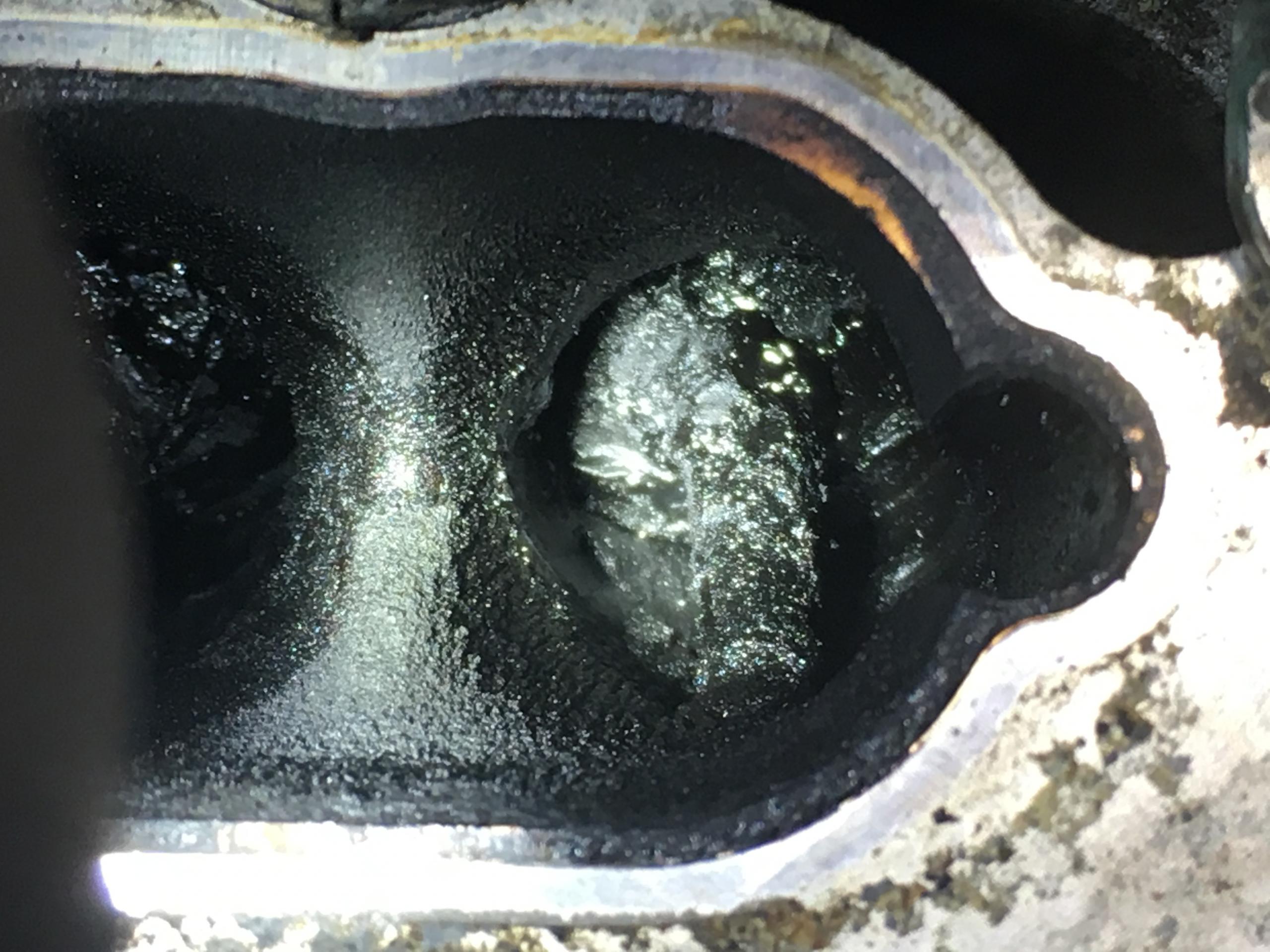

Process:

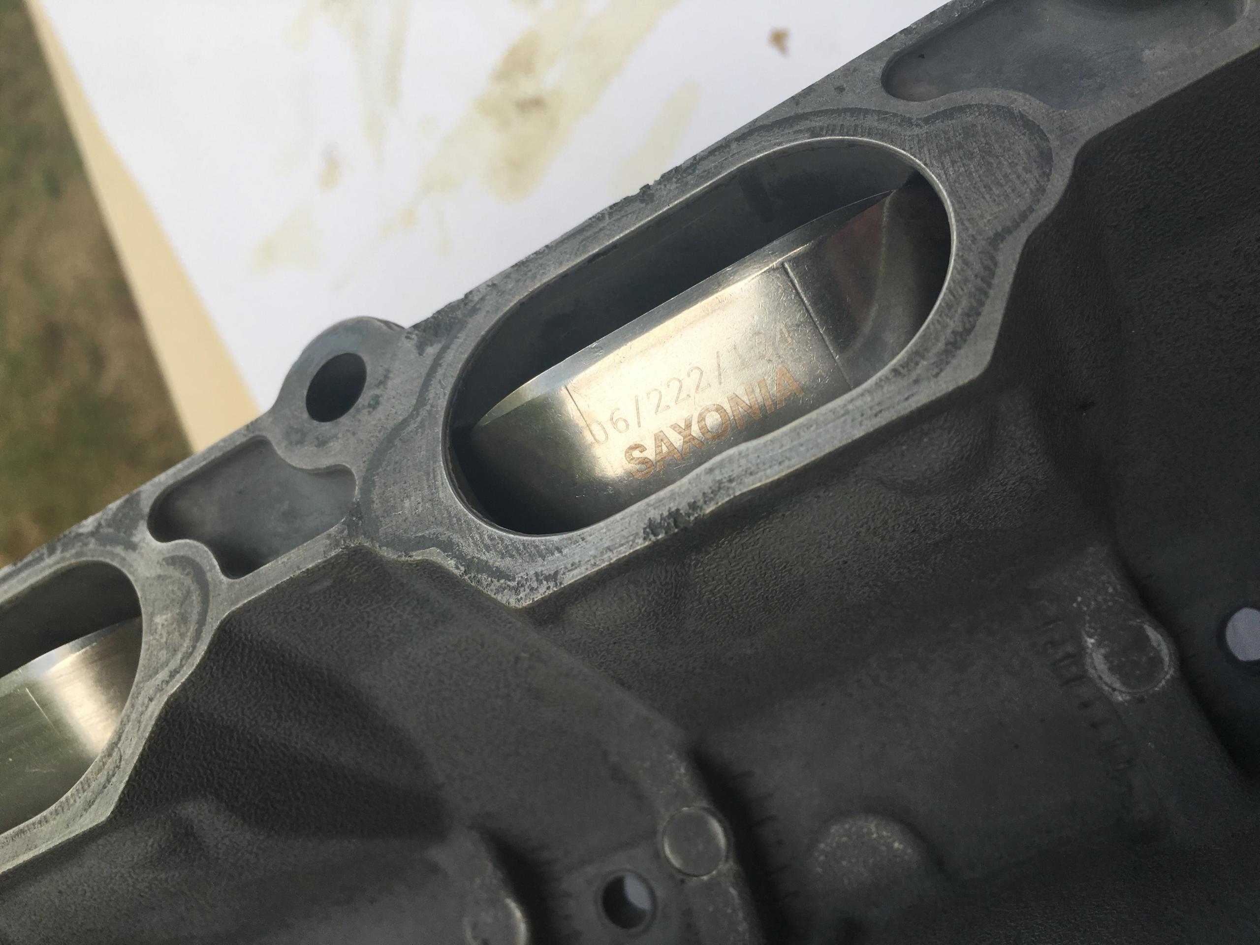

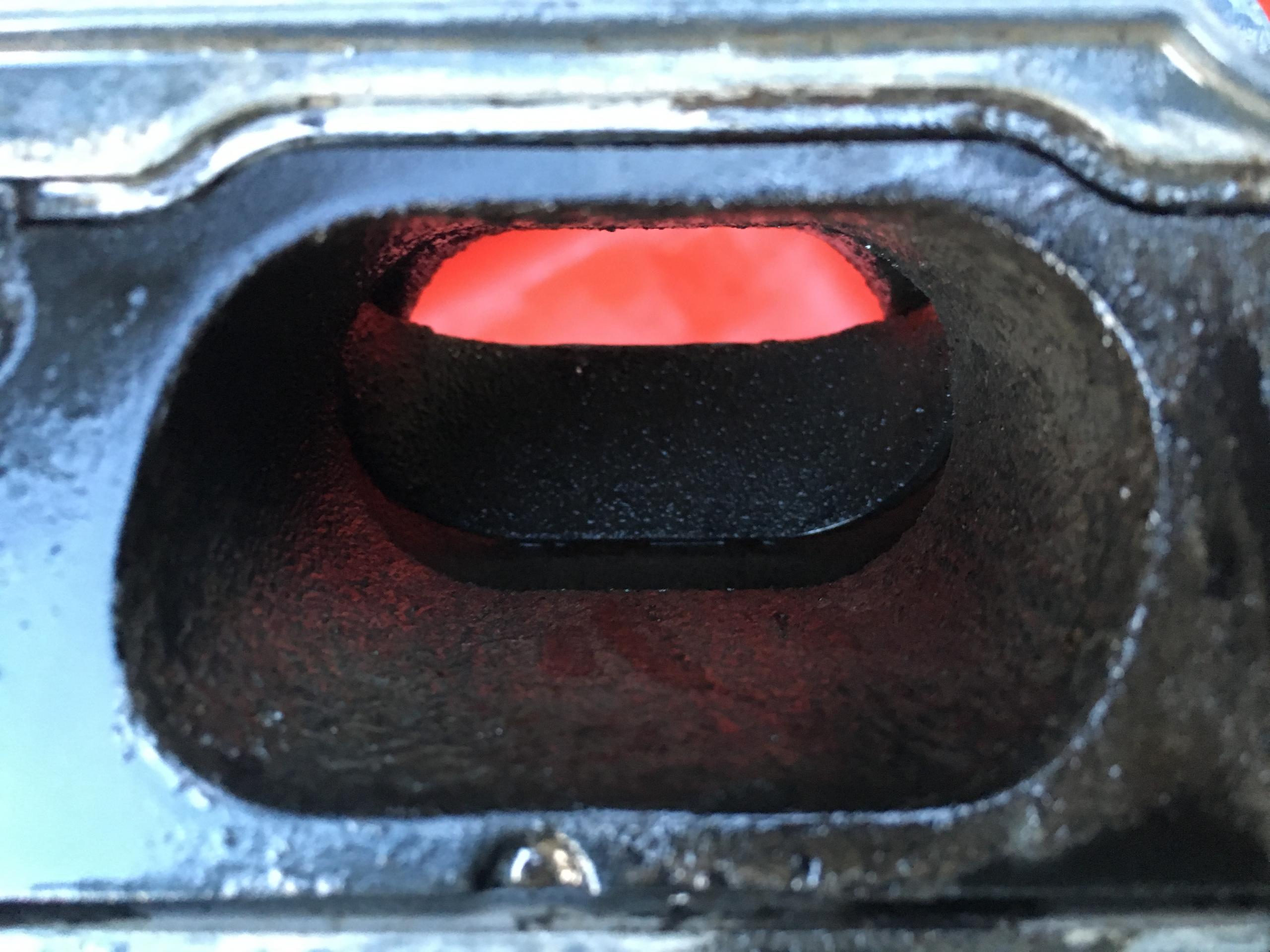

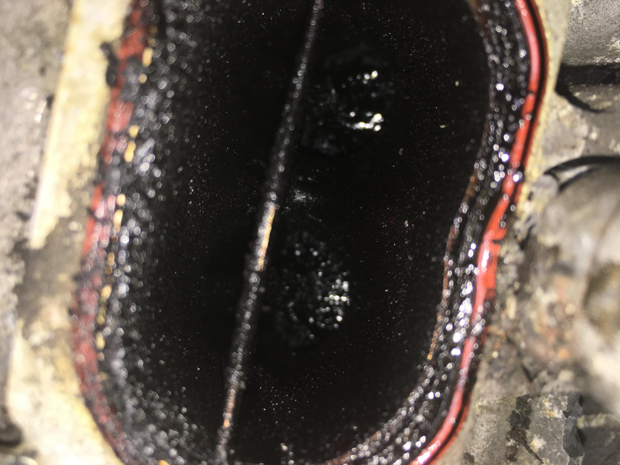

Lets start from the inlet plates. Remove as much build up as possible, put all the plates in the bowl and let it soak in the degreaser while you are working on the inlets.
Inlets, this is how completed this process with a great result at the end.
1. Scrape off as much build up as possible with the slightly bend flat head screwdriver. Inlet walls first.
2. Vacuum out.
3. Use either plastic or brass wire brush on the drill (avoid steel brushes).
4. Vacuum out.

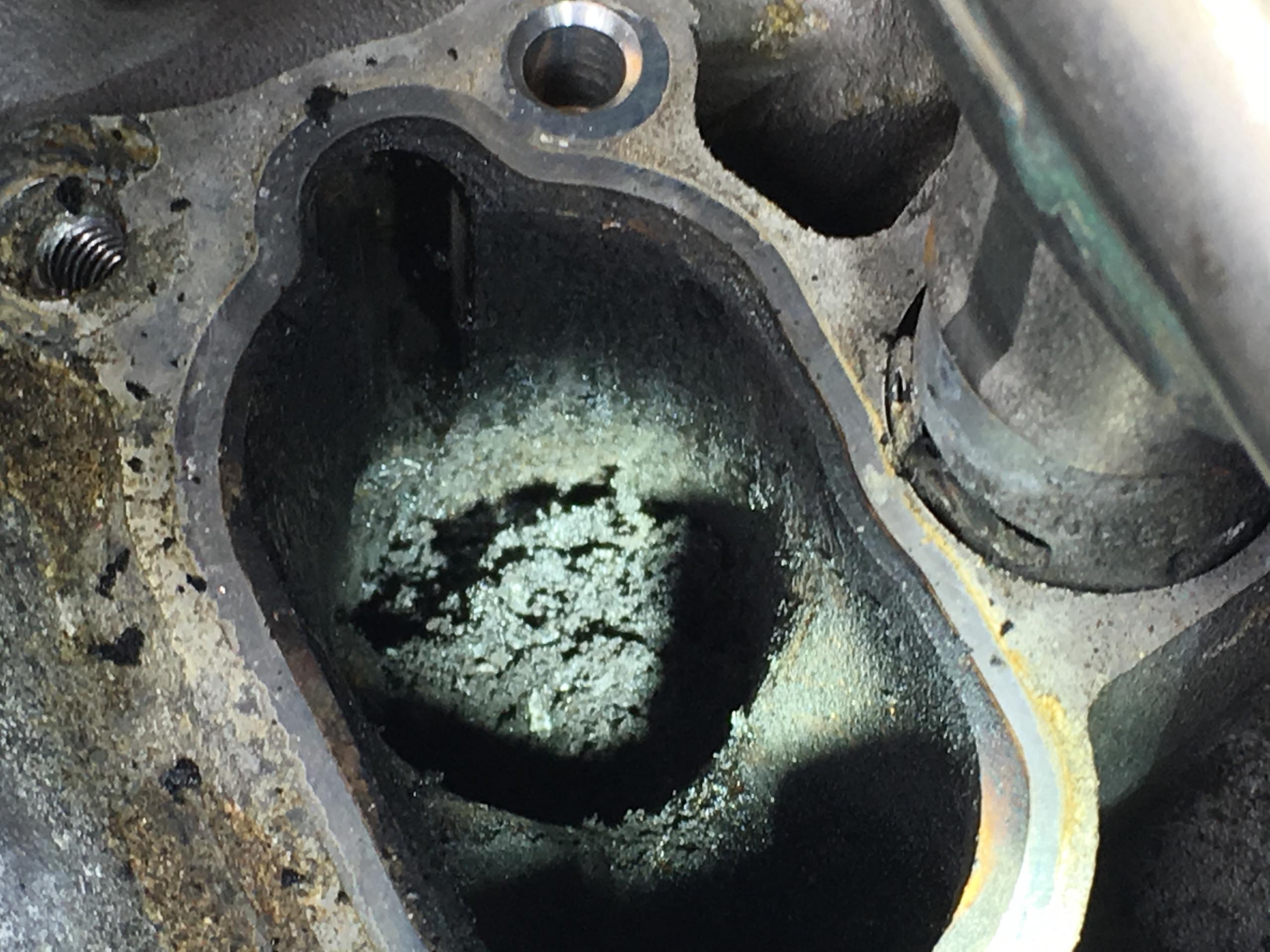

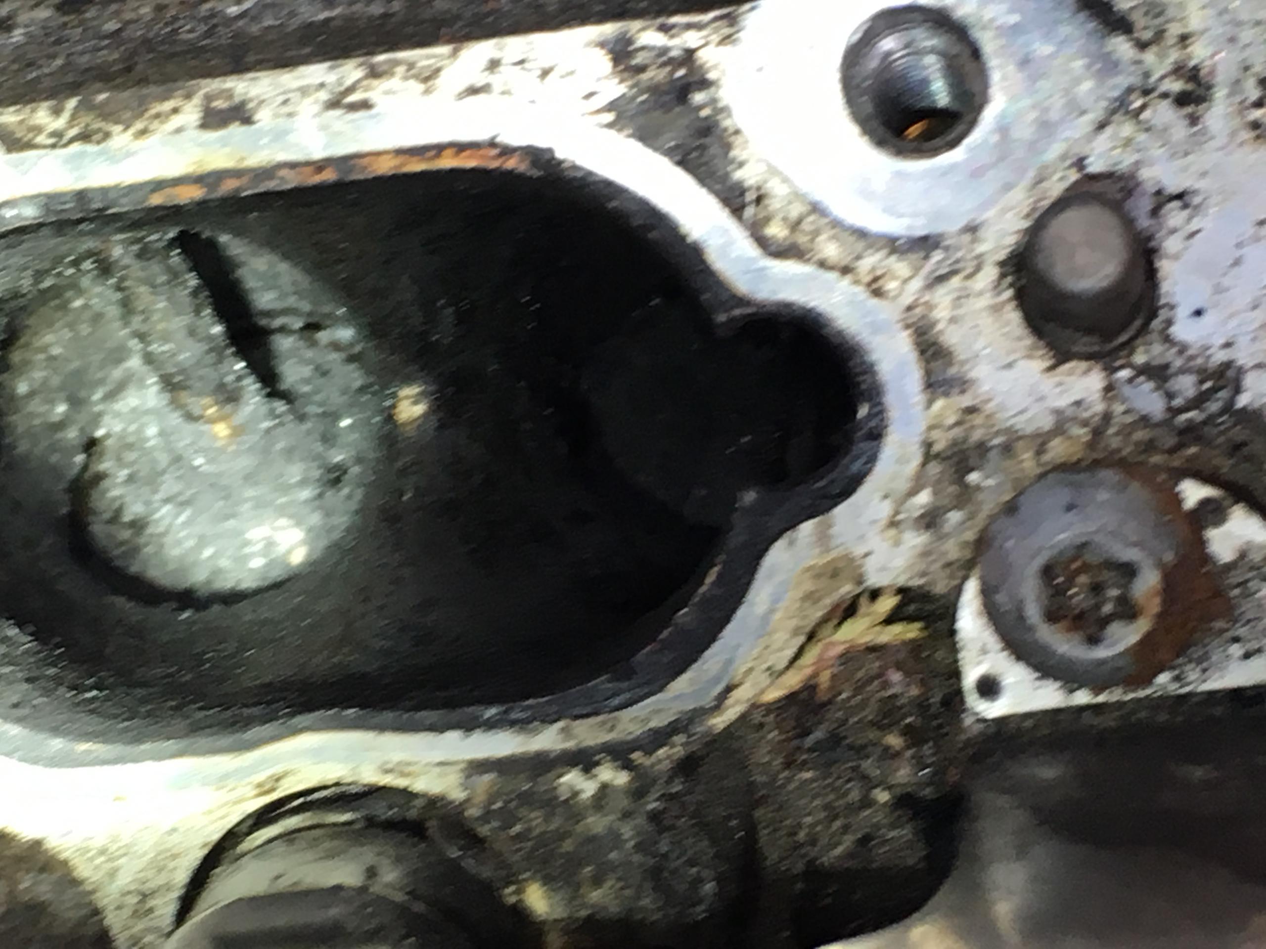

5. Valve heads - this is the worst part as they get very hot so the build up is rock hard and stuck well, it's where you will spend most of the time.
6. Vacuum out.
7. Spray the walls with the degreaser using the narrow nozzle to flush it all off.
8. Suck it with a wet vac and inspect places you've missed.
9. Carry on using combination of toothbrush, wire brush (drill), normal wire brush, green scouring pad until all or almost all of the build up is gone.
10. Fill up the inlet with the degreaser (3/4) and run it over with a plastic wire brush on the drill. You will have to try all sort of angles to clean the edges of the valve heads which you can't always see and valve rods/shafts from behind.
11. Suck it all with wet vac
12. Fill the inlet with degreaser again flushing inlet walls at the same time
13. Suck it all out with the wet vac.
Then inspect and if you are happy move on to the next one and repeat the process 9x more times, if you still can see bits left behind use appropriate tools. I wasn't happy with few of them so I was doing it over and over again
Apologies if some of it may not make sense or it's just too much detail for your liking, I wanted to describe this process as well as possible and as quickly as possible for Tony to decide if he wants to do it himself or get the garage to do it.

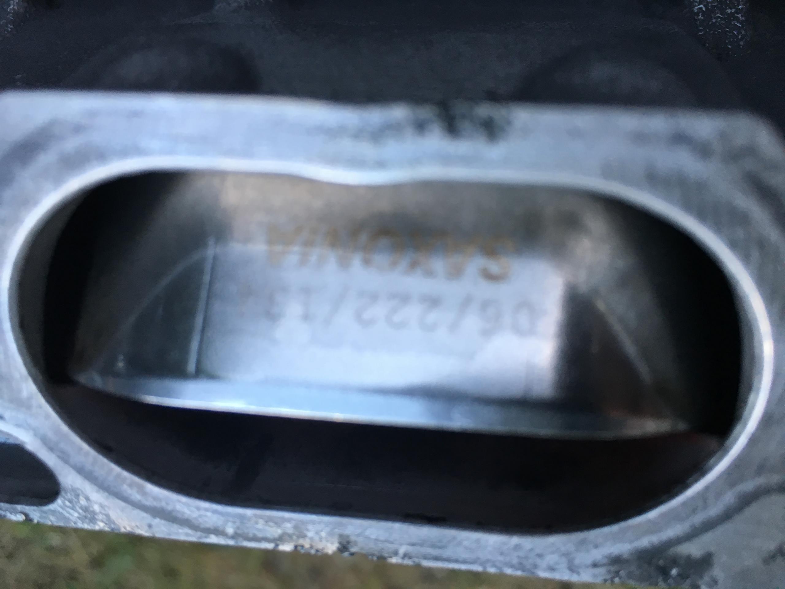

Photos attached, any questions please ask.

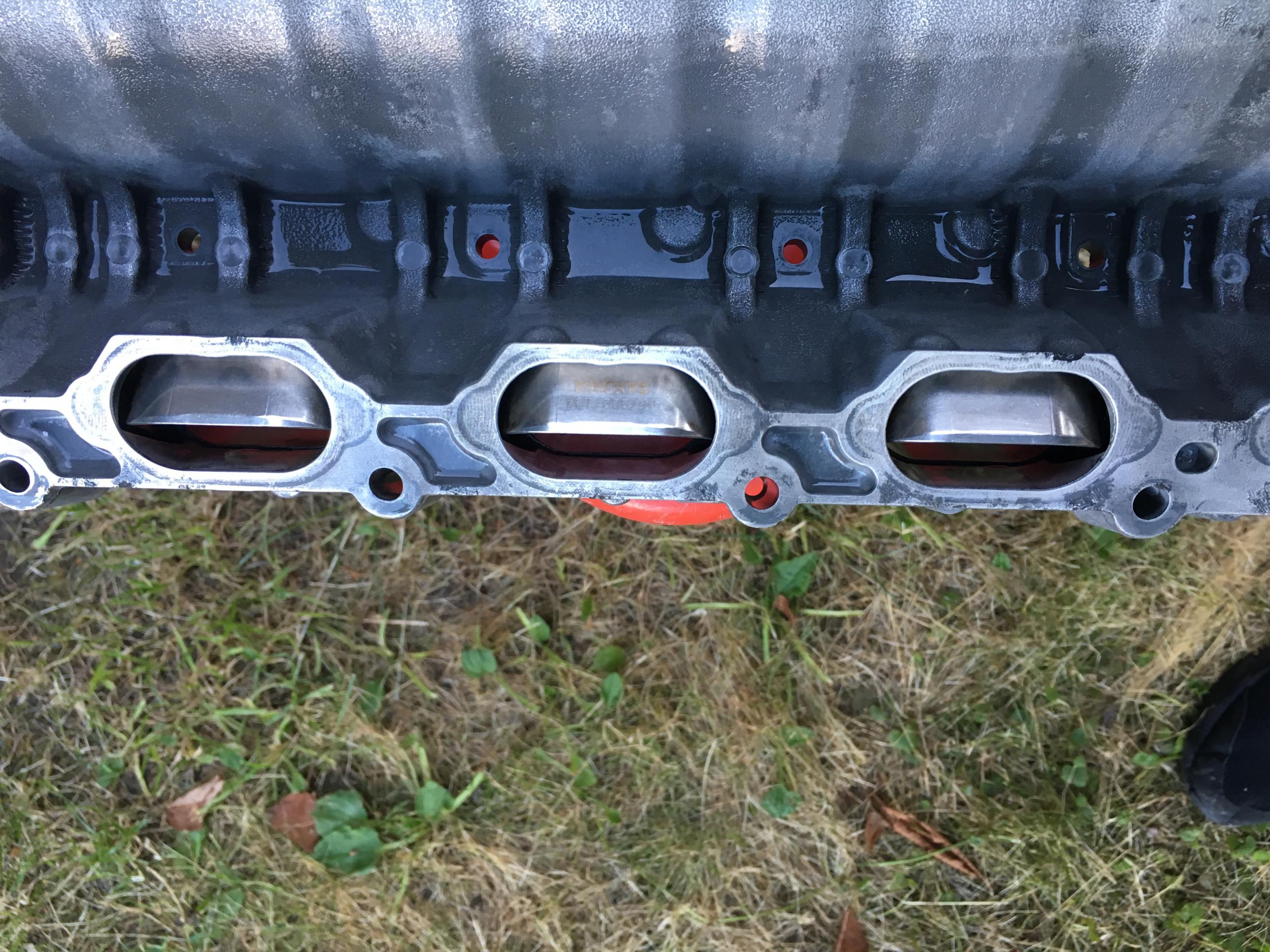

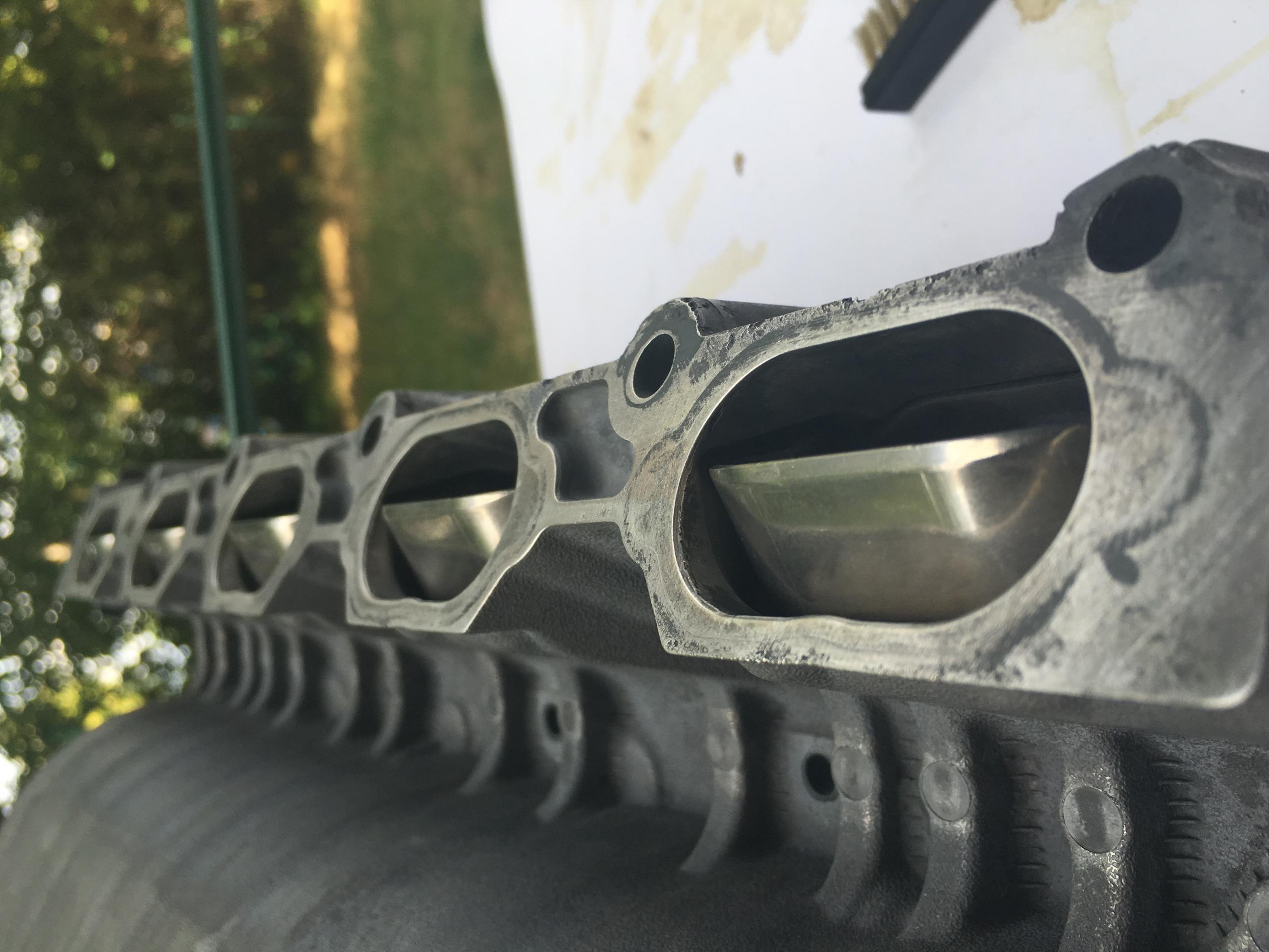

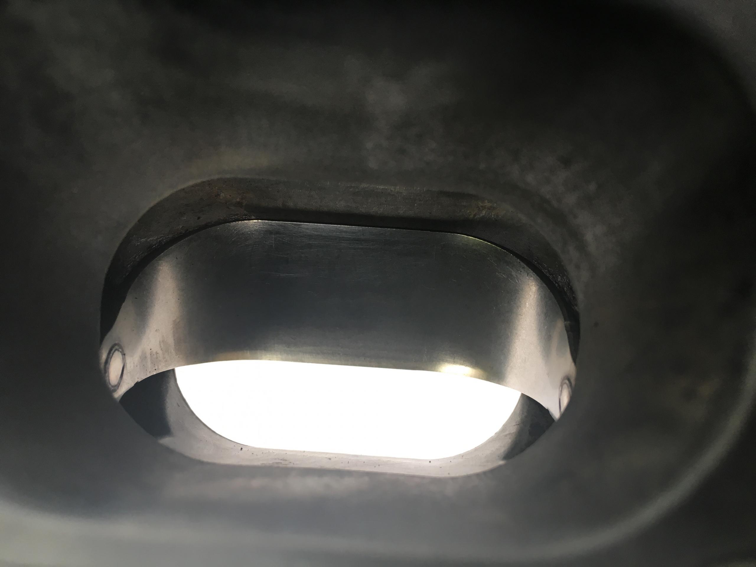

I've attached also few shots of inlet's variable flaps which I have decoked while having manifold split, doing it on the manifold in piece would be a pain and to do the job properly you need access from inside the manifold - you will need at least two days to split the manifold, clean it inside and the flaps of course, removing flaps is easy, then cleaning the silicon off which is a pain, putting it back and resealing it inc. bolting back on flap motors and all that.
