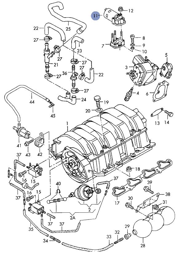

Idle control is done by a valve at the back of the inlet manifold - #11 here:
This is a servo motor with essentially a gate valve on the end, which the ECU controls to allow more or less air to bypass the throttle body.

No problem! MJ, you must know if it's accessible without major dismantling? I think I should try to check and clean it, as well as those hoses displayed left of it in the diagram. I guess the hoses are behind the inlet manifod as well.

Old 8th October 2020, 09:03 AM
The idle valve is easy to get to yes. Pop off the plastic engine cover and it is right there at the back next to the throttle body. The larger pipes at the back are mostly the suction jet pump for the brake servo vacuum, I think fed from the throttle body. They are all pretty thick so I would doubt there's a problem with that system.
