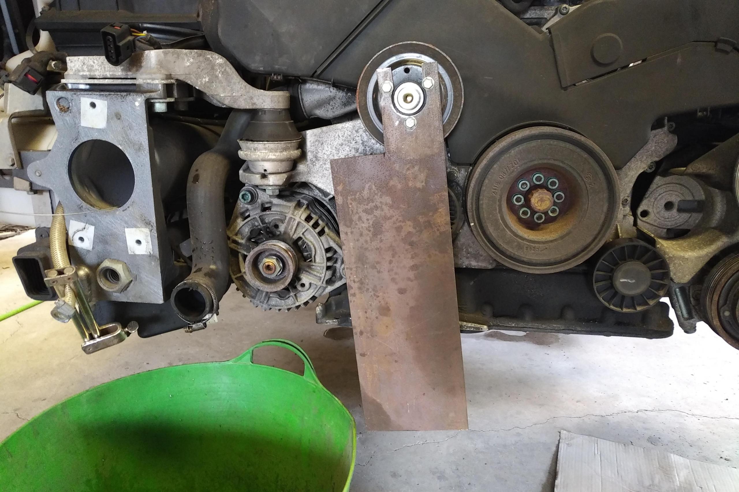

pete-p's Avatar
pete-p pete-p is offline
Posts: 668
...and a sturdy pin wrench to get the fan pulley off.
Perhaps even the special extra heavy duty version!
