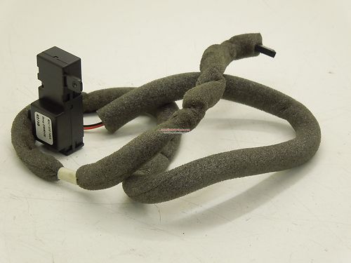

When I saw Goran's new LHD manual car from Germany I decided to try to retrofit this feature. Here's how receiver looks like. It comes with wires and 3-pin electrical connector that connects directly to unused socket on the back of instrument cluster, made specifically for that receiver.

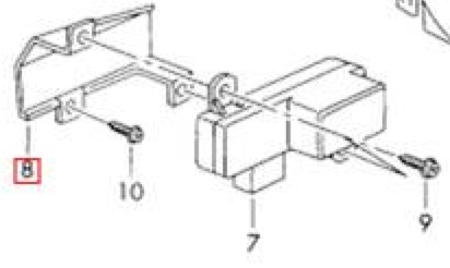

Additionally, we'll need to order bracket and 3 screws that cost pennies:

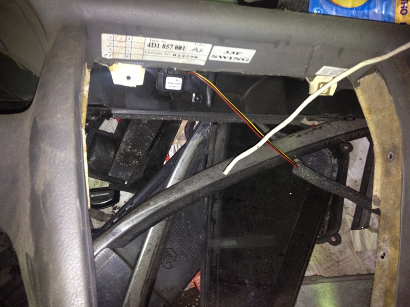

On FL D2s standard receiver location is under the dash:

I found that reception in the standard receiver location under centre of the dash is not very good perhaps because I have a-thermal heated windscreen.
Decided to secure the receiver elsewhere in the car, perhaps behind the lower right panel where most of electrical fuses are.
Undecided about exact location yet.

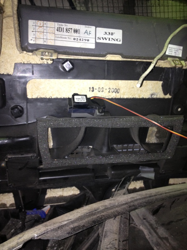

I highlighted the place where you need to look for connector if you access via removed knee panel.
View from behind the cluster (this is picture of PF cluster, but it doesn't matter):
Also, behind the cluster there is standard recess for the radio clock receiver! It can be nicely secured there with 2 bolts from my first post. But Audi decided not to mount it there. Perhaps I should try that recess!

There are receivers for other Audi models, but I think the only difference is the length of cable supplied and shape of plastic box. I believe they all work the same way. For instance, we have 8N0 919 145 receiver from Audi TT and it looks like this:
Bracket and bolts for D2 if you need them:
1 x 4D1 919 159 bracket
1 x N 013 96 49 screw to fix bracket to chassis
2 x N 013 95 32 screws to fix receiver to bracket or to recess behind the instrument cluster
