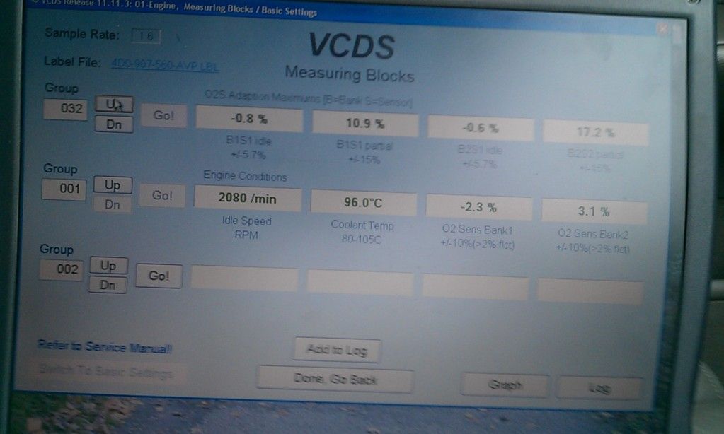

The one thing I've been watching is measuring block 32 which is 02S Adaption Maxims. From what I can see, Bank 2 running leaner than bank 1. See photo below.
I'm still investigating but if one bank is running leaner than the other, that would suggest that the air flow meter is not the problem...

Recheck measuring blocks after changing pump as the difference is a bit high between banks -08 .. +10.9% giving total 11.7%. IIRC absolute value must be within -12.5..+12.5% but difference between banks no more then 6% on A8 and 4% on S8 engines
