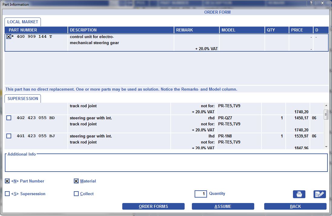

Just opened up a VCDS scan from a face lift car - they have an additional module for the electronic power steering
Address 44: Steering Assist (J500)
Part No SW: 4G0 909 144 T
My pre-facelift doesn't have that module.
The other (slightly more useful, maybe) feature with the face lift is the "Parking Assist" which can park your car for you - all be it in a dim-witted way that will leave you embarrassed to get out afterwards (lot's more shunting backwards and forwards than it takes if you can just reverse yourself).

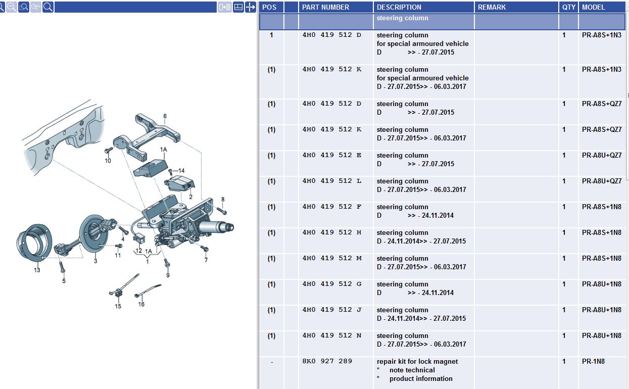

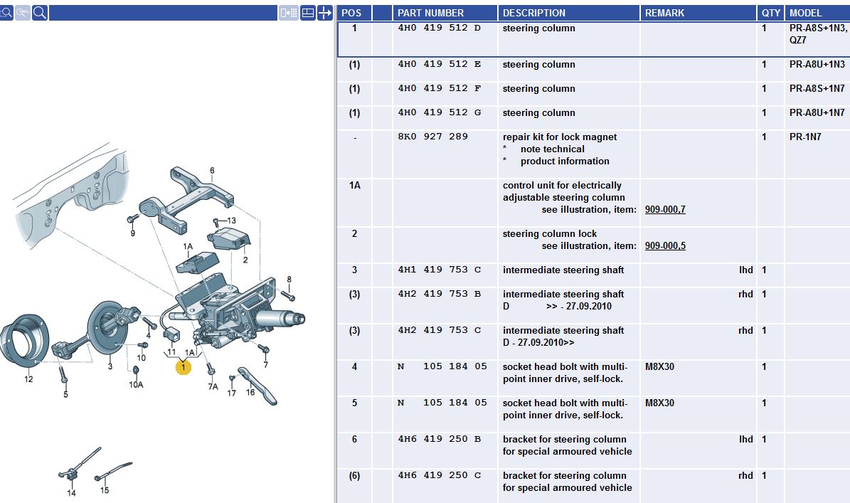

Old 3rd February 2017, 09:18 AM
Here are the PF and FL columns and ECUs.
PF - 2011 D4
Steering column
ECU
FL - 2016 D4
ECU
ID:	15531   Click image for larger version
Name:	pf ster ecu.JPG
ID:	15532   Click image for larger version
ID:	15533   Click image for larger version
Name:	fl ster ecu.JPG
Old 3rd February 2017, 09:20 AM
Address 44 part number and price
Old 3rd February 2017, 10:20 AM
Join Date: Jul 2010
Posts: 1,317
I'm sure you have already seen this:
https://www.kufatec.co.uk/shop/en/au...ion-audi-a8-4h
Only suitable for facelift cars (model year 2014)
I suspect that there is a difference in the column at least, not sure what the PR code is for Active Lane Assistance? 1N8 maybe?
