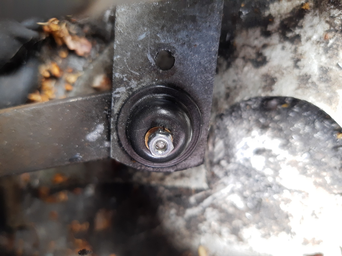

After a quick clear of the windscreen recently, my wipers stopped abruptly - pointing upwards, presumably paying homage to DTM cars. I opened the bonnet and saw that the lower link had popped off the top link. A quick search online revealed just one wiper linkage set and that was in Lithuania, and of course, it was left-hand drive. A call to Maria at A8Parts and it was established that there was no current stock. Yikes.
I called a friend who's pretty handy with mechanical things and we knocked up a Heath Robinson affair by drilling a 3mm hole through both the domed cap on the lower arm and into the metal lump on the top arm while the two items were linked in place. Inserted an M3 bolt from the bottom with washer, another in the middle and then one on the top which was then tightened enough to ensure it retained the top part without binding. A second nut was used to lock it, along with a dab of superglue as we had no Loctite. It all seems to work beautifully.
Ideally I'd like to replace the whole thing but that depends [a] on the availability of spare and [b] the condition of said spares. I'm going to monitor the situation over the coming days/weeks and I'll have a spare kit in the car in case it snaps or something. If it does, then I'll have to drill it again to take an M4 bolt - and you can get M4 nyloc nuts too.

Old 10th May 2021, 08:09 AM
A common problem, and a fairly common solution. The cause is usually the chromed steel ball losing its chrome and going rusty which then grinds away the inside of the plastic bushing. New bushings are available, but if the ball is worn out they won't help much.
The other cause is the wiper spindles seizing up in the bushings because the rain has washed all the grease out. The extra force needed to move them tends to escape at the weakest point, that being the plastic joint.
There is a design flaw in the plastic caps that go over the wiper spindles, in that the hole in the top is such that it allows rain water to pool on the top of the spindle, when then seeps in to the spindle and washes out the grease, then makes it all go rusty and seize up. I've been printing replacement caps which are a tighter fit to keep the water out, but they're only really useful once the mechanism has been apart and re-greased. Quite often the spindles are irreparably worn as well though, so there's not much that can be done at that point. If the spindles are still ok, the bushings they run in can be replaced, although this is a non-trivial task.
I've been meaning to re-engineer this with rose joints for some time now but haven't got round to it. Ideally I'd like to find a replacement for the spindles as well but thats proving tricky. The mechanism for the centre wiper is a tad complicated and not very easy to replicate though.
