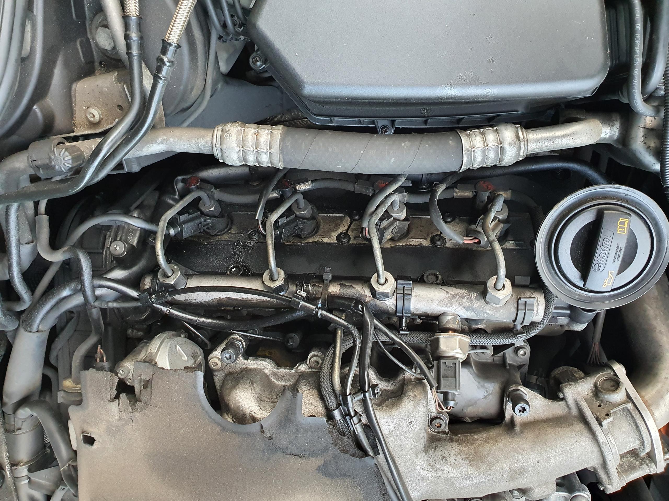

Perhaps a picture might help? I think it's not leaking at throthle body, probably it's leaking just above swirl flaps.

It's hard to make out, I'd be checking the base of the plastic inlet manifold where it meets the block see if any leakage from there, I know these plastic manifolds can easily crack at the screw fixings if over torqued , I've done it myself before. Or could be gasket. There are crankcase breathers but there near the exhaust manifold on side of block, you'll have to do a bit of detective work I think to find the issue.

Great tip, I'll put my Sherlock hat
Do you by any chance know what is the correct torque so I don't overtighten when reassembling?

I'm not sure on exact torqing from memory might be 20nm, theres a document floating about on here somewhere that has all maintenance instructions

M6 usually 10Nm, M8 20-22Nm.
Have you tried cleaning off all the mess and then watching to see where the fresh oil appears?
