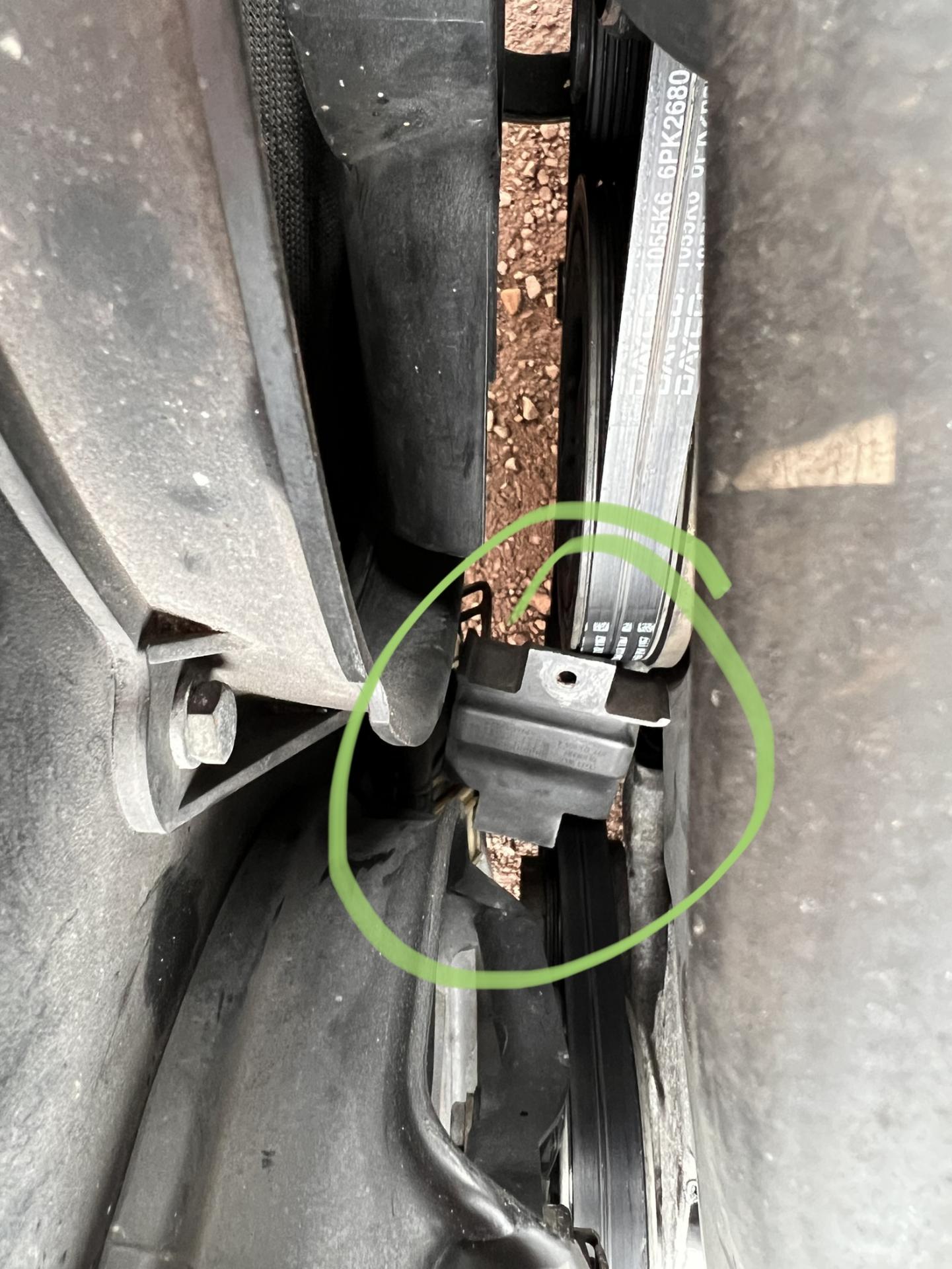

So update, my local garage I use has really ****ed me off this time.
Put car in for service and asked them to look at this at same time…
Instead of actually looking at what was cause they’ve just taken my inexperienced suggestion that it was maybe aux belt and replaced it.
My mobile mechanic guy had had a quick look and thought possibly power steering related.
Needless to say still whining although it’s a bit different to what I was experiencing before.
Looking under bonnet I found a clamp that had sheared off (fresh metal for the bolt head) and was left sitting on the aux belt, and looking in today I notice one of the pipes the clamp was holding back is now touching the fan….

This wasn’t there before so could only have happened when I’m for service and when they’ve fitted the aux belt (trying to remove clamp to get access for belt.).
The pipe in pic isn’t the one touching, but one underneath this.

Old 11th April 2023, 08:37 PM
That nut usually snaps off the thread these days. I cut the nut off to save the thread. Unfortunately that belt cover is non-trivial to get off to repair it, but the broken stud can be drilled out and replaced. For now, best to just cable tie the hoses in place.
