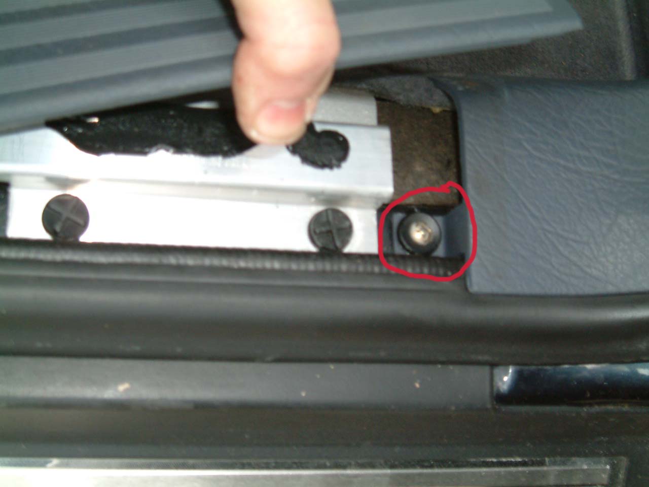

  1. With a flat screwdriver prise trim section off from the base of the rear floor trim to reveal screw circled in pic 1. There is some adhesive underneath so a little force is required. It will click when released.
  2. Undo screw, note these seem weird screws with a version of a rawl plug embedded in the hole. That needs to come out as well!!!

  4. Remove B pillar trim; you'll need to unplug the alarm interior sensor button (if fitted) and the bulb for the rear vent control. This takes a little bit of a struggle.
  5. Remove Mirror ECU (pic 2) by undoing the two 10 mm bolts securing it, remove the plug (there is a black retaining clip here) and swap the unit round and simply put everything back.
Simple and easy. I took time to check the bulb wasn't blown at this point and the trim went back easy enough but that didn't fix everything..
