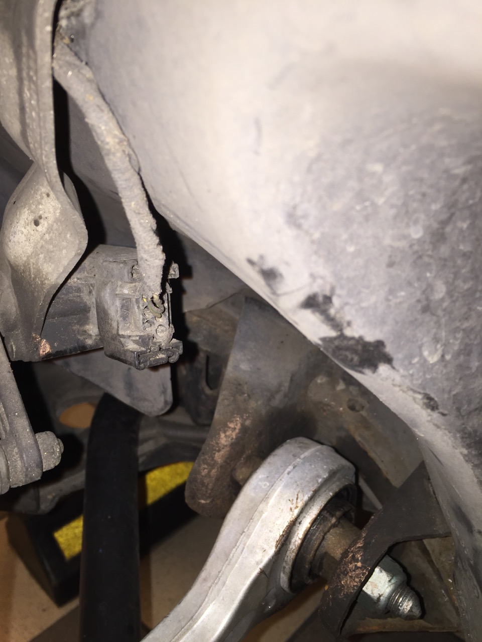

In my personal opinion Audi OEM wiring of xenon range control sensors is inadequate for what I expect to find **under** the car.

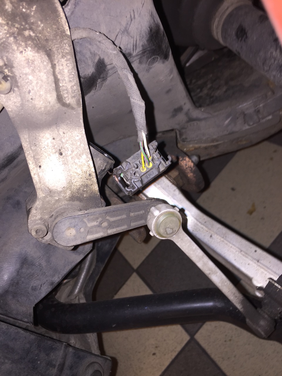

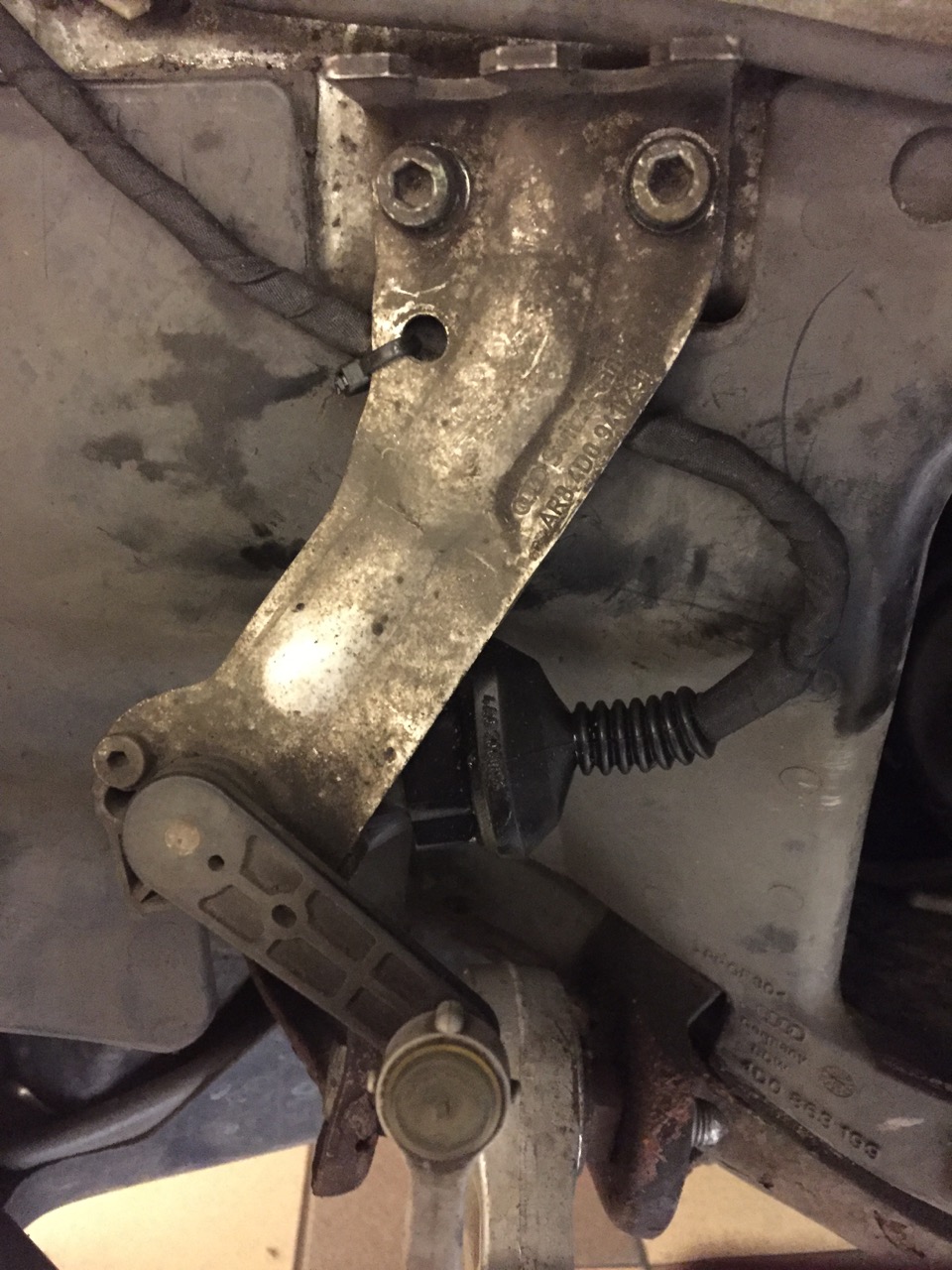

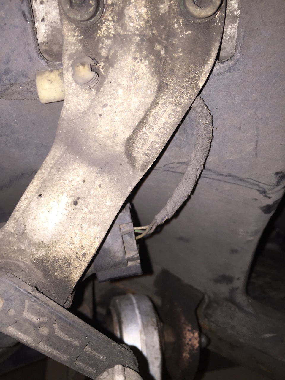

Here's how existing wiring looks on my car:
Front:
Rear:
Attempt to remove the connector will result in broken connector since old plastic is so brittle:

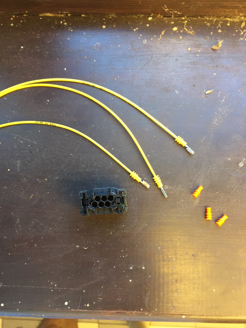

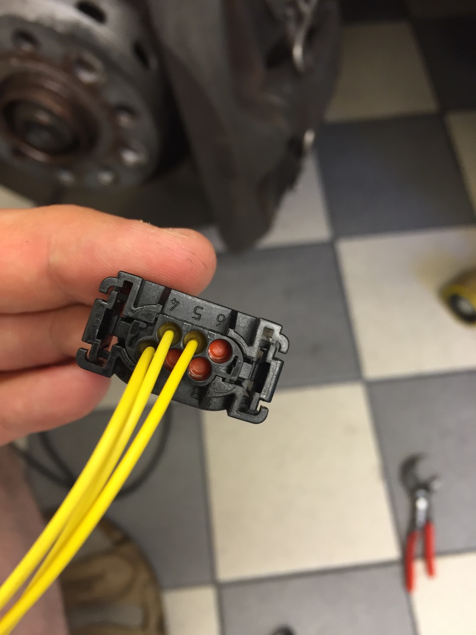

Since repair wires will be crimped from both sides you cut them in half so you will have 3 crimped ends per connector. Then dress the wires with yellow seals as shown on picture:
Then slide green latches on connector and place wires into pins 1, 4 and 5 until they click. Unused cavities seal with orange plugs. Slide green latches back in place.
Then you need to cut off old connector and solder each of 3 wires one by one. Then insulate the area. I use 3M series super 88 insulation tape and then Certoplast cloth tape. No pictures, sorry. But this is a very basic wiring skill.

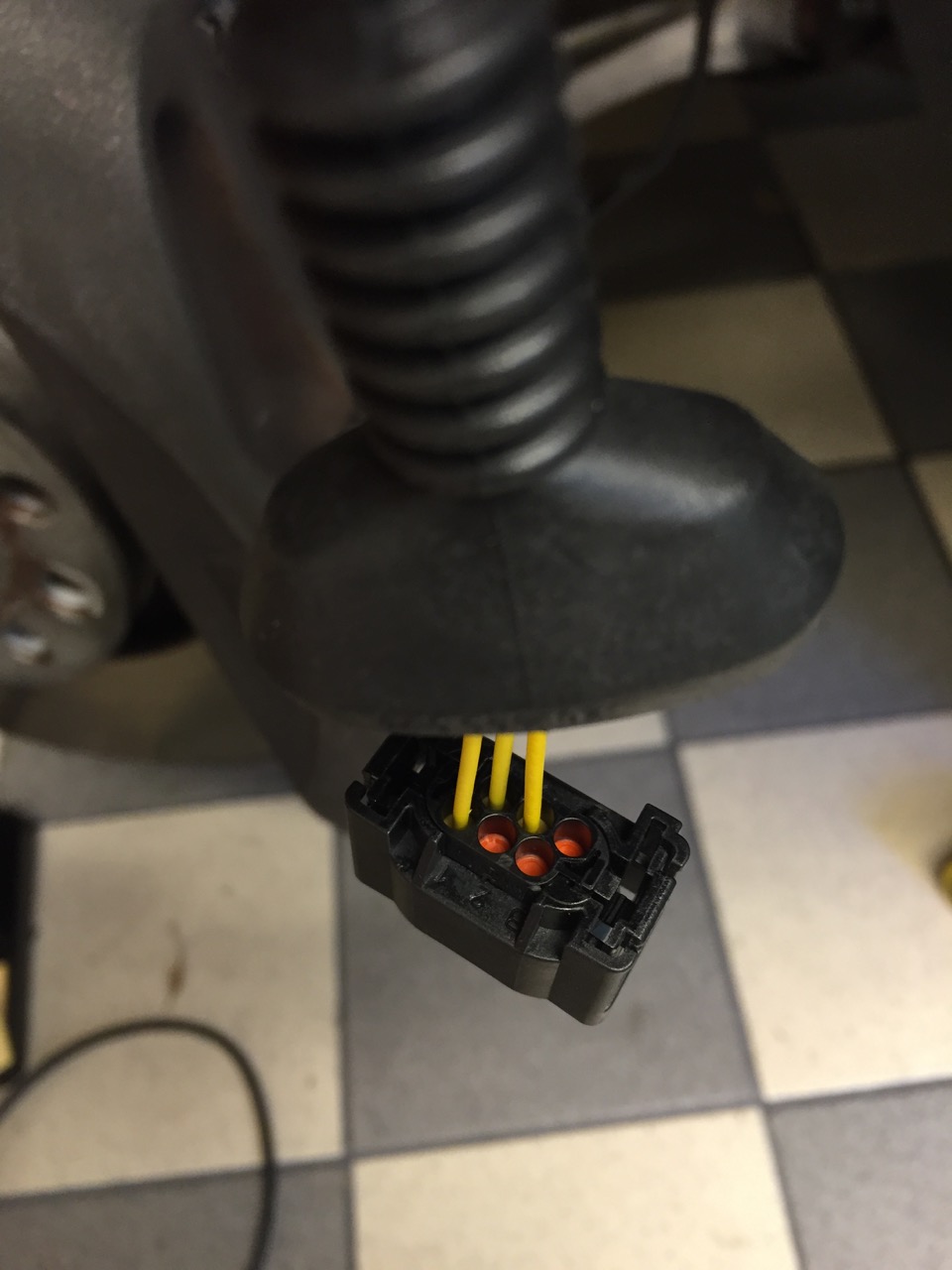

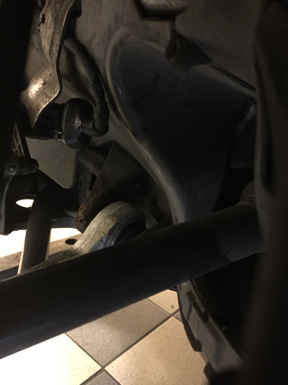

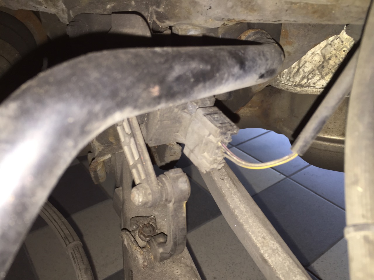

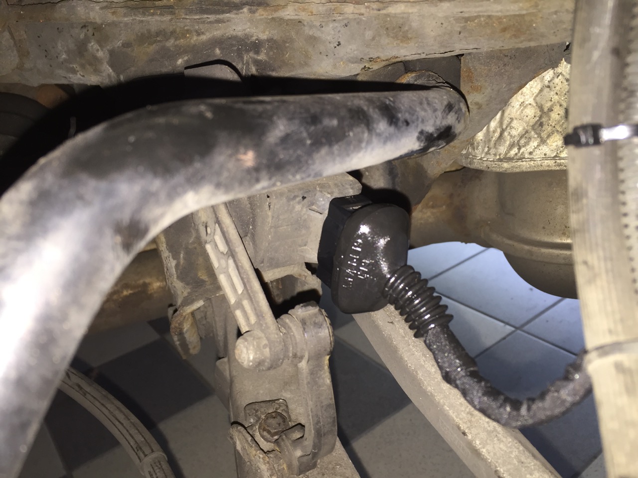

End result front:
End result rear:
And front again:
