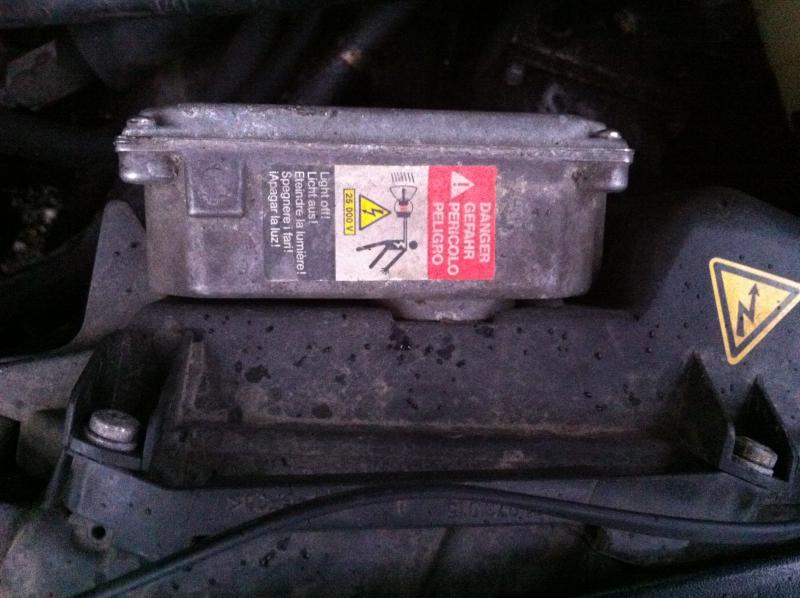

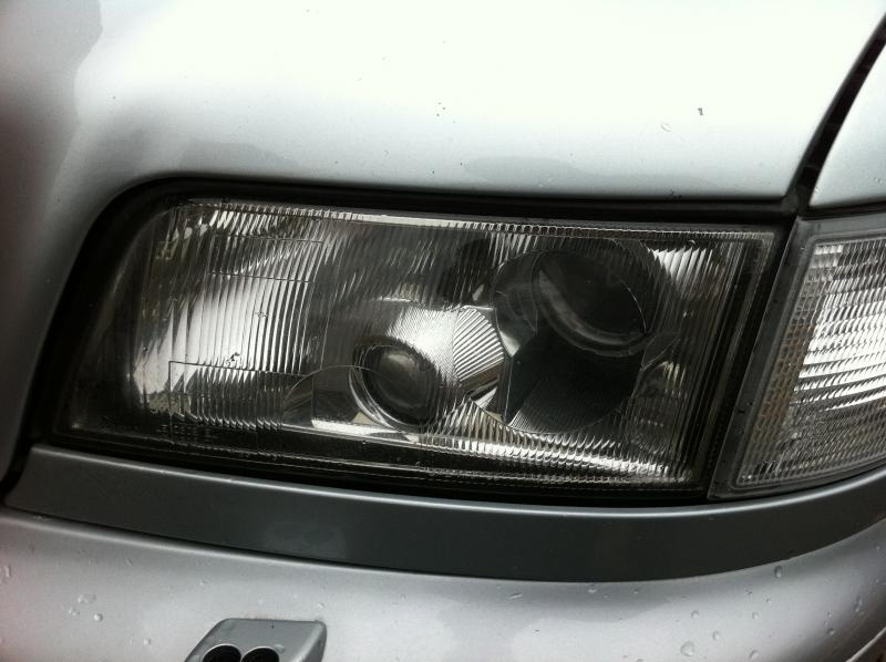

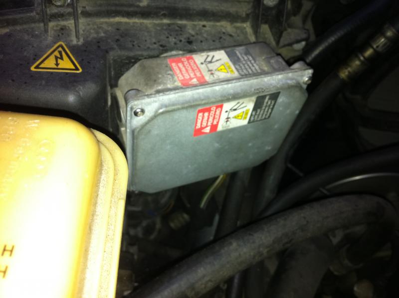

Thanks for the help. Here are some pics of the lights.
ID:	1537   Click image for larger version
ID:	1538   Click image for larger version

Certainly looks like factory Xenons.. Do you have the adjuster screws on the top?
