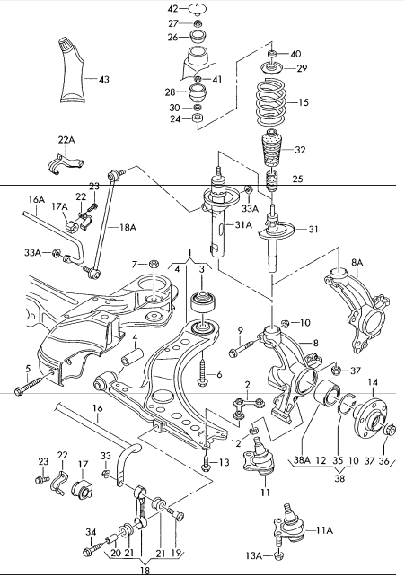

Can anyone with such a tool get me some piccies of the front end please? I'm interested in a bracket that attaches the front OSF wing to the inner wing.
I have a CAT C crashed one one these i'm putting back on the road (hopefully)
Anyhelp with piccies and torque settings for suspension part would be gratefully recieved

Old 28th August 2012, 03:51 PM
Ah yeah the year, yo were spot on near enough mate, 51 plate.
Also that is the very bracket i will give TPS a call.
Would it be a real pain for you to add the picies of the front suspension too?
Wife has had a bit of a prang
Old 28th August 2012, 04:18 PM
Posts: 3,854

Thanks for the piccies Ainars going to be very handy when it comes to putting it all back together.

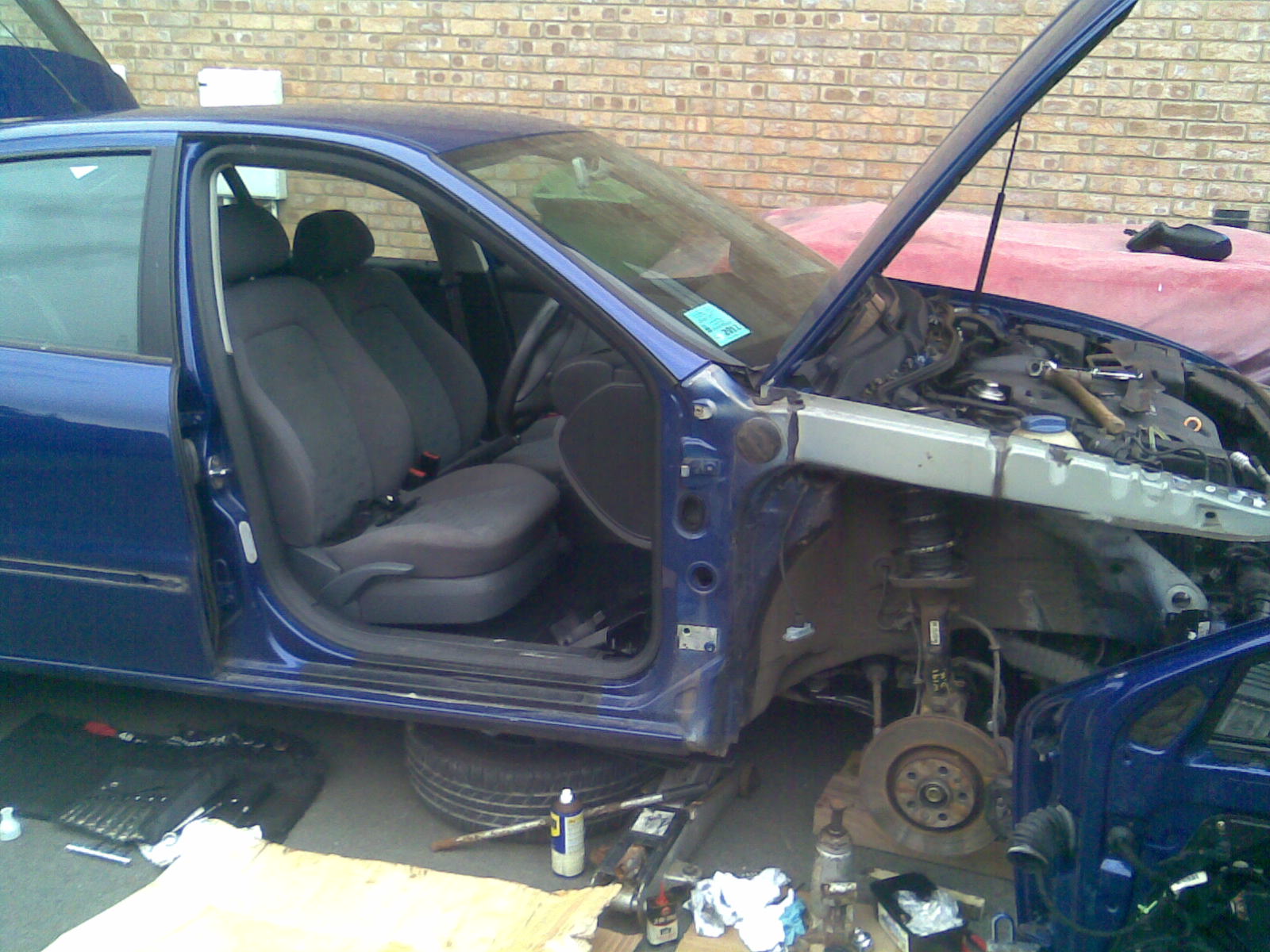

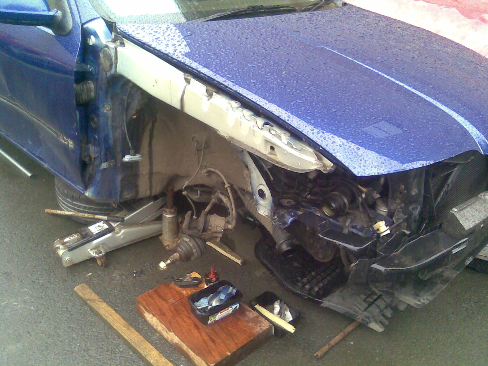

Old 7th September 2012, 08:49 AM
Well here it is just after the prang
and the strip down begins, as you can see from the first pic the suspension is bent, it's actually the hub casting thats bent.
suspension replaced just door, wing and intercooler to go (i think) quite supprised how heavy the doors are, that or i'm becoming a fairy (thought i'd get that in before CTL )
Big thanks to Ainars for the piccies that really helped mate
