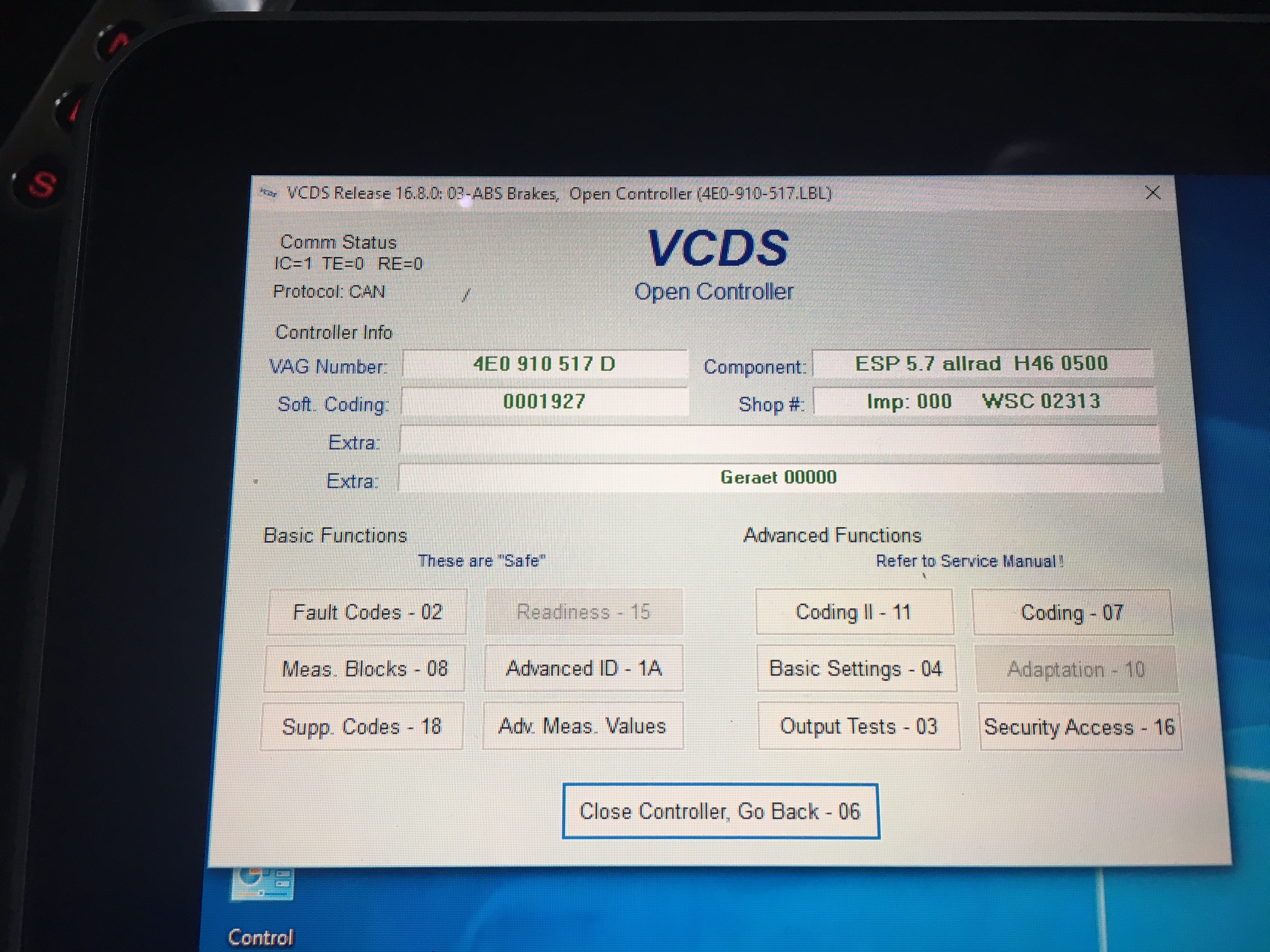

It has been like that since, originally I've scanned the [03] ABS ECU for faults, but there was non. Then in 1781cc's thread it has been suggested to also look in [53] Parking Brake ECU. It took a good week or so for the fault to come back (I didn't drive much recently anyway), but it finally did.
For a second today I thought this could be related to ESP because the fault came on after getting the rear end a bit happy which happened quiet often in past few weeks due to wet conditions, but I've ruled that out on basis that fault was coming on even on motorways driving steady and in dry conditions in October and November.
I did scan both ECUs while fault was still flashing on the dash and there was nothing, absolutely no faults whatsoever.
See attached photos.
Any clue what this might be??
I haven't get to the stage of replacing the EPB ECU yet as it was suggested few days ago.
Thanks guys
