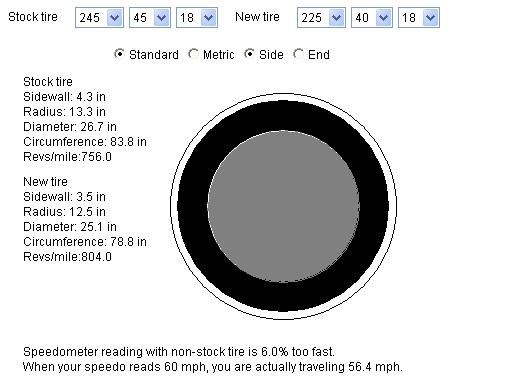

Are these ok to fit on the D2 with 18x8 RS4 reps?
Just thinking of a winter set.

You could put them on as long as all are the same size but not recommended, normal size for 18" is 245/45R18. 225/40/R18 would be 6% smaller this would result in higher speedo reading, better acceleration, worse fuel economy and lower car plus I do not think they would look any good. For winter wheels narrower are better but You should look for higher not lower profile tyres. 225/50R18 would be good choice, maybe even 225/55R18 for increased ground clearance in winter but that would give lower speedo reading.
Old 28th May 2011, 04:09 PM
hi steve, the correct size for an 18 inch wheel is 245 x 45 x 18
if you fit 225 x 40 x 18's then you would need to fit the same all around or the quattro wont cope with the difference. also your speedo will read 6% faster than youre actually doing which is quite a bit (it will say 60mph at 56.4mph)

60 might be bit too much and speedo would read 7.3% slower

225 x 50 x 18 will give you closest match to the 245 x 45 x 18
its only 0.7% too slow and very close rolling radius wise
