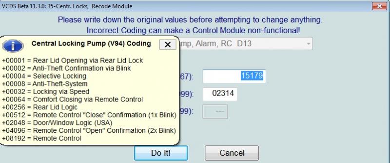

When you go into the coding section and hover over the box VCDS throws up a pop up with all the coding you may need.
It basically gives a unique number for each attribute. All you do is add all the numbers for the facilities you want together and enter the result.
Old 12th July 2011, 06:46 AM
Posts: 3,879
Here is a screen shot.

exelent i will have a play with that and see how i get on thanks Guy's
