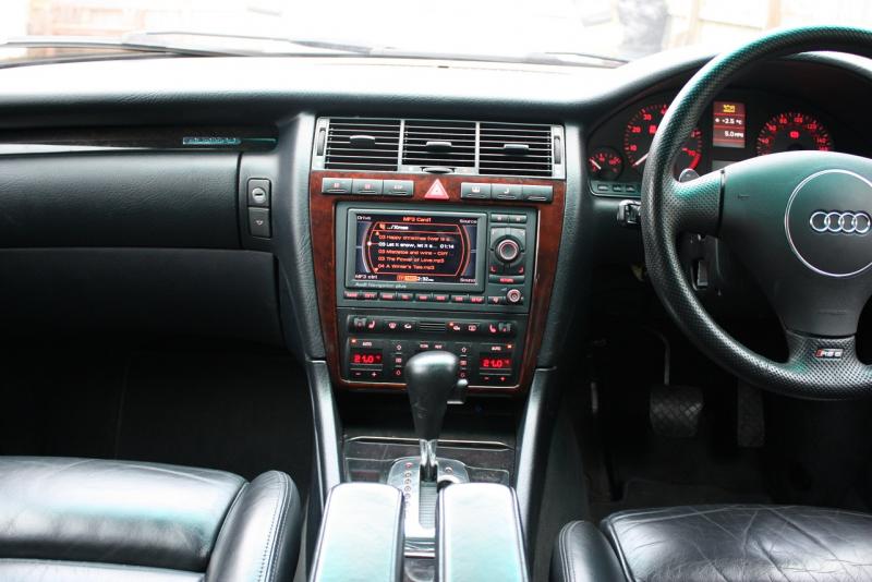

In short, no, I dont think its possible. Preface didnt have canbus, which causes the RNS-E issues like not knowing the ignition is on, so it keeps turning off etc (can be fudged though), but it also would normally use the infotainment canbus to talk to the DIS - Preface was a different standard, 3LB or something springs to mind, anyway, chances of success are virtually nill.
I had an RNS-E in a pre face S8, but the instrument cluster had been changed for a facelift one - That, believe it or not isnt actually that hard. The majority of cables are a straight 1 to 1, and then the instrument cluster generates the canbus signals that are needed for the RNS-E, and I think it solves the problem with the FL climate module not working in a PF car too.
The only issue if I recall is that the oil level sensor is a Facelift thing, and without an input, the DIS of the facelift cluster permanently displays a warning symbol, but this can be fudged to go away.....
