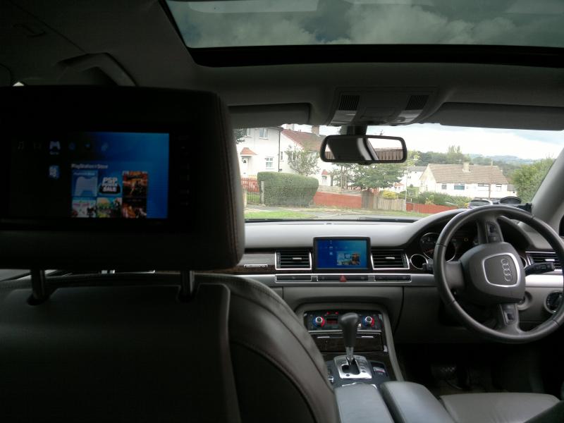

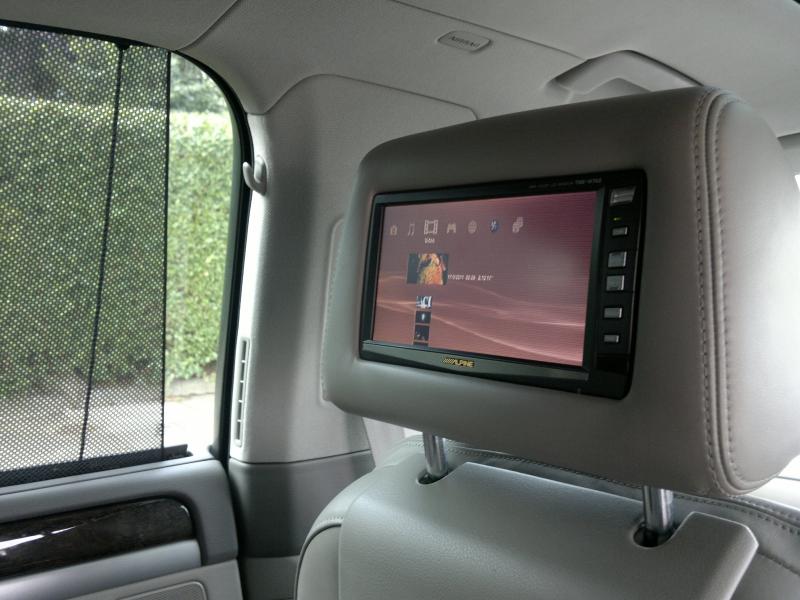

The next stage of my playstation project is done.
1. Bought new 320gig slimline PS3
2. Bought spare power lead, AV lead
3. Bought 1m x 50mm velcro strip. As there is no vents on the bottom then i will just velcro it down in the boot.
4. Just waiting for new 500w( 1000w max) inverter to arrive from ebay.
Used power lead from house just to check if all is working ok in the car. Will wire all up when inverter arrives.
Once done i will be able to play games, play blue-ray films and be able to store over 300gig of music and films whenever i want. It will also be easy removable as it will only be fixed with velcro
