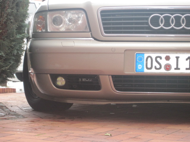

P.S. I like yellow colour of your foglights. Did you put any specific bulbs there?

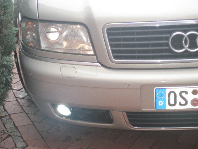

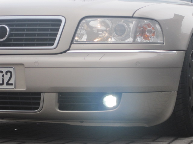

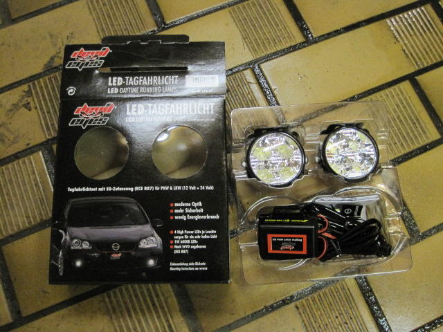

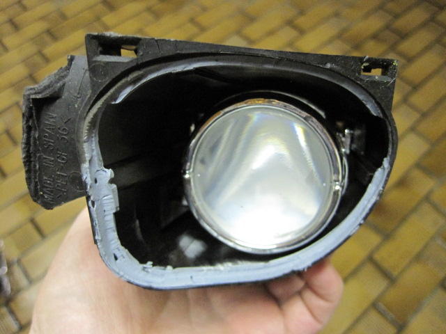

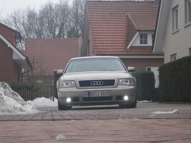

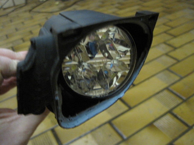

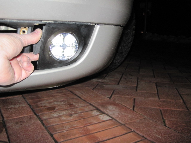

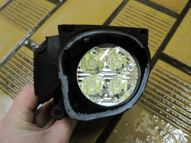

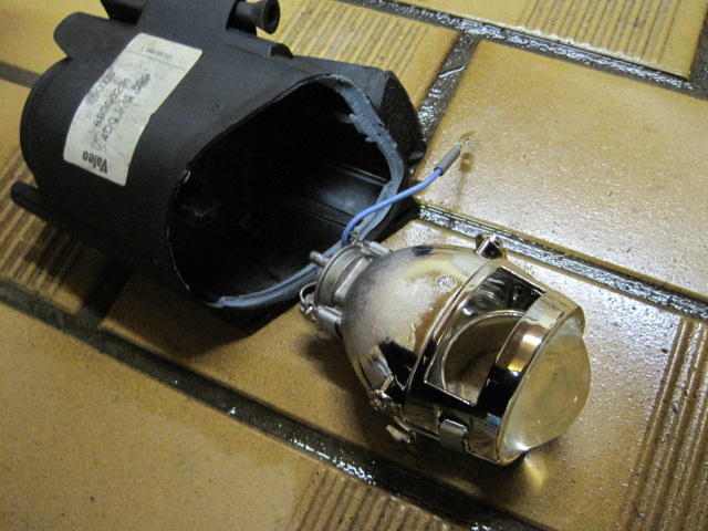

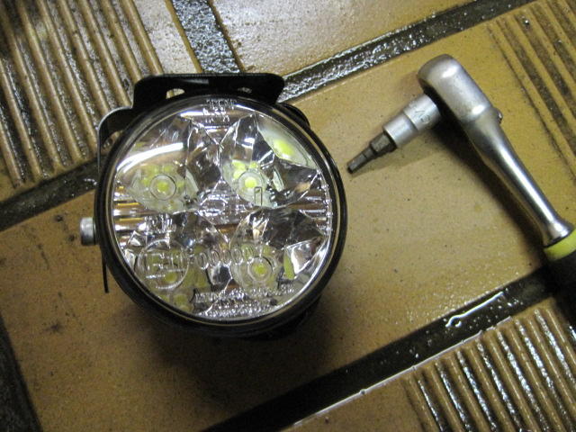

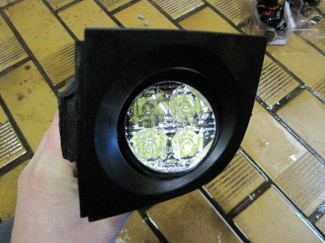

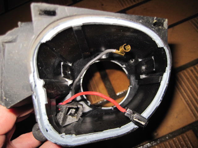

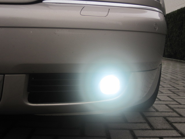

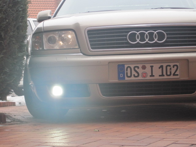

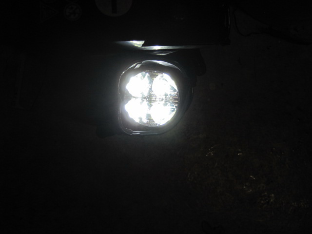

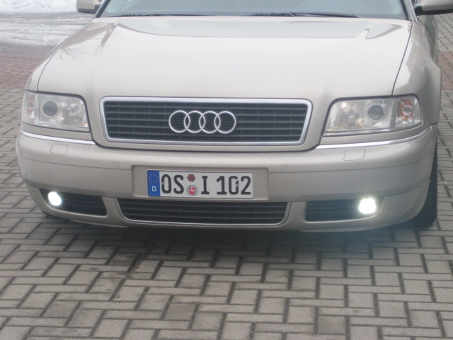

One of the guys in Germany converted his foglights to LED DRL's using the conventional fog lights which looked really OEM - the DRL's are called "devils eyes" - link HERE I think it looks great.

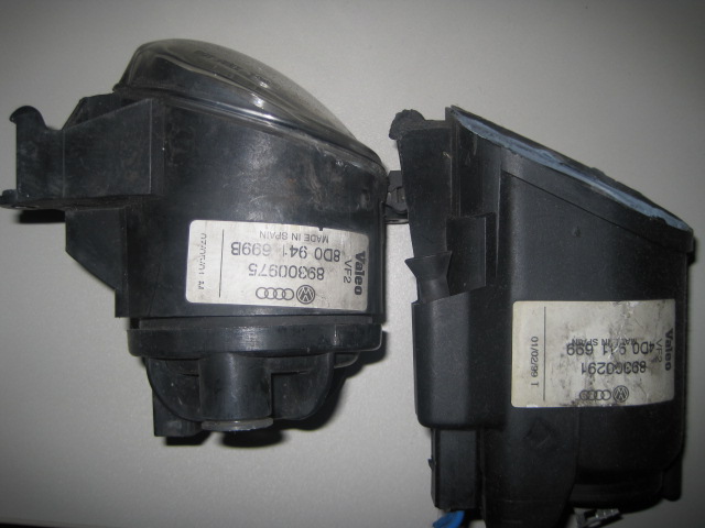

Yes thats the later one Sergey - in fact there are even two versions of the earlier sealed fog light unit (probably PF and Early FL) - I have the Early FL version on mine but still with the split grilles

Audi OEM part numbers: 8D0941699B / 8D0941700B
Can be ordered from Valeo too. Part numbers: 087544 / 087545
These fog light come with H7 bulb and here's how they look like:
http://www.karosserieteileshop24.de/...01::60062.html
They were installed on late A8 D2s and A4 B5s.
I'm not sure, but maybe you'll have to buy new grills (non-split ones) and new lower bumper skirt if you want to retrofit them to older A8 D2. This need to be investigated with ETKA.
There's also Hella's kit on the market that should fit tip top. Hella is usually higher quality than Valeo, which Audi decided to use as OEM fog lamps supplier for D2 for some strange reason. Hella's part numbers: 1N0 010 845-011 / 1N0 010 845-021
