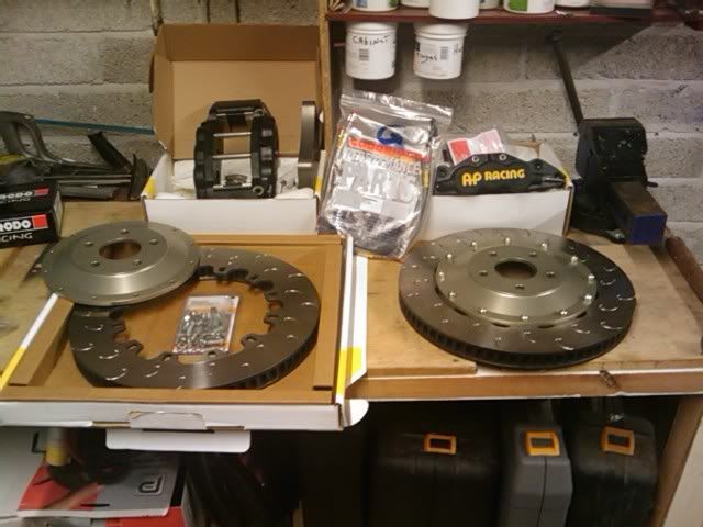

Now using the 5555 calliper and a floating 378mm disk, a mounting bracket was machined as were the Bells.
When they arrived they looked like this:-
The difference in disk size........

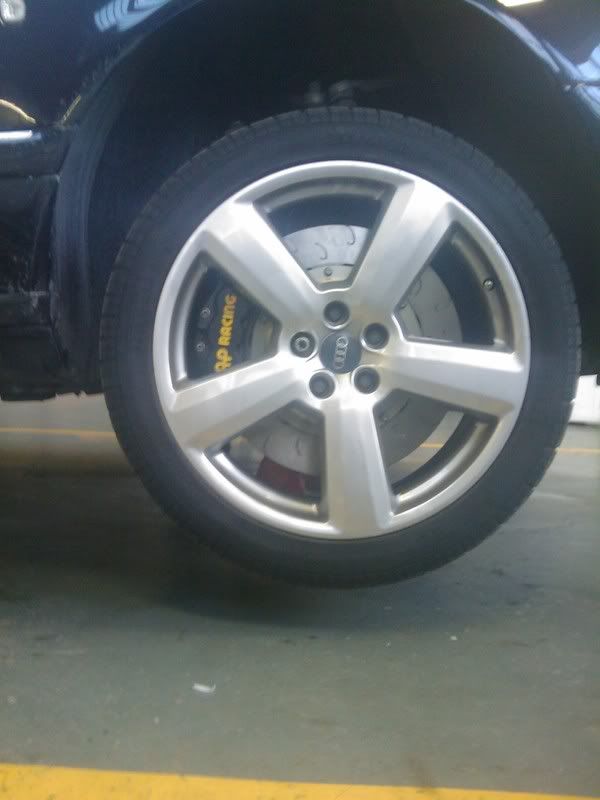

One fitted this is what I now have....
Detached retinas are now a possibility.
