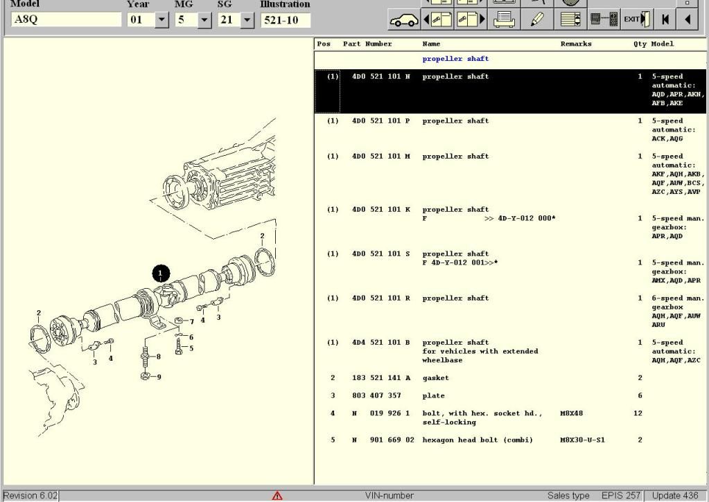

I noticed while I had the transmission out that the front CV joint on the propshaft was a little dry.
It didn't feel bad so I've re-greased it but I'd like to be able to change it at some point just to be sure.
Having looked on ETOS and ETKA, I can't see the CVs being listed separately from the propshaft.
Are they just stock VW driveshaft CV joints or is it a 'you gotta buy a new propshaft mate' scenario?

I have the same parts programs that TPS use and it doesn't show the CV joints separately so I'm presuming that you can't replace them separately as far as Audi are concerned.
I just wondered if anyone had one sitting around that they can look at and see if it's removable with any part numbers on etc?
