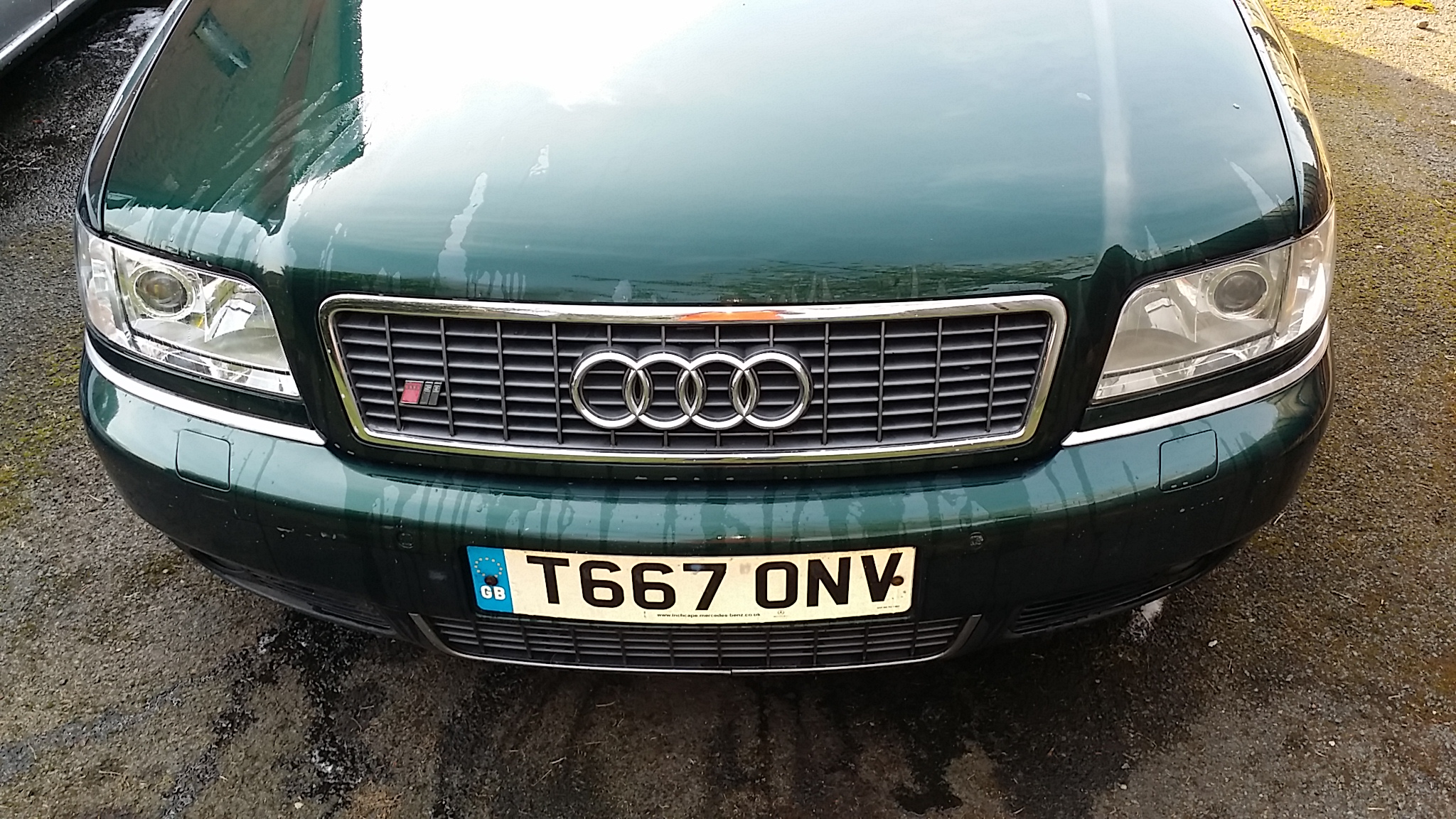

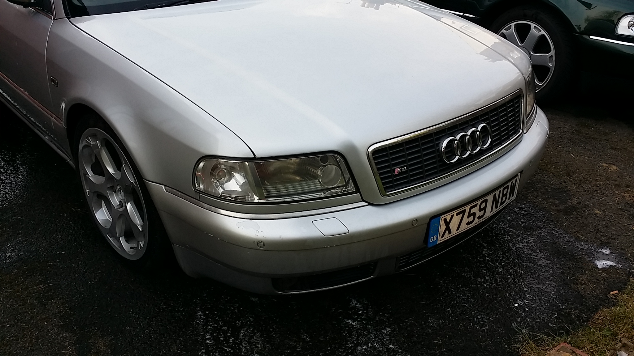

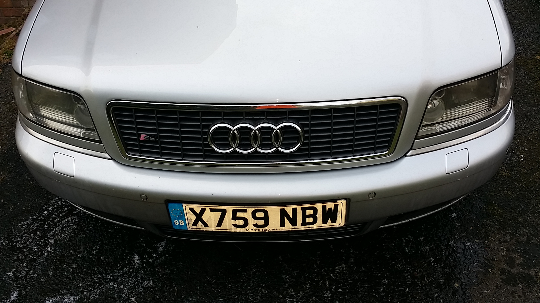

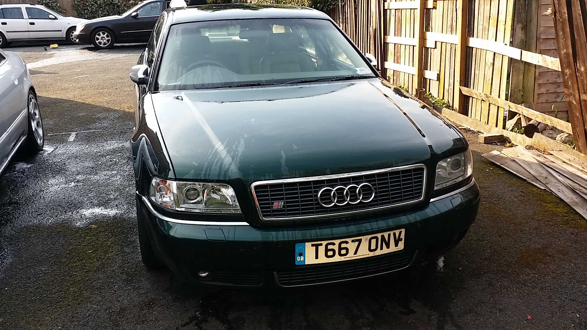

I own 2 S8 D2s Both facelifts, and for some reason my older 99 green S8 which has the earlier pre facelift badges has much nicer looking headlights than the newer 2000 model, both are xenons and while doing a search I can see that most D2 facelift S8s seem to have the older looking type which are on my silver 2000 S8, ive added some pics and would appreciate if anyone knows the differences. Thanks

The Silver one has the bi-xenon lights which are more desirable and as far as I'm aware 'better' lights to have.
Old 2nd April 2014, 06:48 PM
Yup.
The silver one 'lifts' the dipped beam xenon up vertically to give full beam.
The green one has a regular halogen for its main beam.
Bi-xenons are my preference, as xenon for full beam looks more modern, but some folk prefer the projector look of the standard xenons...
Old 2nd April 2014, 07:08 PM
mannyo mannyo is offline
Location: Blandford, Dorset
Posts: 1,974
The Bi-Xenon headlights (Silver) are also incredibly expensive to replace, around £900 a side when compared to the cheaper standard Xenon on the green car. Secondhand the Bi-Xenon very rarely come up for sale and when they do they sell very quickly because they are the ones to have. A8parts have a used one on ebay right now, almost £300 each.
