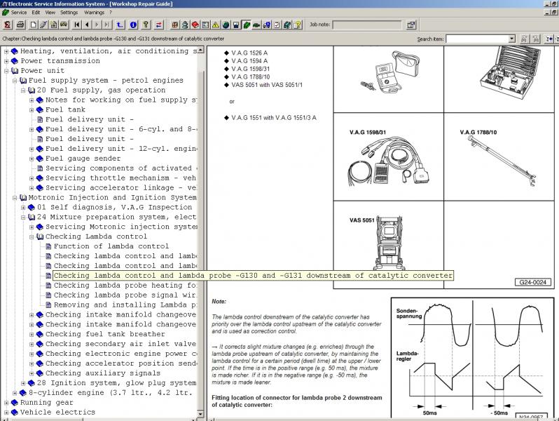

Also, I was looking up lambdas on Elsawin, there is a bizzare statement on there that seems to indicate that rear lambdas take priority over front lambdas? I hope I havent affected fuelling by removing the rear lambdas out of the flow of the pipe. Seems a bit crazy to me I thought only front lambdas affected fuelling? (unless I mis-interpreted the upstream-downstream terminology)
