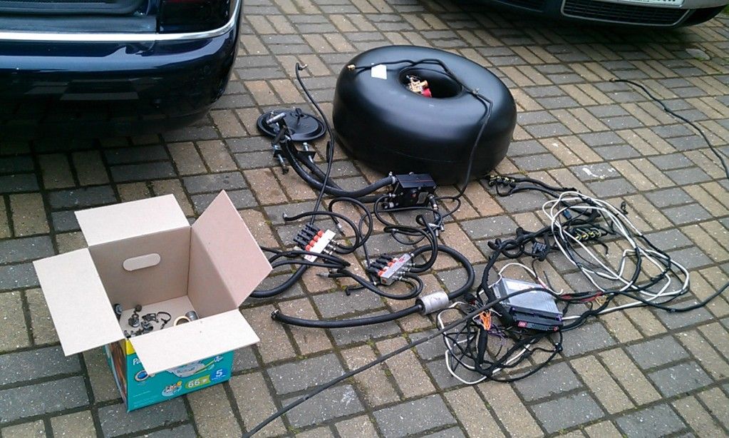

I just bought a BRC LPG kit from an Audi S8.
I was able to see the car running, witness it switch over to LPG and back to petrol (at tickover as well as revving) and am happy that everything is functioning as it should.
It's a BRC Plug&Drive FLY SF system which is a Multipoint, ECU controlled LPG system.
Obviously, having seen it run and it having come off another Audi S8, I know that it will fit my car and work without having to worry about initial setup, tuning etc although I will be buying the software and lead to plug into it and read the ECU.
The one part about fitting this LPG kit which is of a concern to me is fitting the injectors to the inlet manifold.
Having removed them from the inlet manifold, it was obvious that they have been fitted without removing the manifold... i.e. whoever fitted it did not remove any aluminium swarf so it definitely went through the engine when it was next started up.
To me, this sounds nuts!!
Ok aluminium is soft and is less likely to do major damage to the valves, pistons or bores but I still hate the idea.
The biggest problem I have with doing this the proper way, is how to get to the swarf after you've finished drilling, tapping etc.
I have read in the Audi Tech sheet that the inlet manifold is not supposed to be taken to pieces.
Has anyone stripped one down? Any ideas why you can't take the top off?
The tank is a toroidal 70ltr tank so an effective filling capacity of 56 litres. Not as much as I'd like and I know that it's possible to get a 90 litre toroidal tank in there but it'll do for the moment.
Components include ECU, Tank, Vaporiser, Loom, BRC indicator (doubles as fuel level and manual overide button and current status indicator), Fuel Cut Off Valves, Fuel rails, injectors, fuel pipes (lots of them!), water pipes inc T-pieces (they T into the heater matrix circuit) for the Vaporiser and other bits which I'm sure I've forgotten to list.
Having removed the system myself, I found it interesting that the injector wiring actually gets cut into rather than just taking a feed from... i.e. the original injector wiring on the car gets cut, then the feed runs to the lpg injectors and then back to the Audi injectors. So... if the LPG injector goes down and loses continuity, you lose the feed to the petrol injector too. It's obviously meant to be this way as the LPG wiring has two sets of wires, orange and purple which are numbered. If they were ok to run just by using the injector feed as a trigger, they'd run an earth on one of the wires instead.
The Vaporiser runs a vacuum hose up to the fuel pressure regulator vacuum pipe so works in the same way as the Audi FI does in that respect.
I'll be monitoring fault codes on the VAG system very closely once this is up and running. Hopefully the same misfire detection will work when running on LPG as well as Petrol.
I will put the filler nozzle inside the fuel filler flap as I don't want to drill holes in the body or have ugly LPG fillers slapped on the bodywork anywhere.
I have to run some wiring to the tank for both the shut off valve and level sensor and this means removing some of the interior. Similarly, I'll have to remove some of the dash area to wire in the loom there and fit the Indicator etc.
As I'm running the car daily, I'll do this bit by bit and the last bit will probably be fitting the injectors to the manifold ( ).
I've seen other cars that run LPG bringing on the engine check light regularly due to the sensors being setup for petrol emission checks.
I've also read a bit about changing the spark plugs to run on LPG.. arguements seem to be both for and against this. More research to be done!
The last thing I'll say here is that I'm planning on running the LPG kit under the stock covers. I don't want ugly extra bits stuck on top. It's got to be neat.
