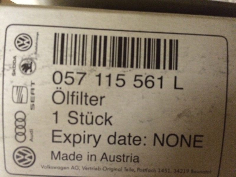

Easier just buying an original Audi filter from TPS or Audi, cost last September was £5.52 plus VAT
Thanks for your input and scan. This has indirectly led me to finding out that there ARE two different oil filters for this engine, with two Audi part numbers : 057 115 561 L/M.
Looking at online 'unofficial' VAG parts catalogues, I now find this change was introduced in MY 2008 [which would explain the original chassis numbers I quoted as the 'turnover point'- 4E_8_011500]. But I'm not sure how 2008 build cars would have chassis numbers only 8 greater than my November 2004 car.
However, it's confirmed that the '057 115 561 L' part is the right one for my car. Will be intersting to see if I can get Audi or VW to match that price quoted.
Thanks - Julian
