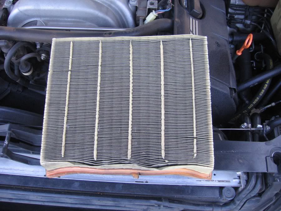

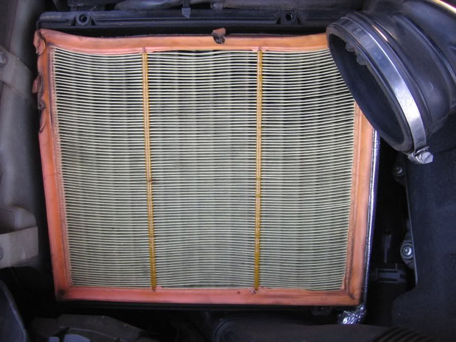

Got a bit of a shock when I checked the air Filter on the weekend...
Anybody Using something like a K&N Filter ???

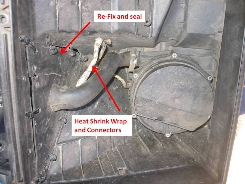

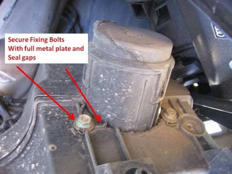

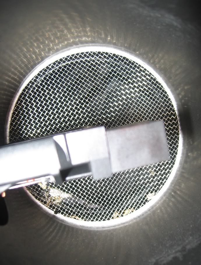

On the weekend I decided to tackle the Windscreen Washer that is not working and removed the Airbox to get to it (as per ELSA) only to find that
the only way to get it out is through the wheel arch... Hmmm
Needless to say I didn't get that far....but found a few other issues I need
to resolve.
I am getting to much dirt bypassing the filter and ending up on the screen just before the MAF. So I need to seal the Airbox up properly which requires sealing the Aftermarket SAI that is fitted....

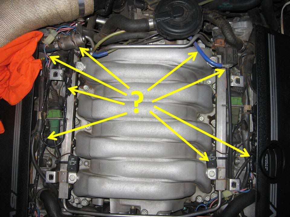

This brings me to a plea for a pic of the top of the Motor at the intake manifold with the Top Engine Cover removed.
I am trying to establish what are the aftermarket mods that have been installed that are all related to the SAI in the Airbox. I am trying to establish the purpose of this whole Mod.
I would really appreciate it if someone with a S8 D2 could post a Pic as requested above.

Old 6th September 2011, 03:38 PM
Posts: 5,166
Send a pic of exactly what area you want photographed and I'll get it done
Thanx Mate.......
If you could let me have a Pic similar to this then I can see if and what are
Aftermarket fittings....piping and wiring.
2002 S8 D2 F/L
