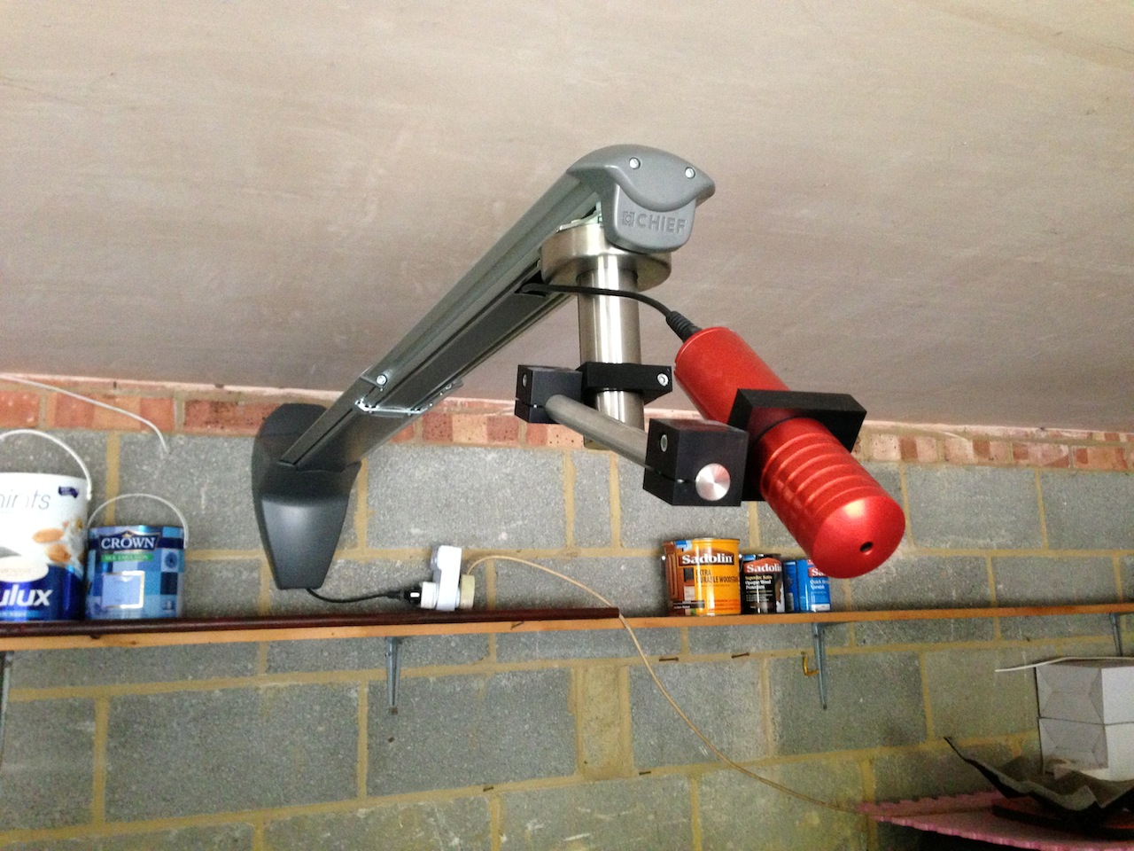

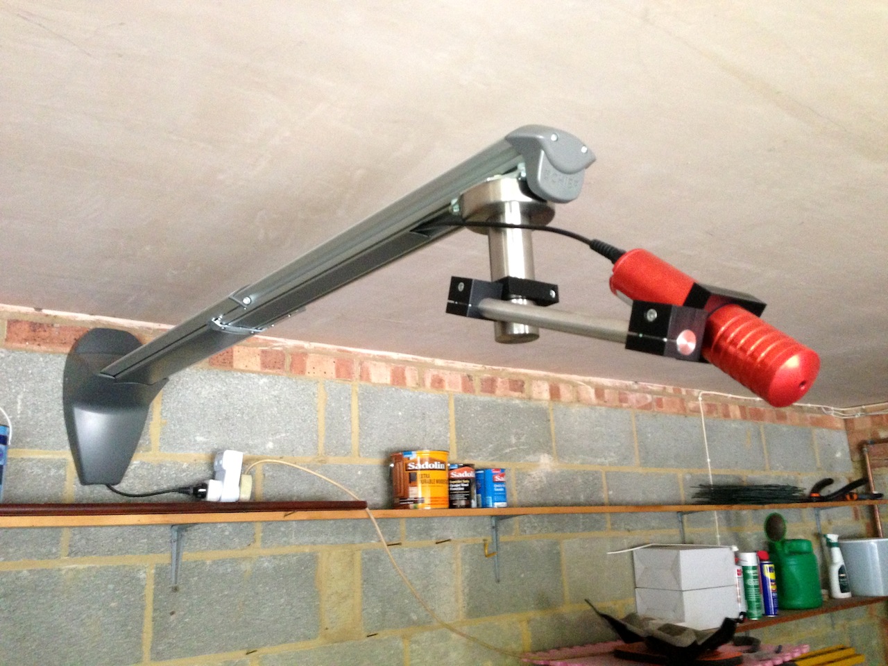

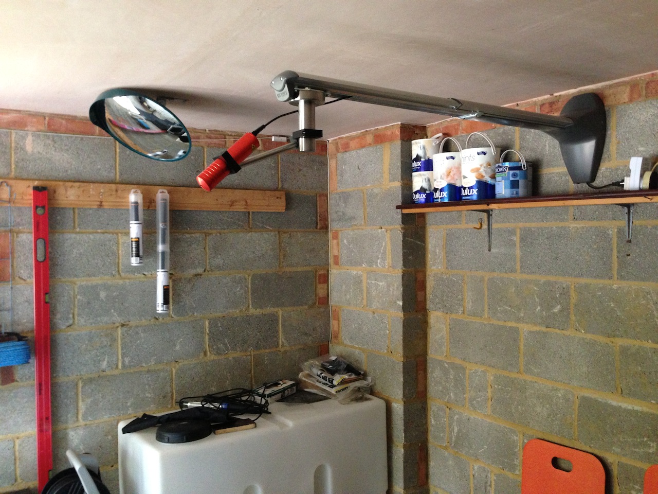

I have installed this thing in my garage on opposite wall to entrance doors.
In my opinion, this is essential thing for all A8 owners who have ordinary size UK garage.
Any ideas about purpose of this device?

Going from the yellow warning triangle on the device my guess would be that it is laser that marks dot or line so that you can line up car in the centre of garage.

Yes, this is industrial grade plane laser. It creates sharp plane of light which is aligned exactly in the middle of garage opening. Because standard garage doors in the UK are only 7" wide it is tricky (and dangerous) to park A8 in such garages.
Now driving into very tight garage opening is no problem at all. All I need to do is to align sharp line with climate control sun sensor, which is exactly in the middle of dashboard. laser is controlled remotely from button in a car. When I finish installation of new garage doors this laser will be switched on from doors operator automatically.

There are 3 components in this setup:
1. Boom, which is short throw projector mount manufactured by US company called Chief. Made in USA from aluminium
http://www.chiefmfg.com/Products/WM130AUS
http://accessories.euro.dell.com/sna...=baynoteSearch
2. Stainless steel floor mounted balustrade base element from UK company Elite Ballustrade Systems. Made in China from hi grade stainless steel.
http://www.elitebalustrade.com/floor...d-base-hd.html
3. 15mW 650nm industrial plane laser with two adjustable brackets and stainless steel rod in between. Special order. Made in Switzerland.
http://www.scitec.uk.com/lasers/idtlaser/pdf/idt5_e.pdf
