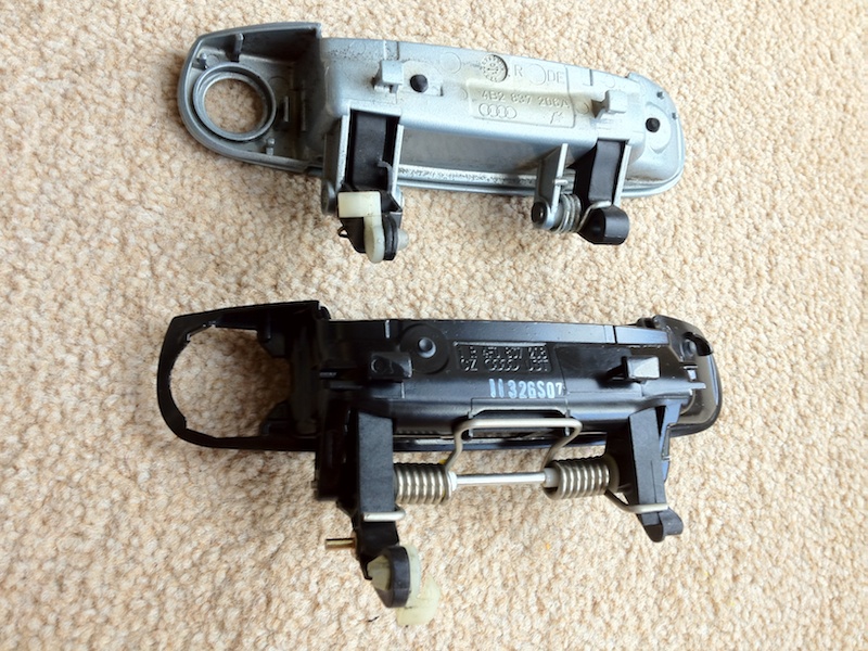

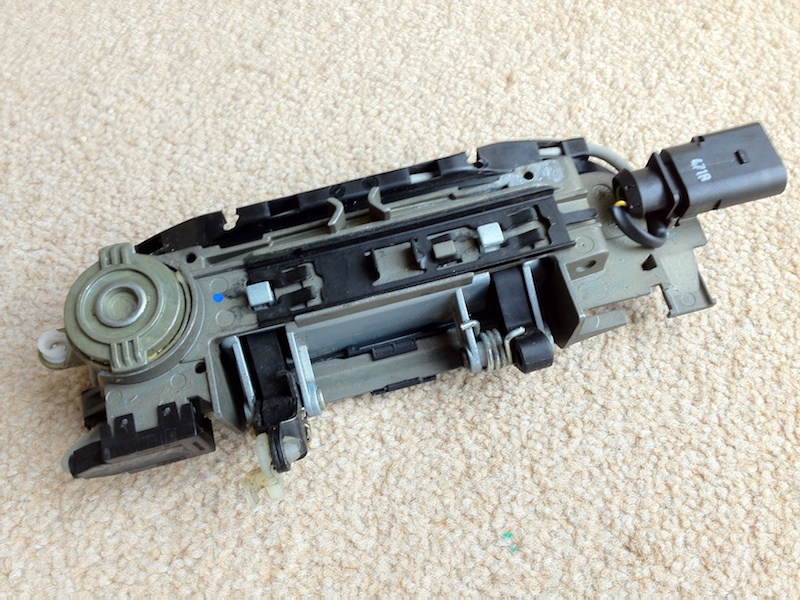

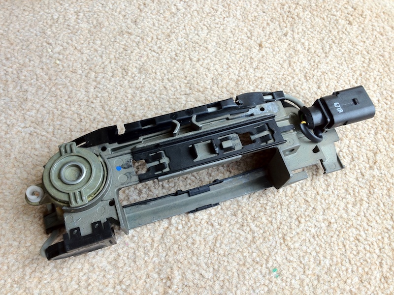

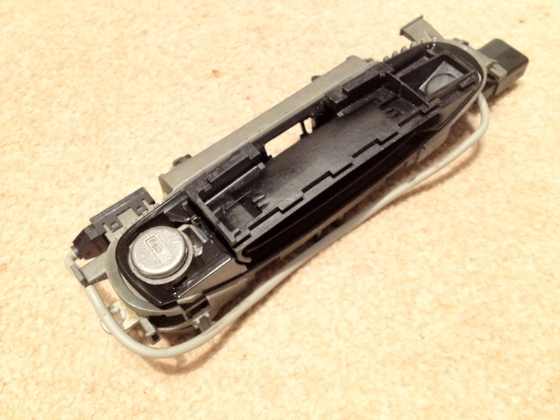

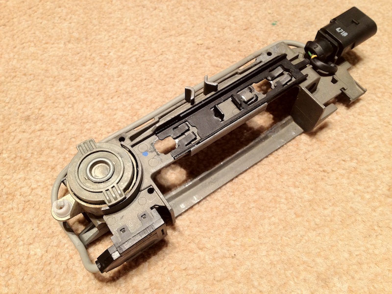

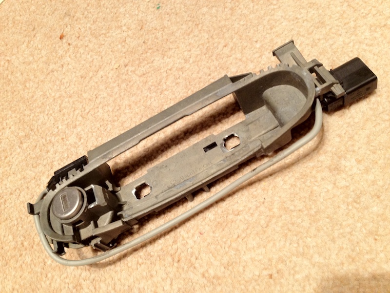

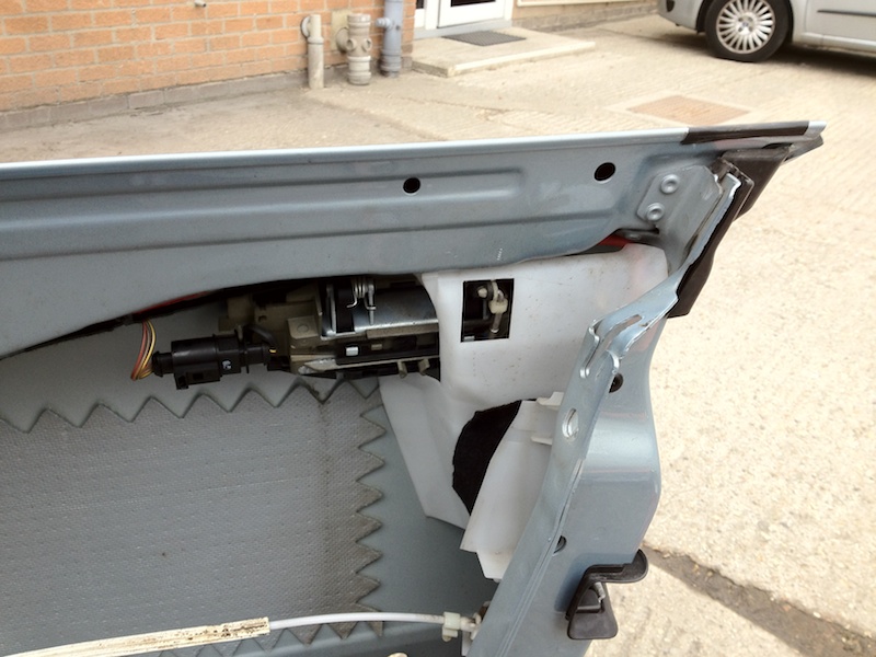

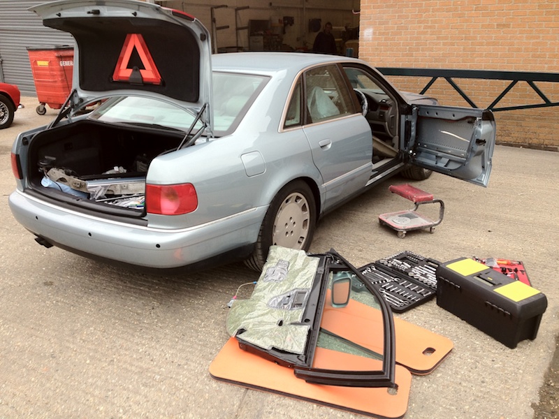

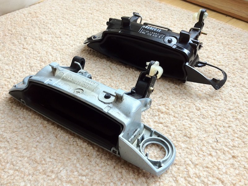

Pictures of the process for driver handle and how end result looks like:
1.
2.
3.
4.
5.
6.
7.
8.
9.
10.
