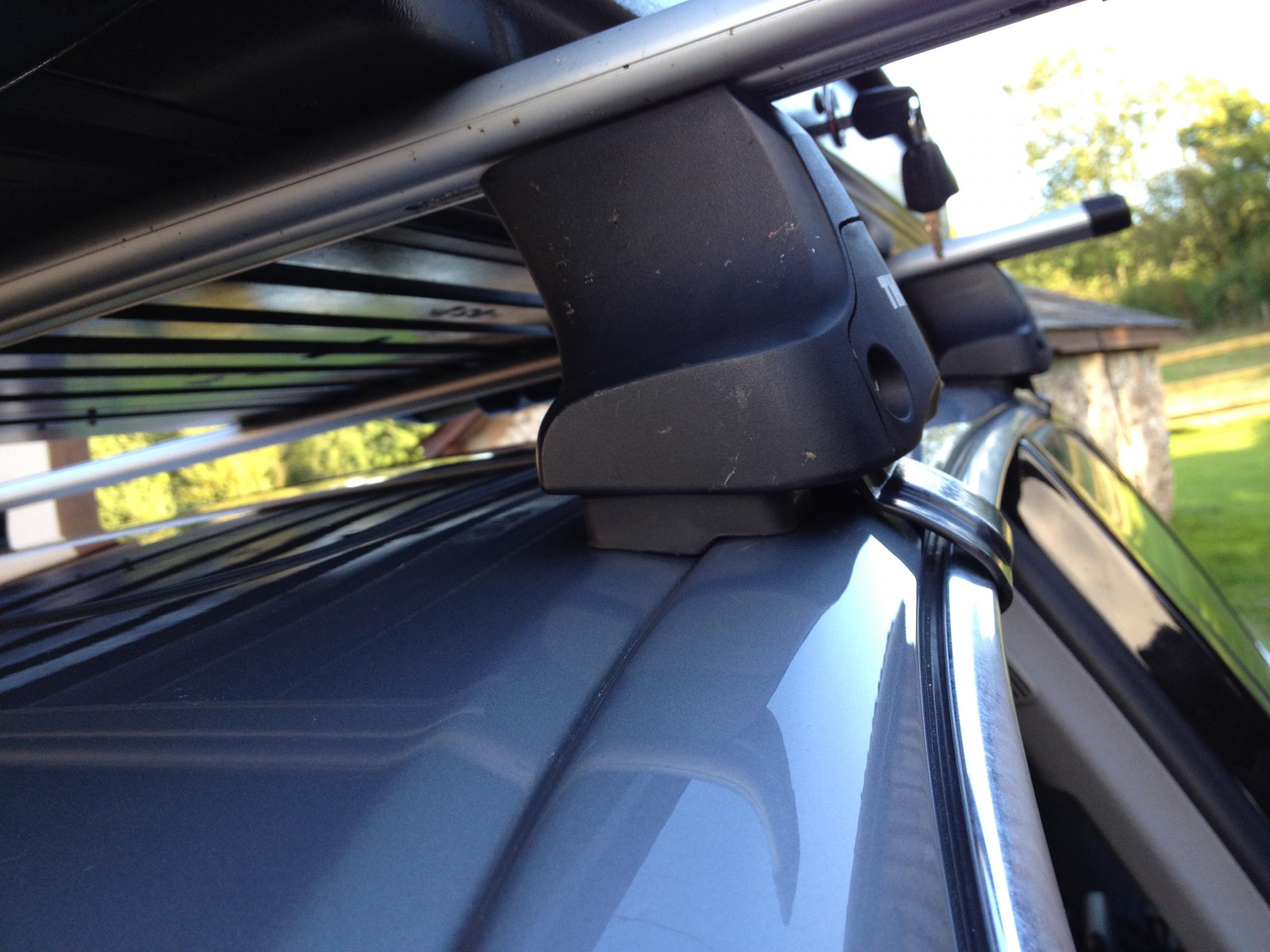

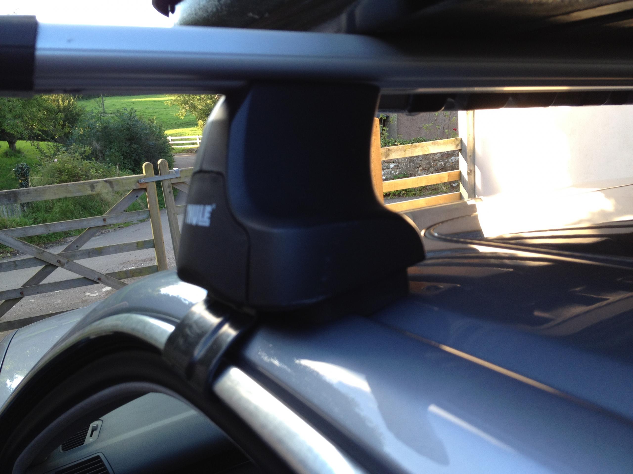

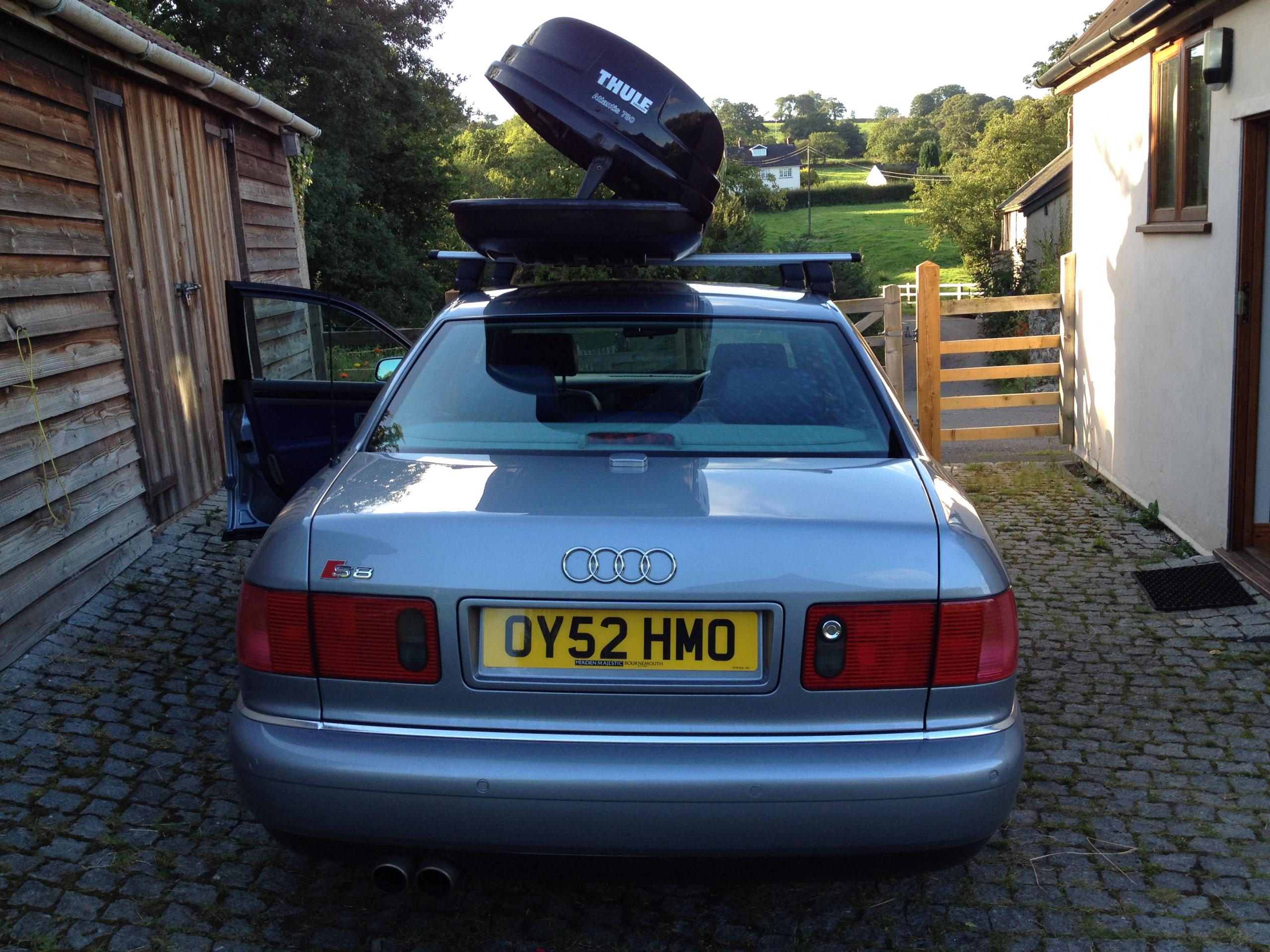

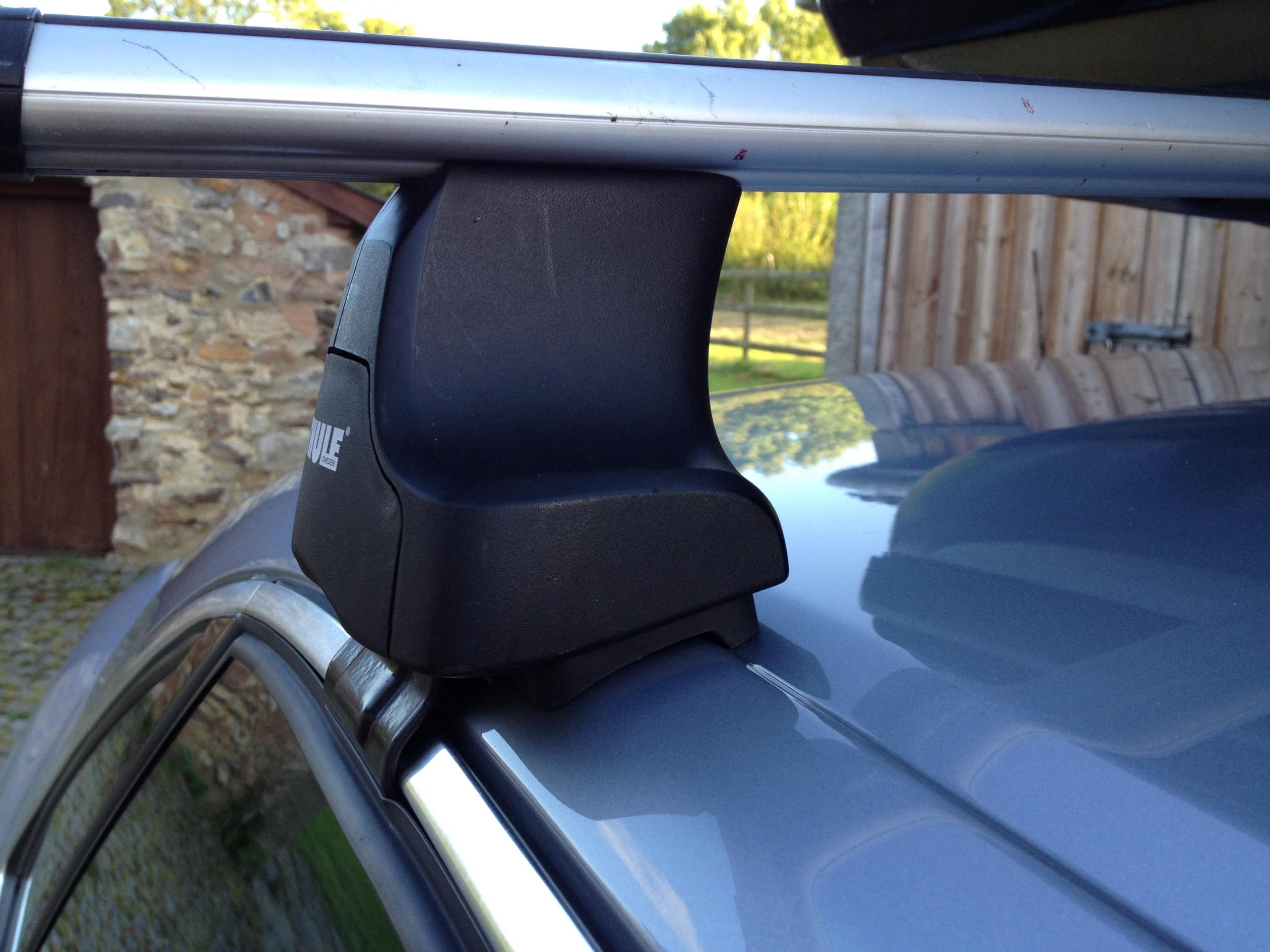

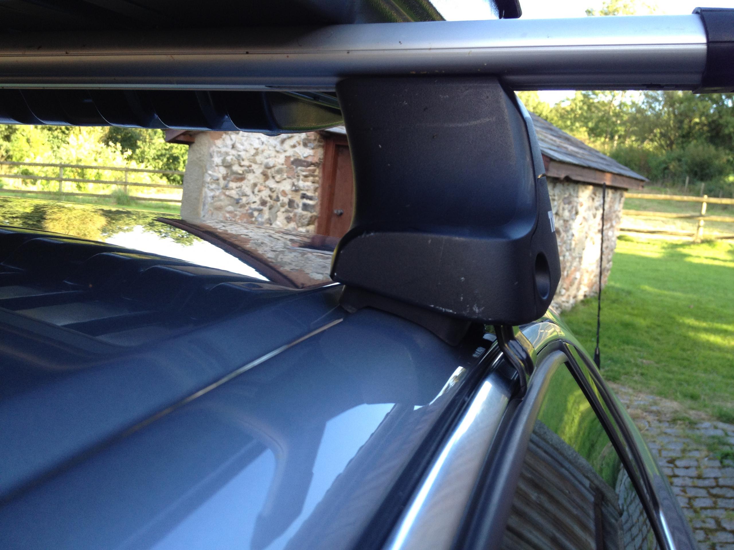

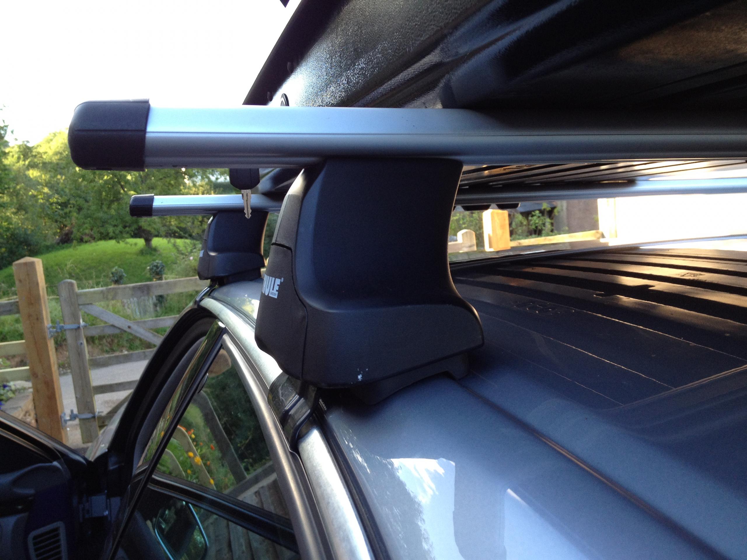

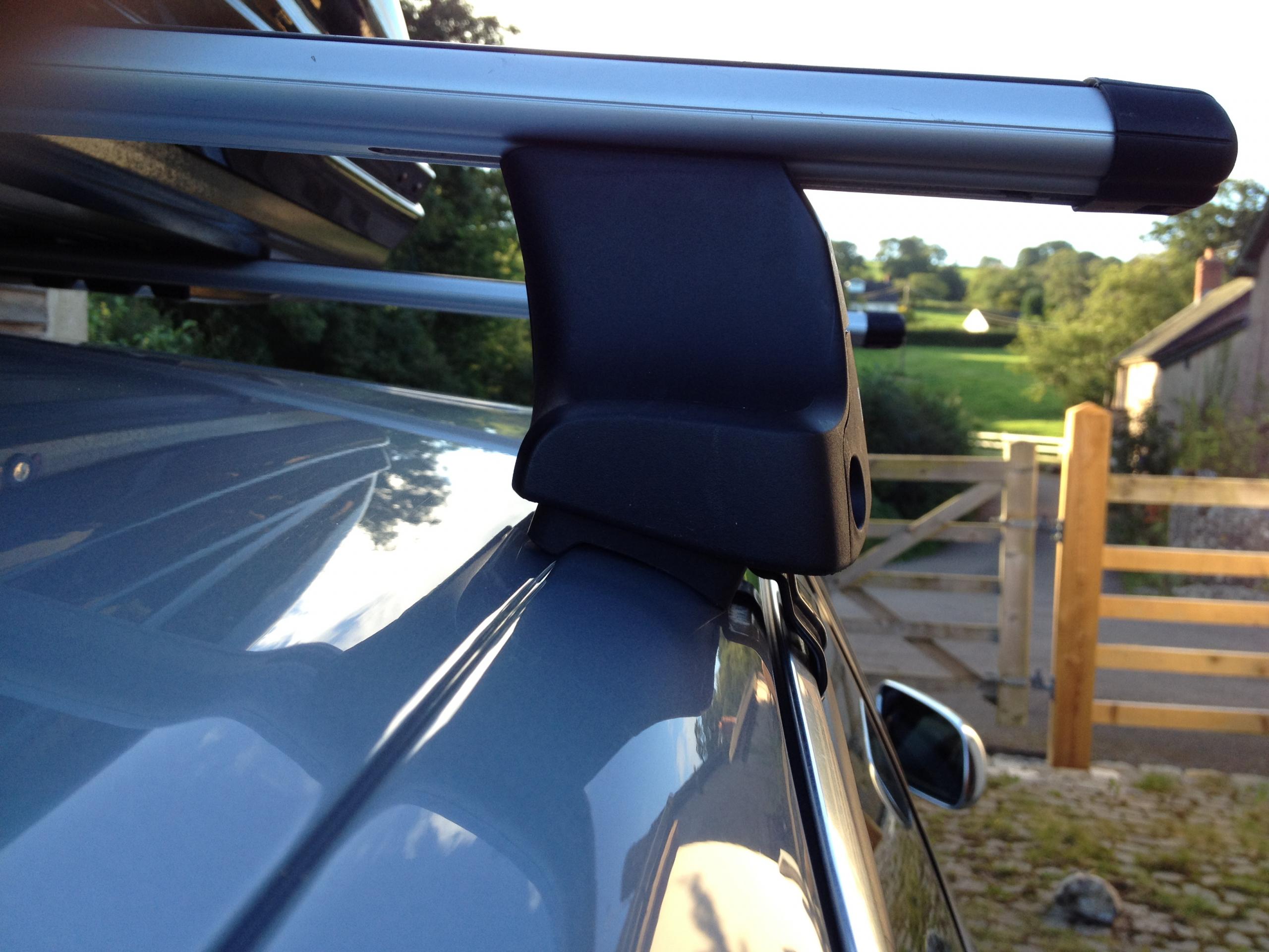

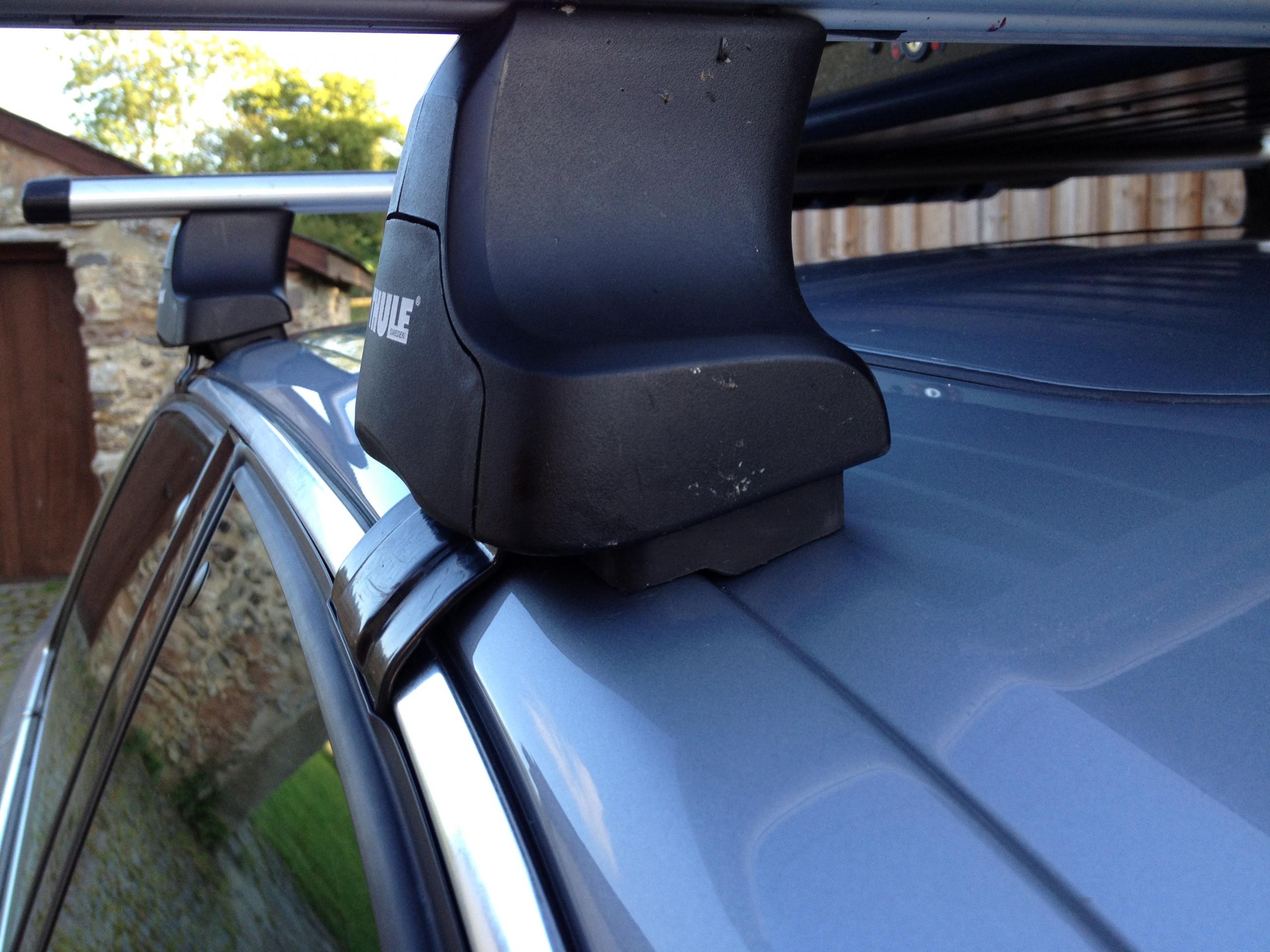

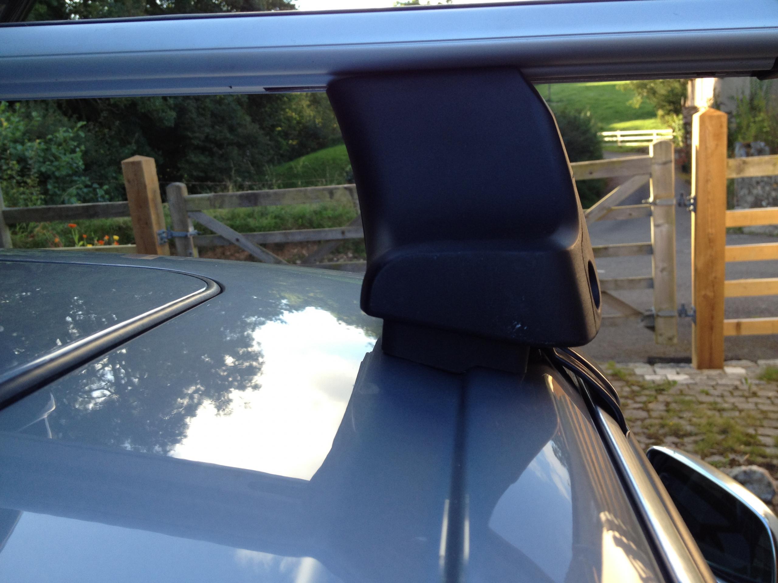

Pics of Thule option fitted attached
They also come with the torque limiting screws to make sure you don't over tighten them.
I've used mine a couple of times and left no marks of any kind on the roof

Fitting tip for you, if you haven't done it already! Don't take too much notice about the measurements in the instructions - set them evenly both sides as a rough guide and then spend the time making sure the feet sit in the groove on the roof as snugly as they can. Do the clamps up a little each side at a time or you find the bar is pulled towards you. It will squeeze the chrome trim a little bit but it relaxes again when you take the bars off.
