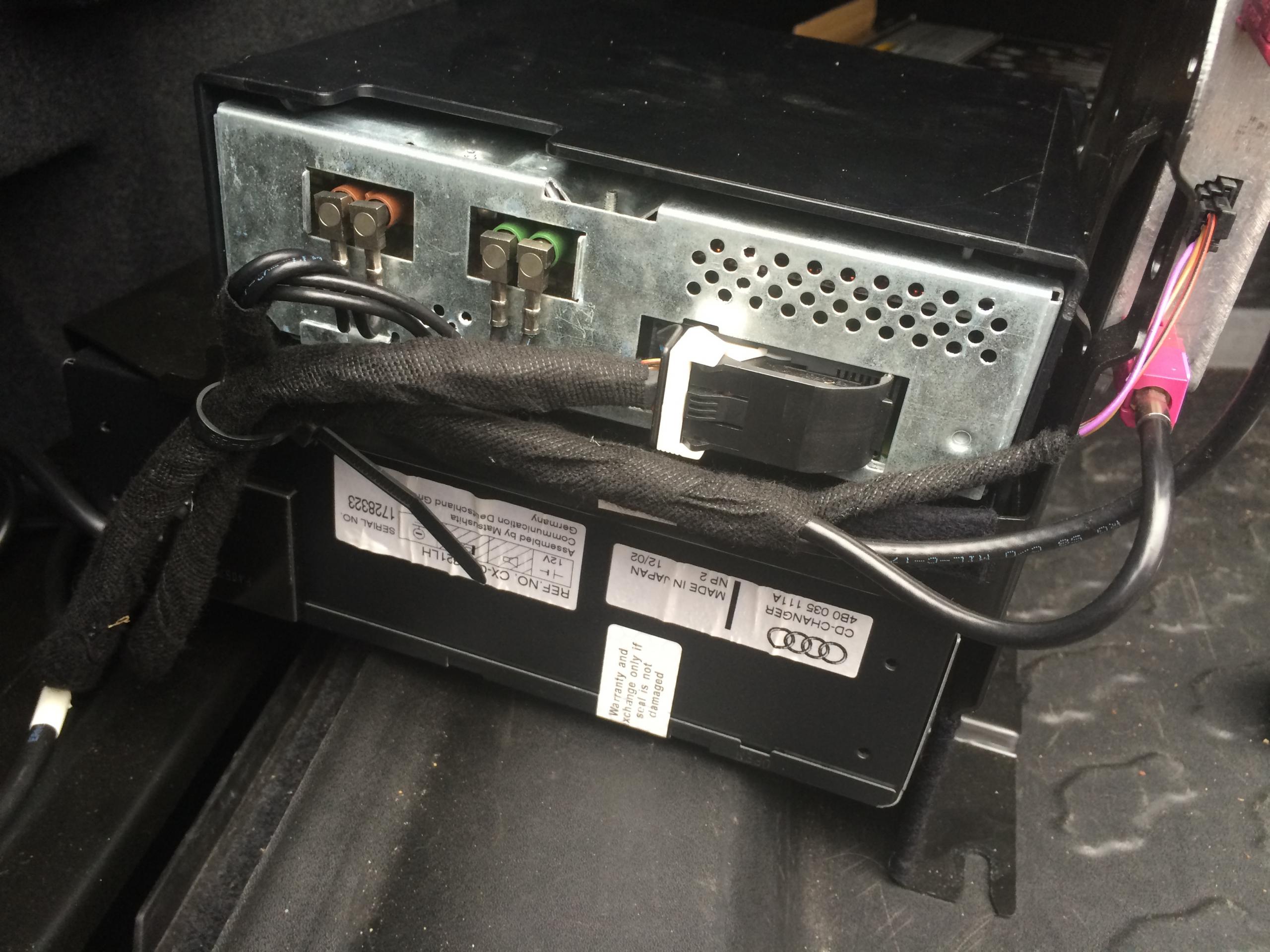

Relatively straightforward to get the old one out and all the wiring that was done when RNS-E was installed in mine seems to be of a high standard - no dodgy taped connectors or spare wires hanging out of anything!

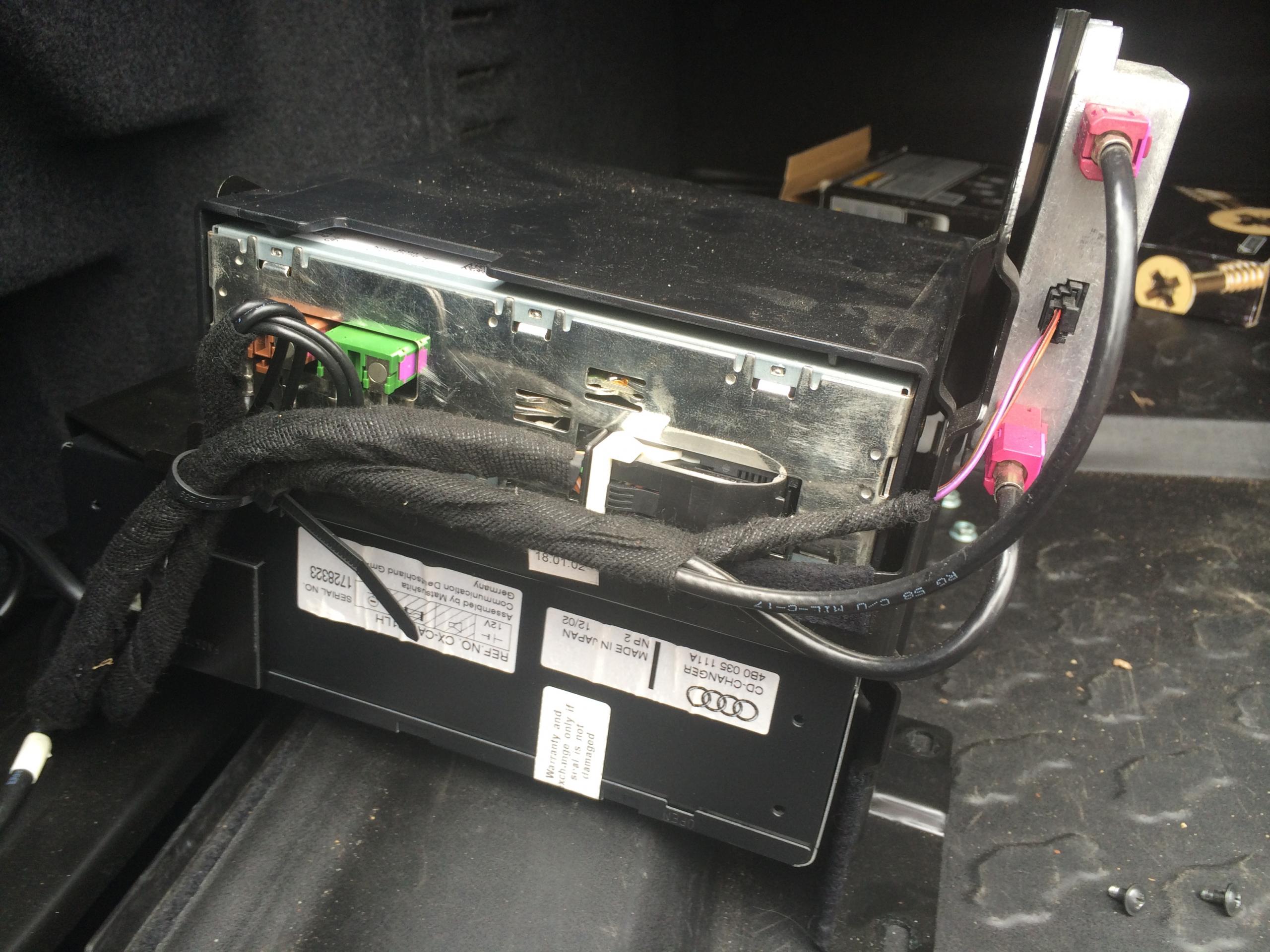

Only difficulty, which I think Ian has referenced in the past, was that the 2x2 antenna plugs are spaced differently between the analogue and hybrid tuners. I've managed to take the old plugs apart and push fit the aerial connections but will need to see if I can acquire the correct plastic holders to make sure they don't pop out over time.
'old' analogue RNS-E wiring

New hybrid tuner in place
http://forum.a8parts.co.uk/attachmen...1&d=1396709333

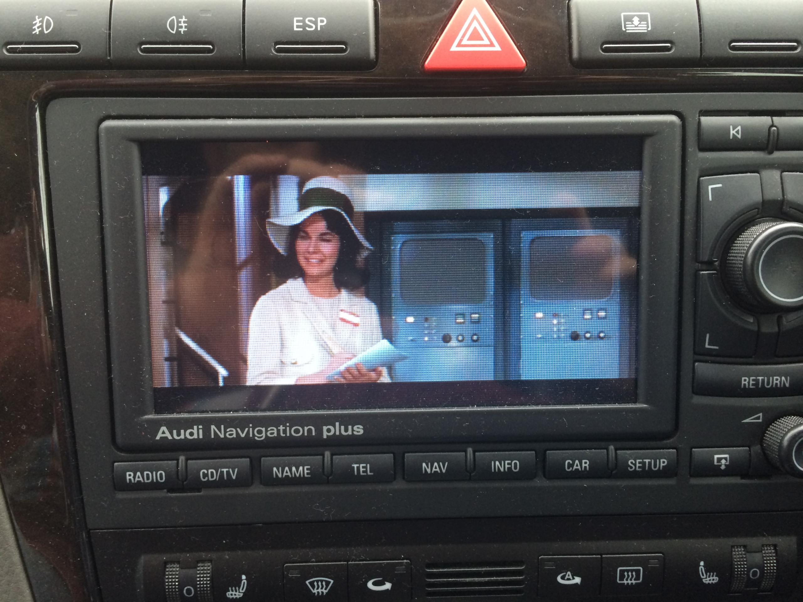

It even works!

Are the aerials some sort of Fakra connector? Unlikely to come adrift as they are TBH, but dare I suggest a strip of duct tape?
Hiya
I assumed the outer part of the aerial would just be an earth, if anything, so it shouldn't hurt if they come into contact since they're not carrying current? I did mess about with my fingers behind the unit in situ and touching the connectors together appeared to have no influence on reception!
I've e-mailed the people I bought the box off to see if they can strip the plugs off the loom of the RS6 it came out of so will see what they say on Monday before I try and figure out if Audi can supply the correct plugs. Interestingly my 2 TV boxes were made within a month of each other in 2008! So this must've been a retrofit in any case as they'd long since stopped building C5s when this tv box was assembled.
So annoying that they're different for no apparent reason.
Took me a while to figure out how to use the new box - it's not intuitive compared to the old analogue one - you use the big knob to bring up the channel listing, whereas going through the menu options brings up a full EPG!

Adrian,
Here is thread how to resolve connectors problem properly:
http://audiforum.us/threads/tv-tuner...nnectors.14750
To fix this problem you need two connectors p/n 4E0 035 672 K
They will cost pennies.

Thanks Sergey
£3.19 each according to Etka - if the place I bought the tuner from can't supply the ones from the car it came out of I'll get those ordered in the week. I figured they'd be a pretty generic part.
