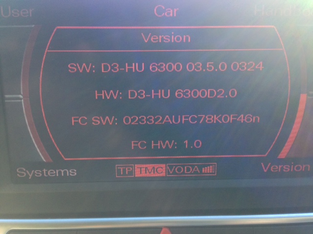

Attached to this post is a photo of the current MMI version, I have no idea how old this is or even what the version number is.

Quick google reveals this version is to old to upgrade directly to CD1.
I need to source version 1110 and go to that first.
