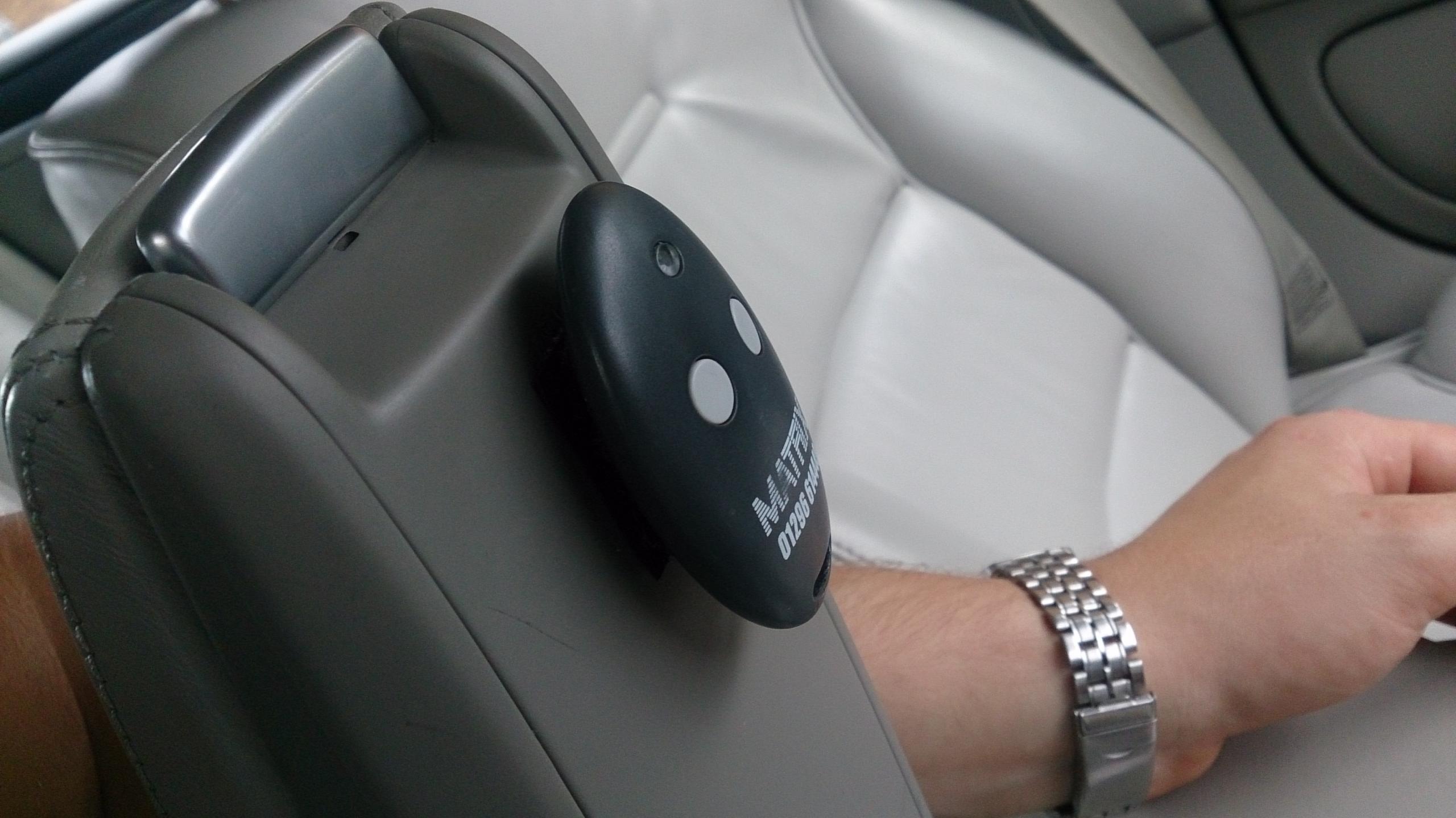

I've done just a very quick research, but stopped after seeing the cost going into hundreds of pounds. One thing I remember is that your garage door/automatic gate receiver must be compatible with Audi's equipment and even if my BFT Gates are, they still need a special module which costs another few hundreds, so I end up sticking a remote on hook and loop discs under drivers armrest and it works like a dream, can't see it, but it's there and it does the job very well

Old 24th June 2014, 07:08 PM
My solution

BFT is one of the top 3 (order of who is 1st and who is 2nd depends on personal preference and experience) gates/garage door automation manufacturers. Hence they gear isn't always cheap.
I'm sure you can cheaply hack it, but my idea is way much simpler and quicker, no control units, wiring etc.
What you do is buy the interior light unit with home link button.
Take all the internals from your remote. Fit them behind the light unit, even a hot glue will do. De-solder open/close button (my gates you open and close with one same button)
Take some wires and solder the home link button to the remote's pcb using these wires and that's it.
Simples
