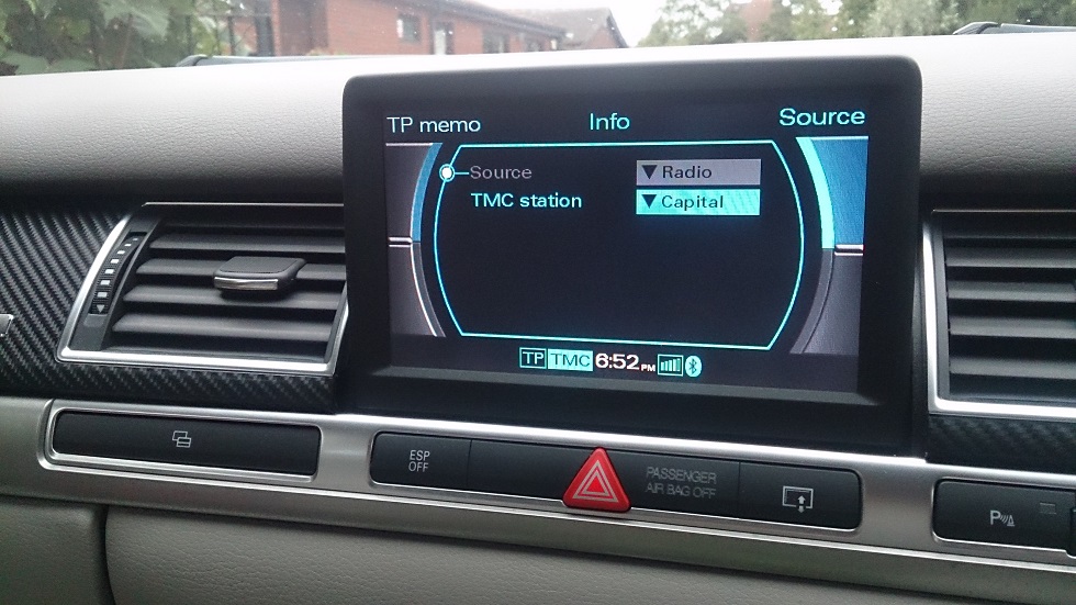

Is it me, or has there been a recent reduction in the TMC traffic mesaging data service?
I am finding the TMC symbol on the MMI screen is crossed out more often that not and when I go to INFO>SOURCE there is hardly ever any station listed. It used to always have Classic FM, but now just has Capital - and only now and again.
I am wondering if the service is being deprecated?

Thanks chap. The number is the DAB signal strength. It can be between 0-7 and sometimes has an R next to it. e.g. [3-R] No idea what the R means.
The symbol is activated in the green hidden menu, but no idea where, I found it when messing about a couple of years ago.

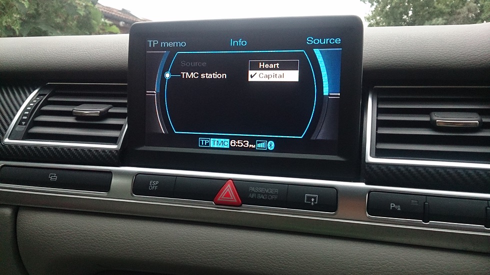

So, right now I've got Heart and Capital, but Capital is available only if I listen Capital FM, other wise on any other station Heart is selected.

Old 30th August 2014, 06:09 PM
Posts: 1,669
Thanks M8 - at it must just be weak Capital signal around here and there is no Heart radio in Notts.
Old 30th August 2014, 06:13 PM
No problemo Dragon
I went through top 10 station which had good reception and only Heart and Capital was available.

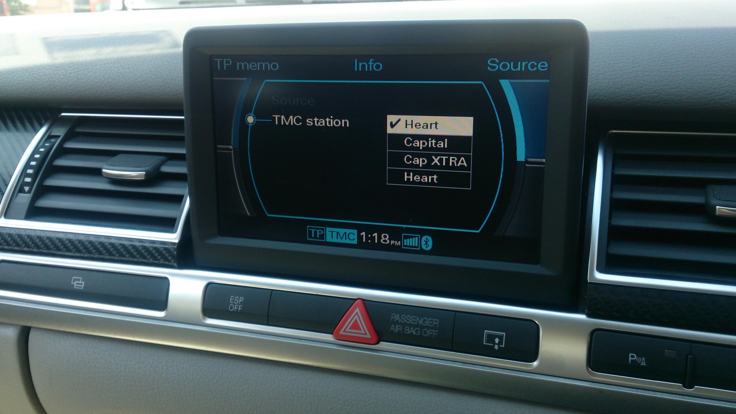

Old 10th September 2014, 12:42 PM
Capital Extra came up yesterday as well, and Heart twice for some reason
