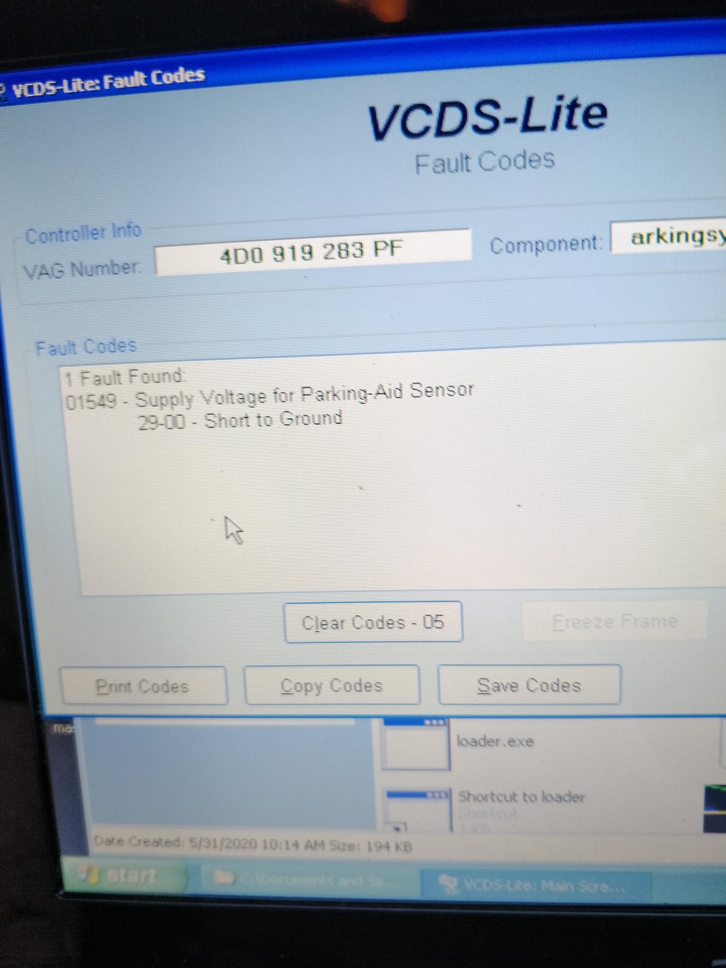

I've had numerous issues with PDC in my A8.
I've replaced all front and all rear sensors, front ones still don't seem to work but they stopped throwing codes, i think maybe the speaker for the front ones may have gone?
With the rear ones I'm getting one code:
01549 Supply Voltage for Parking-Aid Sensor 29-00 Short To ground.
Could this be a wiring fault or maybe the PDC module in boot can be faulty?

Hmmm, ill be trying this next:
"One faulty sensor can cause this DTC and drop the Sensor Voltage Supply MVB reading. Unplugging the front -or- rear wiring harness to eliminate 4 sensors at a time is advised during the diagnosis. Make sure to cycle the ignition off and back on before evaluating the MVBs. After the front -or- rear of the vehicle are determined to be problematic it is recommended to unplug the senors one at a time to see which one crashes the Sensor Voltage Supply MVB reading."

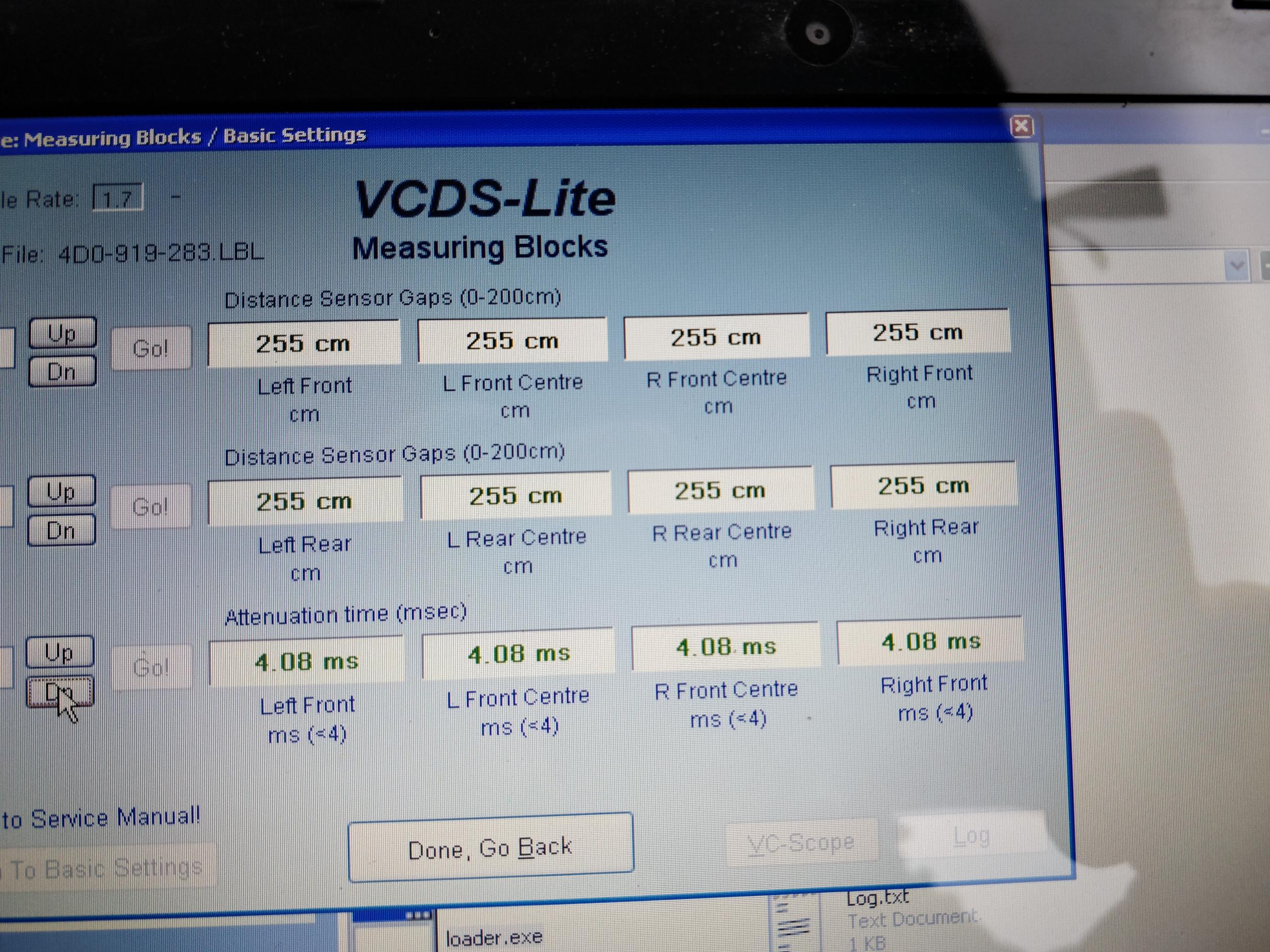

OK, so with one of the plugs unplugged as in attached pic, I'm getting:
01543 Parking Aid Warning Chime h15
01625 - front parking aid warning chume h22
I can't tell whether the plug I took out is for front or back, but if i remove the other one and plug in the one i took out, vcds can't communicate with the module.
I've also read the measuring blocks for front and rear sensors and they all seem fine?
