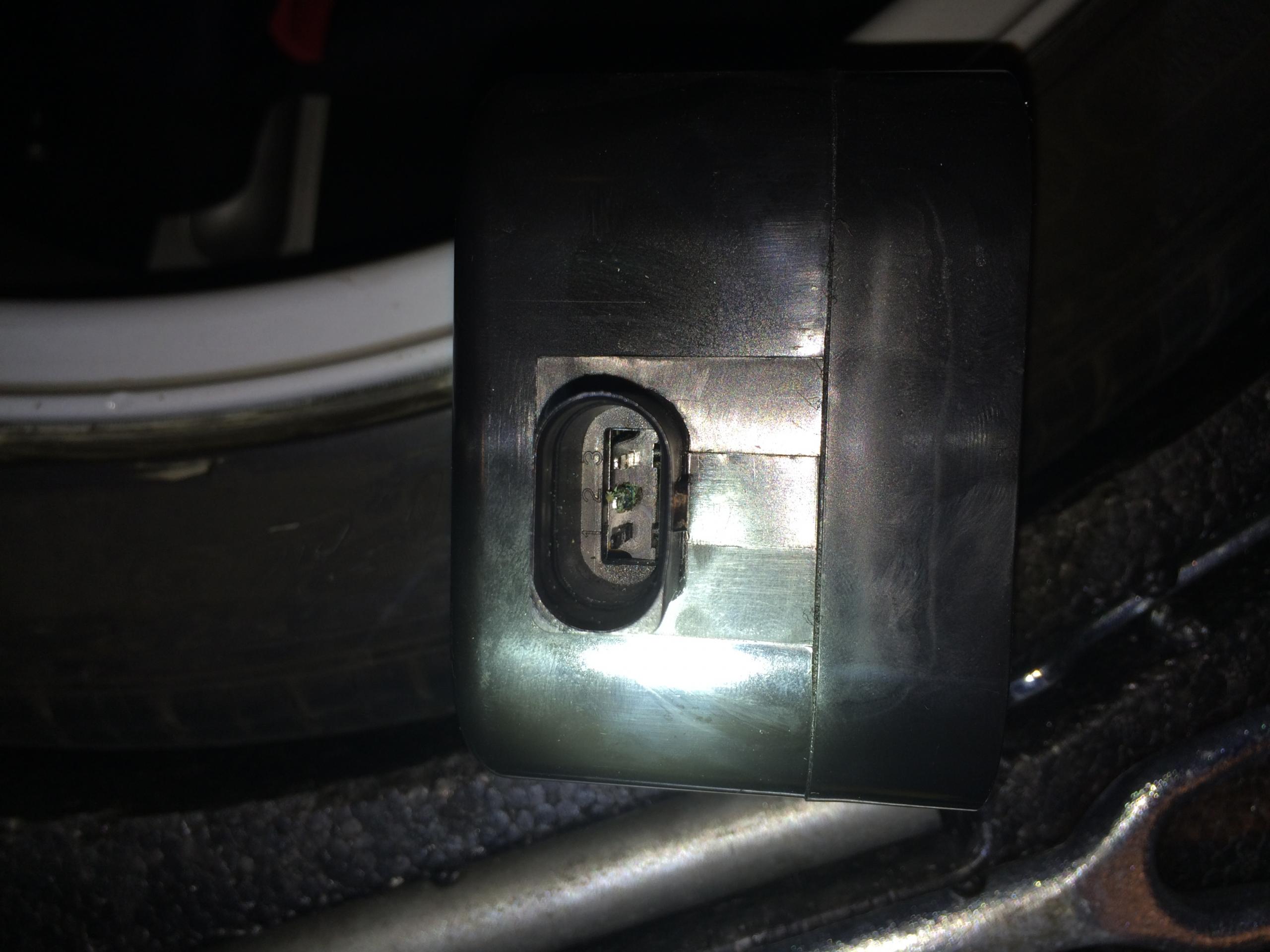

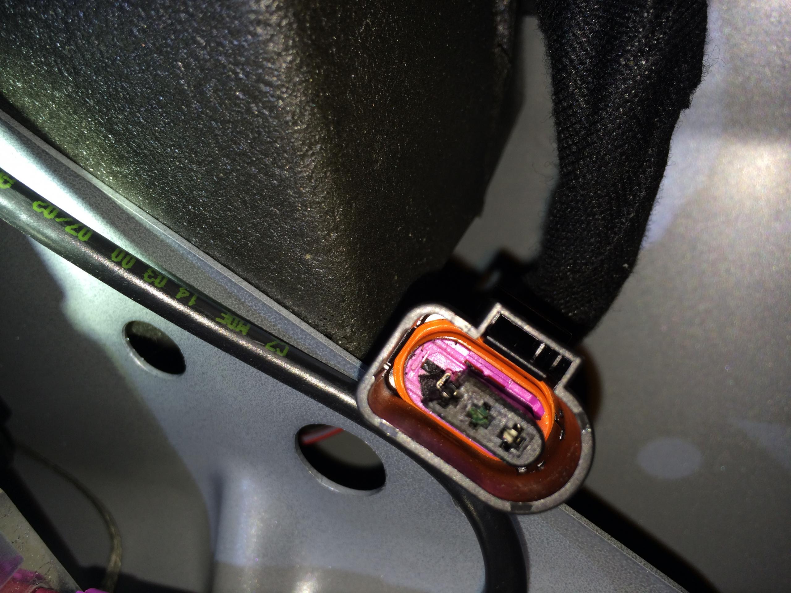

This is the state externally of my alarm module and the wrecked plug
Looked online and it appears the plastic part of the case can be dismantled, so if I can grab one from TPS this morning I should be able to clean up the contact with spray cleaner, assuming I can get it out with the barbs intact!
I'm usually OK at doing stuff like this, but the limited access will certainly make it interesting....

Mine and Brian's were both like that. I managed to repair mine, but Brian's started to go off in the middle of the night. I got a couple of plugs and a longer length of wire from A8 Parts, so I plan to cut off the old plug and 'scotchlock' the new one on. I really doubt if there's room to fit a new plug and I haven't tried to get the side panel off.
