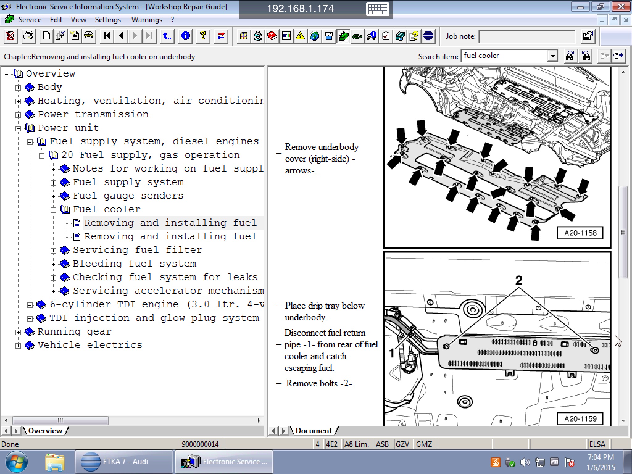

Accordimg to ELSA the fuel cooler is under the undertray, so wouldnt expect it to be picked up in an MOT. Maybe they meant the intercooler?

I've seen that and I thought it was the cooler but was not 100% sure.
Thanks for confirming it.
It looked ok when I glanced at it. I'll take a better look when I got the car in the air.
I think its a metal cover, so that could have been bent/dented. Hopefully they are talking about the metal cover not the cooler it self.
I had a list of under tray advisories cause they can't remove them, that annoyed me.
