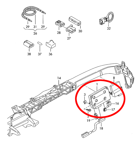

Certainly try to recode with VCDS first, but if the MMI interface box needs to be replaced it's a relatively simple task. The module is behind the passenger glove box next to the CAN gateway. There are many used units from A8parts and I think component protection will need to be removed.

Yes replacement is relatively simple, just behind the glove box, you can also look for a tutorial for it if you want.
