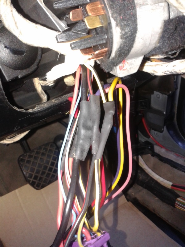

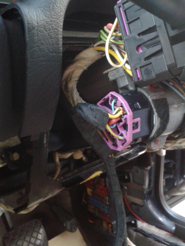

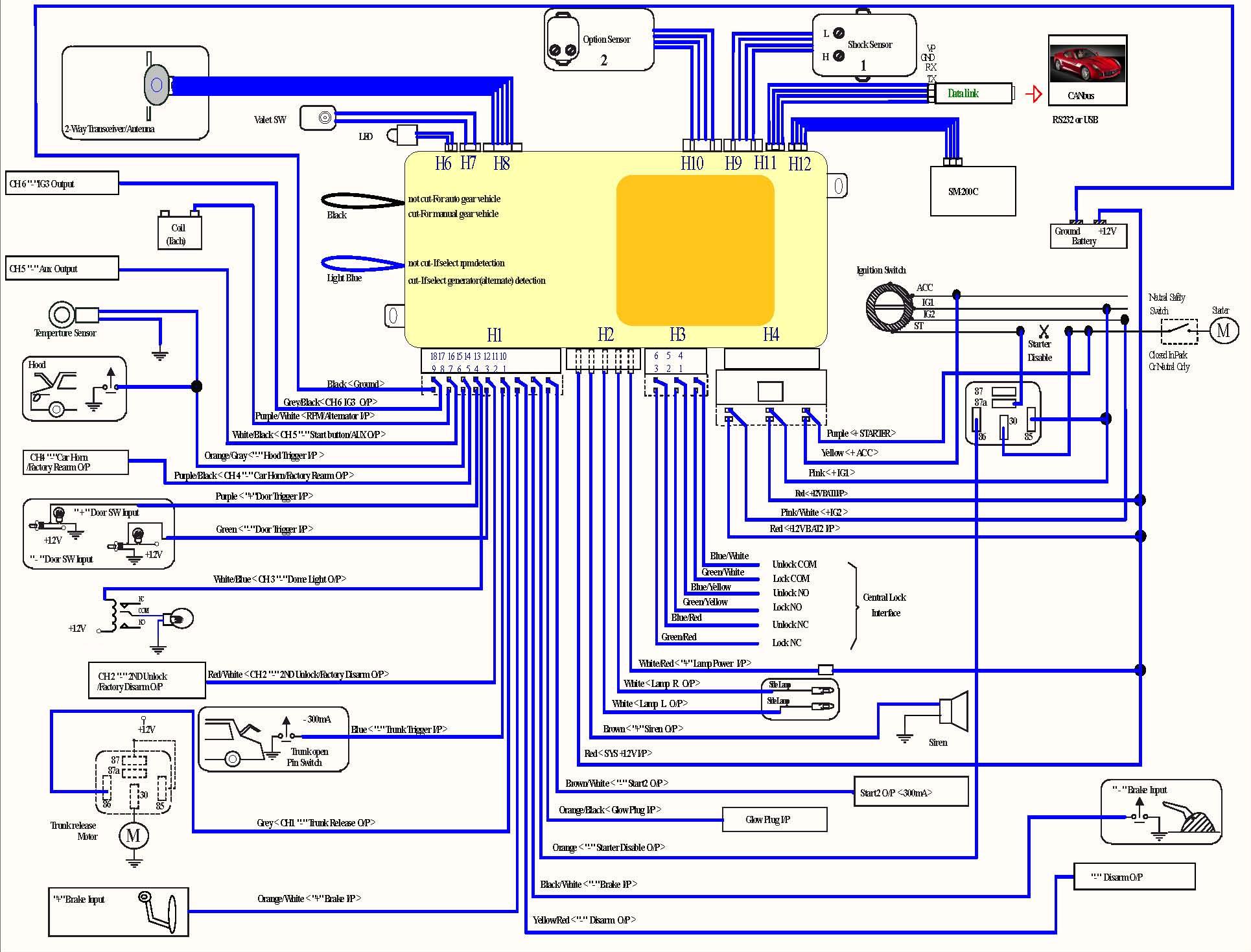

Anyway I have made a start now. I will start with Remote start H4 plug. First I removed pink/white wire from the plug for IGN2 as it is not used on D2. I then connected remaining wires to the wires going to ignition switch. These were cut, soldered, isolated with heatshrink and then wrapped together with a fabric tape.
2 red +12V wires from alarm go to the 2 red +12V wires at the ignition switch
Purple starter wire goes to black/red cable at the switch
Yellow ACC to yellow/black ACC wire
Pink ignition to black at the switch.
Name:	wiring diagram.jpg

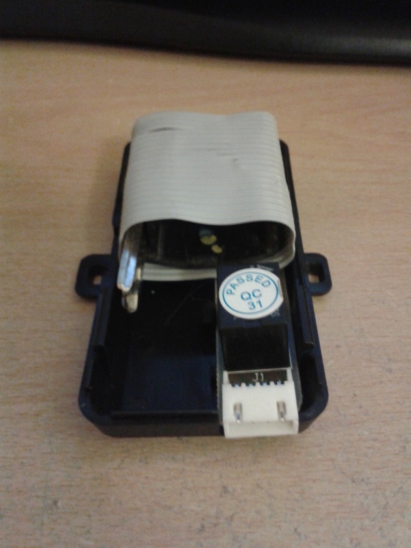

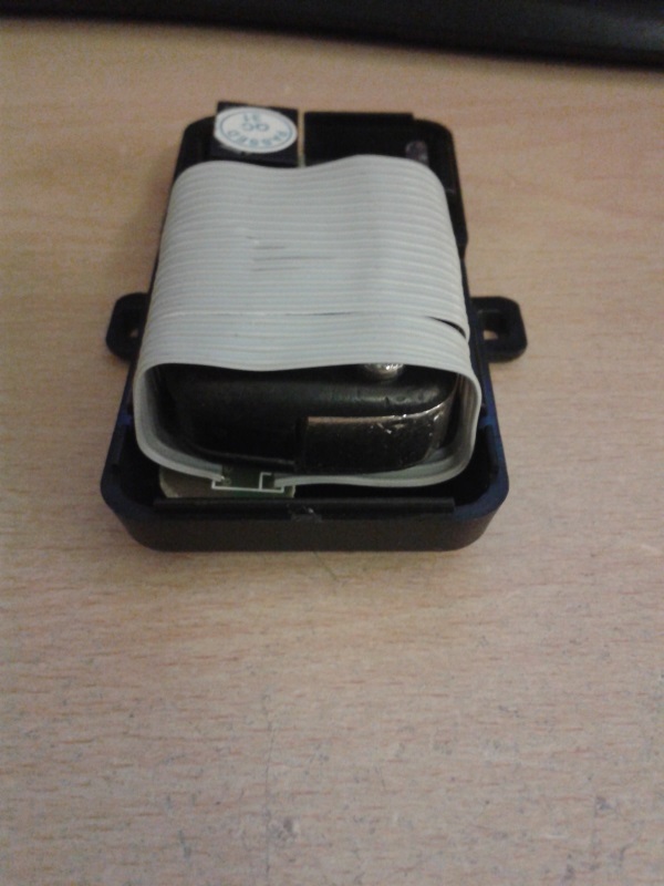

For immobilizer bypass I will be using one of these: http://www.ebay.co.uk/itm/TRANSPONDE...item2c709b4168

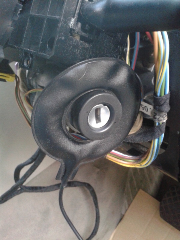

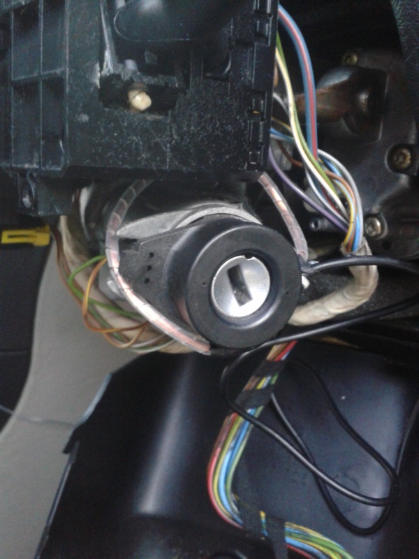

You put spare key or transponder into it and place the coil ring around the ignition lock, connect red wire to permanent +12V and black wire goes to alarm plug H1 pin 18. When the remote start is initialized alarm connects pin H1/18 to ground and completes the circuit. Bypass module then sends and receives signals from spare key/transponder to the immobilizer coil at ignition switch and deactivates immobilizer. On all other circumstances when remote start is not active bypass module does not work and you still need authorized key in ignition.
The ring was too bulky to fit in location so I removed outer plastic to put it in place
The unit I have bought in the link above is actually to small and cannot be closed when key is inserted and I actually ripped some of the wires off PCB which will need to be resoldered while test fitting key even without remote control part.

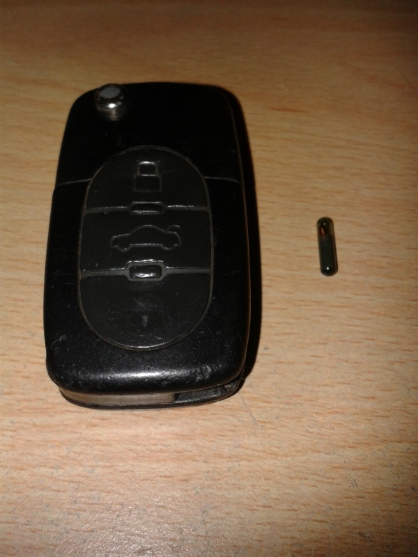

I will be hopefully using transponder itself without a key a the end. I have bough some Megamos ID48 transponders on e-bay http://www.ebay.co.uk/itm/New-Virgin...item27ca303c8f And I have coded one for use with A6 but cannot get login and code keys with my current tools For S8 but I have found a tool that seller claims will read login on S8 as well so hopefully I will be able to code spare transponder. Failing that it wll be trip to dealers to get it coded.
Here is the picture of transponder next to key to give some idea of size
