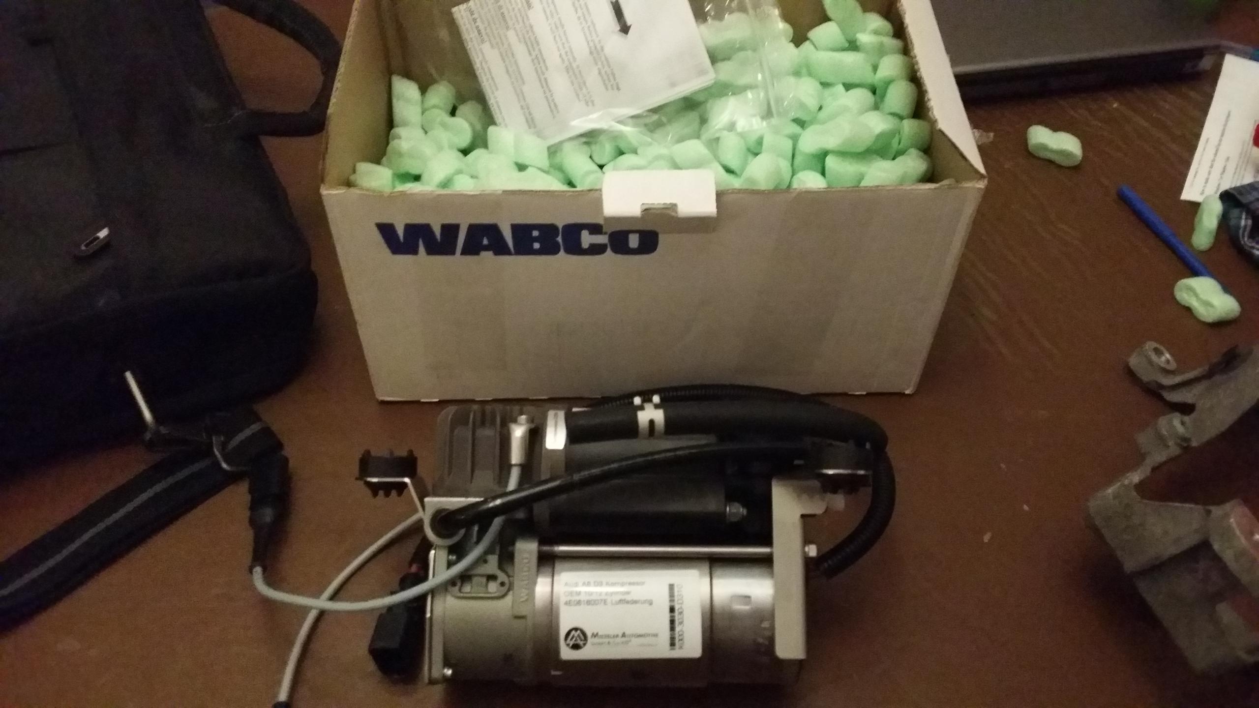

Guess what im doing tomorow morning

My A8 originally had a bump on the passenger front corner , I had to replace the compressor cage as it had been damaged.OoOn closer inspection the other day I noticed theres a crack the input connector and it looks like the output thread has been cross threaded as theres thread lock round the brass cconnector.on seeing this I thought it would be best to replace it.
I ended up buying the compressor from airsuspension.eu on ebay. £297 with 2 years warranty.ordered it on sunday and it arrived today.
Will be fitting tomorrow morning so will let you know how it goes.

Ahh that will explain the loss of pressure then.
Good luck with the new one.
