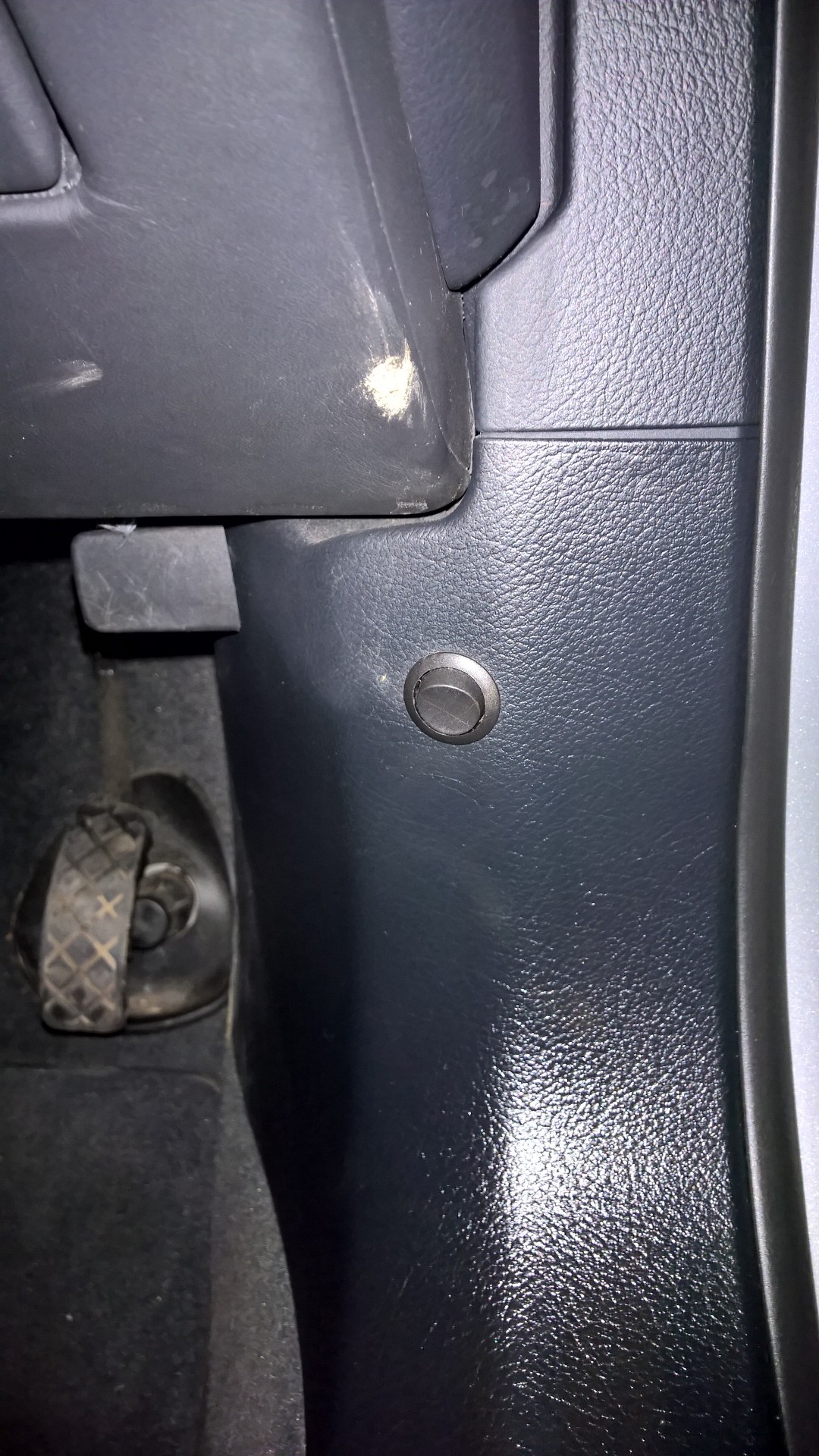

Hello all. I've had my S8 a couple of weeks now. One of the first things I noticed about it was this curious little switch. It doesn't seem to do anything at all, and I've toggled it back and forth a few times over the past couple of weeks, hoping to notice a difference. The only difference I have noticed is that in the down position, I get a more bumpy ride feeling from the back end.
Then last night, driving home on the M60 in heavy fog, I tried to use the fog lights. The fronts worked fine, but the rears did not engage, and interestingly, the light on the dash did not come on. That got me to thinking that maybe the switch is related to an aftermarket towbar.
I looked under the back of the car this morning, and can't see any evidence of a towbar prep. Toggling the switch doesn't affect the fog lamps, so now I have no idea what is going on. It can't be bulbs, because I'd expect a bulb warning, and the dash light to still come on.
If anyone has any suggestions or thoughts, I'd really appreciate it. Thanks!

Not OEM for sure.

Yeah, it does stand out glaringly, but I have no idea what it does. Any thoughts on the fog lamp problem?
