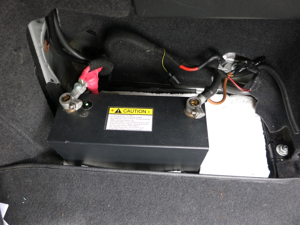

Some Porsches already get LiFePo4 starter batteries as standard.
In my opinion LiFePo4 with a battery management circuit is much more suited as a starter battery than any previous battery technologies. After all a starter motor is almost like a mini EV motor, it draws a large current to drive a heavy load. I don't see any EVs going back to Lead acid (be it AGM or not), NiCd or NiMh.
With a low voltage cut-off circuit it should theoretically never be damaged by over discharging.
If the cell management circuit lasts, once you pay the first-time higher cost of a battery with a management circuit, when the cells eventually become useless you can replace just the cells with another set of cells for probably around the same price as a Lead Acid starter battery. I think I saw A123 Systems 20Ah prismatic cells for £25 each, and you only need 4 cells. These are good quality cells not the cheap stuff.
Here's mine, around 30Ah, installed in December I think, so far I'm very happy with it. It hasn't gone into low-voltage cutoff yet even sitting for 7 days. The car really likes the higher voltage of the battery, much nicer starting. I just need to install a proper bracket to hold it down, I'm risking stressing the cables at the moment. The smaller cables taped off, in the background, are the remenants of windscreen heating, I haven't got round to removing them completely.
I bought it from the States, no problem air-shipping at that time, but laws may have changed now.

Interesting Goran. How many volts is it? Does the voltage drop much when cranking? I find lead acid go down to ~11v when cranking.
Old 2nd June 2015, 10:06 AM
I'll check it next time when I start the car. I suspect it shouldn't drop too much if my experience with other Lithium batteries is anything to go by.
Normally it sits at around 13.2 to 13.3V when connected and boot open (so boot light on).
The 110Ah lead acid battery used to sit around 12.0 to 12.2V when I kept checking it, but it wasn't in good shape, even at only 2 years old!
Old 3rd June 2015, 09:32 PM
Here's a quick test. This battery also goes down to 11V briefly when cranking.
Depending on which source you believe 13.15V for 4 cells is around 50% to 60% state of charge. Probably equivalent to a Lead Acid battery at 12.2V to 12.25V
Not bad for a tiny 30Ah battery?
