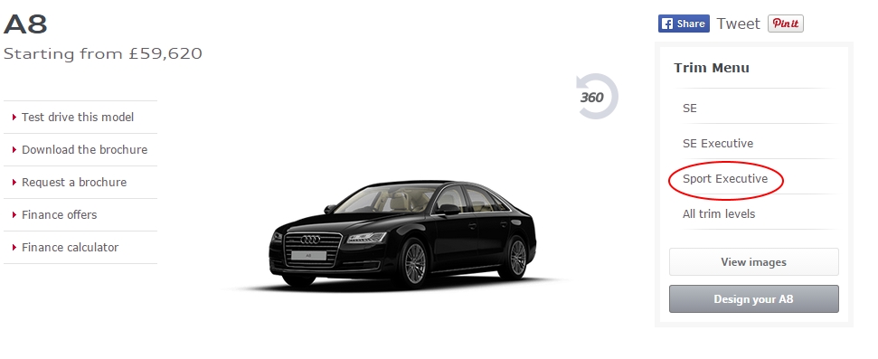

Old 24th April 2015, 09:10 PM
there is no listing for a sport model on the d4 chassis

Old 24th April 2015, 11:33 PM
nath nath is offline
Join Date: Nov 2014
Posts: 107
here is the link to the 2010 price and specification list
https://www.audi.co.uk/content/dam/a...20Jan%2010.pdf
as you will see there is no sport vehicle listed
simply
se
se executive
obviously been one released since
Old 25th April 2015, 05:10 AM
simply
se
se executive
That's correct there was only 2 specs available on release
